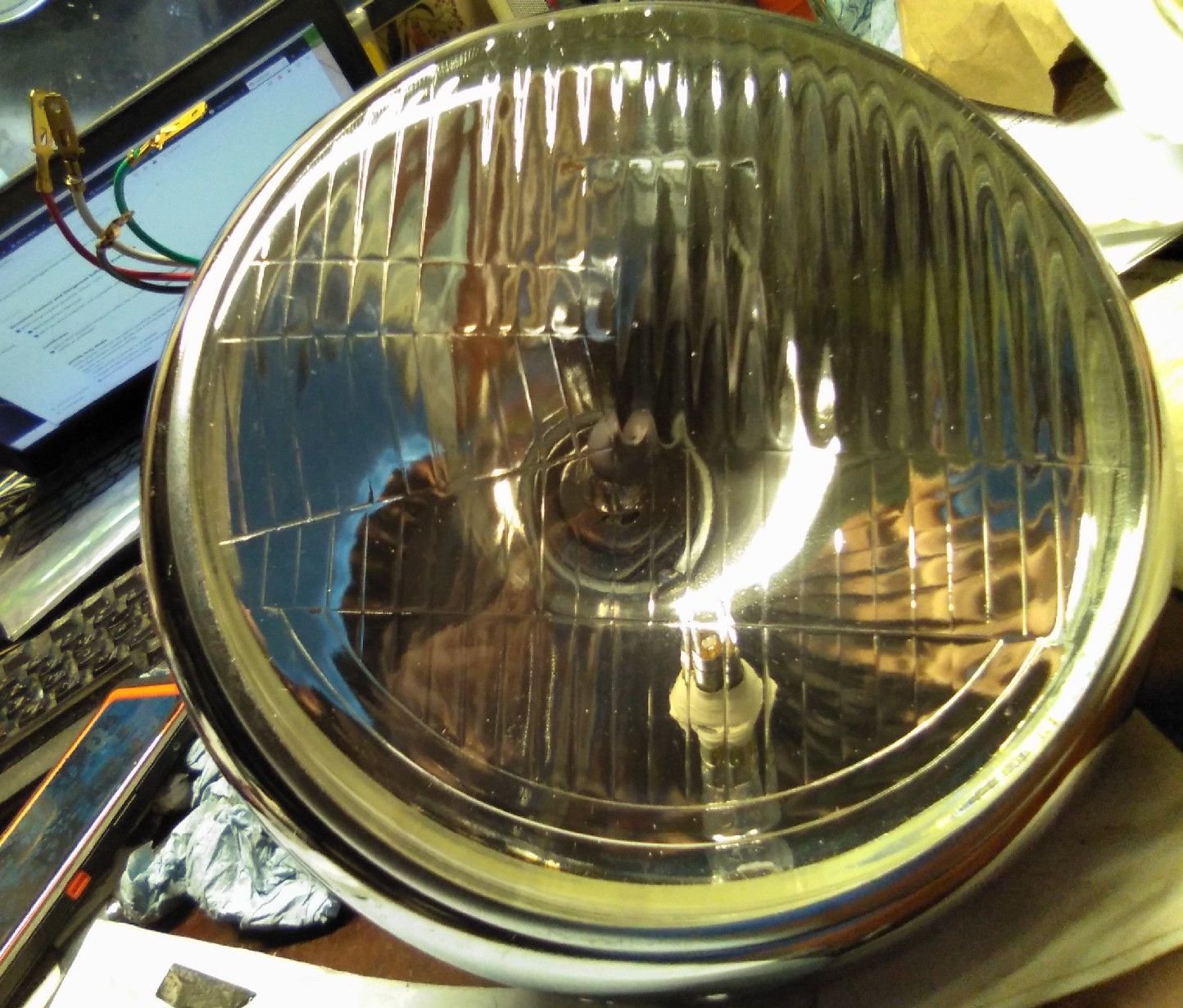

Hello all:
I just uploaded a video about a brand new pair of headlight assemblies I bought for my rusty MKII saloon. I purchased these from an indian seller on Walmart.com so I was unsure if they were going to be any good.

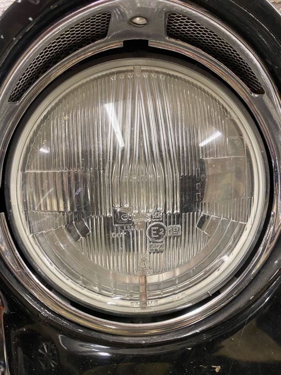

Default Is this headlamp bulb RHD or LHD?
Can anyone tell from looking at this photo if the cut in the lens of these bulbs are LHD or RHD ?

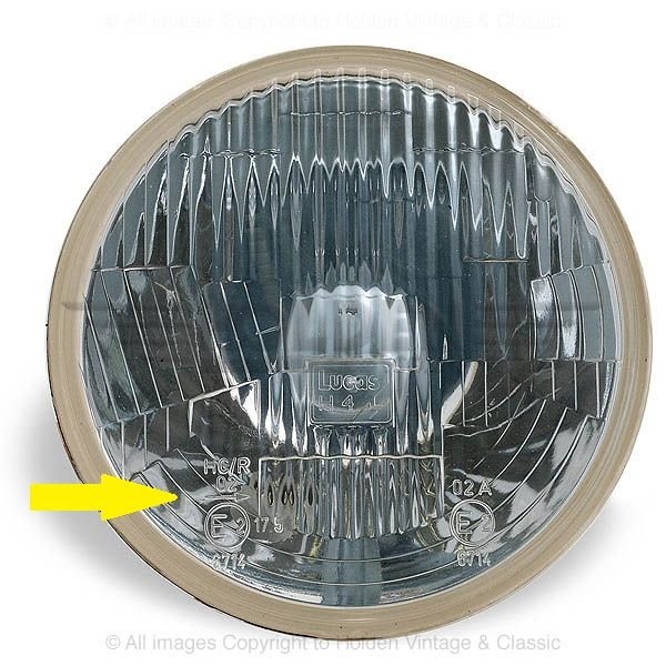

A specialist may but good lights are clearly marked. See arrow on glass. Dip left. Fire them up and align main beam. Then go to dip & witness which side they dip to. (What I have in my car ~ originally sealed beams with round centre Lucas logo but like candles)

I think it's important to make a distinction between drive side and traffic side. Lights are distinguished by traffic side. For example, in the UK most cars are RHD however, they have Left Hand Traffic, i.e they drive on the left side of the road. The side of the car that the steering wheel is on is irrelevant to the required dip for the traffic side. In Japan for instance it is possible to buy some cars (mainly the European imports) in either LHD or RHD configurations, but the traffic is left hand traffic and the lights must conform to that.
My Cibié lights are not marked for direction of dip, as it appears the right hand traffic lights are not marked, but those for left hand traffic have the arrow. These are for right hand traffic.
Looking at the photo above, I would guess those lights are for left hand traffic, i.e UK, Australia etc. India is left hand traffic, so that makes sense.

Most often, the big triangular section of the lens refracts light away from that side. That would make your headlamps UK, Aus, India. The best way to be sure is apply 12 volts.
What I suspect are the same lamps are sold in the UK at a £100 or so. I don't know if they're legal here without the E mark. It's possible to buy all the parts separately, WIPAC halogen lights, bezels, rim, back bowl for less than £200.
