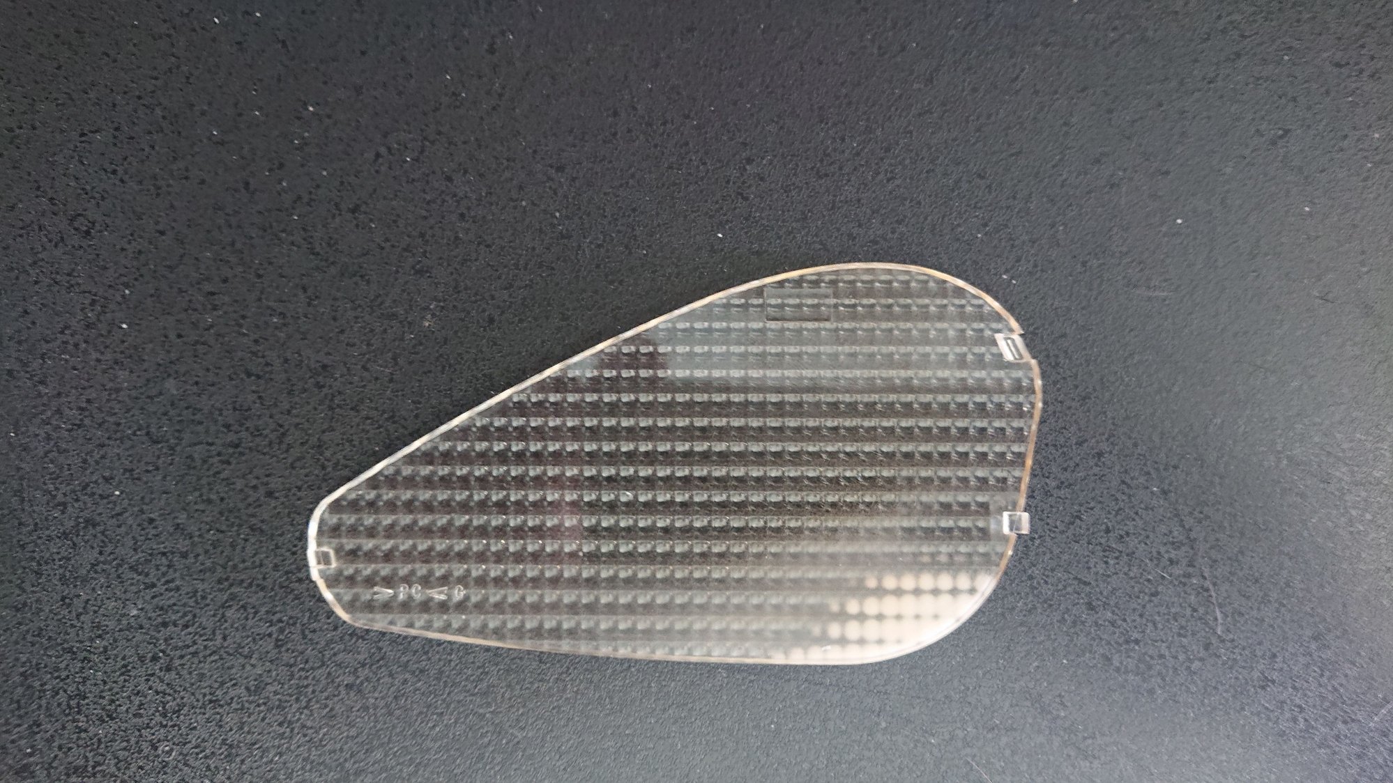

On a side note, does anyone know where I can find this internal turn signal cover or the part number? I didn't burn it in the oven but did burn it when I tried to remove the yellowing from it with a hot air gun.

Thank you for your considerate reply Dragstar. Just glad somebody was able to benfit from it. I have actually sorted out the plastic lense inside but thank you for your offer. They are like hen's teeth to find so if you put it on E-bay somebody might be looking for one. I made a new one from scratch because they are impossible to find so quite valuable in that regard.
