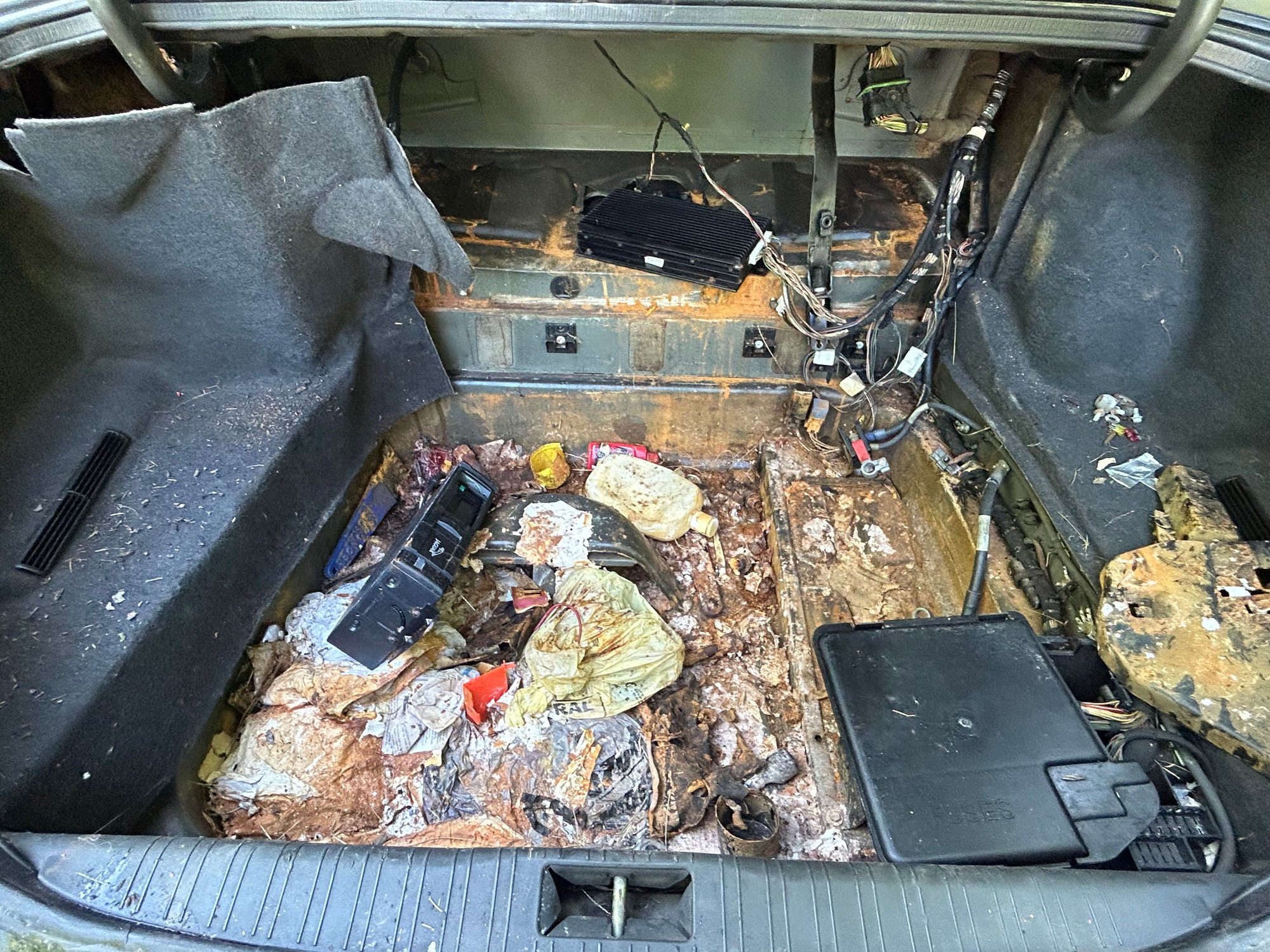

I have recently gotten this jag for 900 dollars I’m 14 about to turn 15 and this is going to be my first car I obviously see a lot of problems with the interior but at the moment I am more concerned with the inside the only issue the buyer said was wrong with it is that it does not have a fuel tank in it at the moment because the person he took it to to have some work done on it let it sit and water got into the tank but it’s been sitting here for 5-6 ish years and me and my dad haven’t gotten it to our house yet to really look and work on it he is a mechanic so I think we are gonna be in decent hands but still any observations or absolutely anything is welcome to help us get this up running and looking as beautiful as it can please help

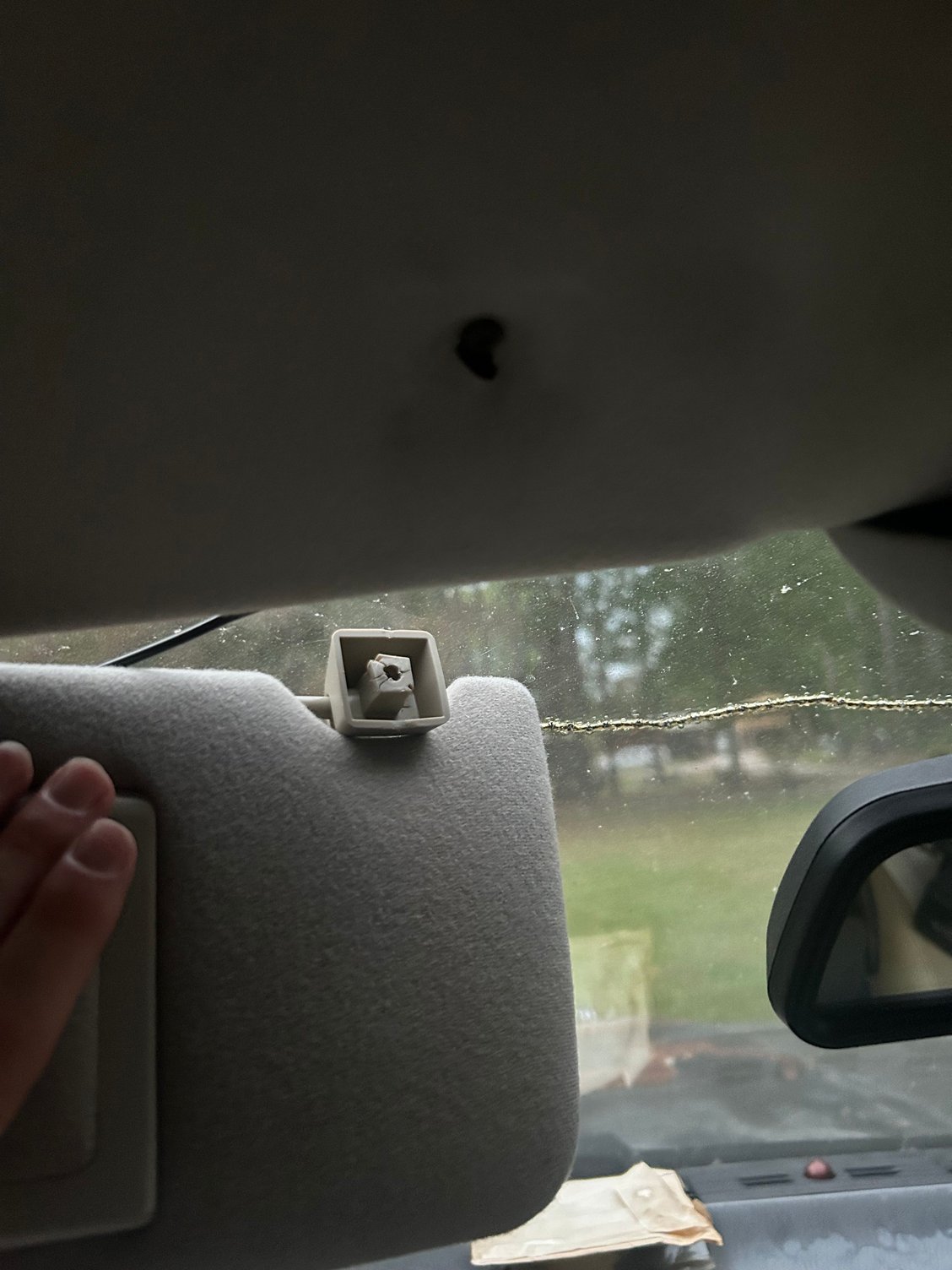

So you should probably just replace the visor clips that are broken. They are still available HOWEVER you will have to modify them so that they don't break again, which they will, if you just straight up rep[lace them.
1. Find small metal flat washers that fit the screws and the hole. The original install did not use a metal washer, and this is a design mistake.
2. Fill the insider cavity with 2-part liquid epoxy to strengthen the plastic visor structure. Once cured, along with the washer, will last you a lifetime. I've had mine for over 20 years without a failure.
Without these modifications, the new ones will not last very long.

Vee that is a great bit of information and a useful repair for all these cars! Pretty cheap DIY modification.

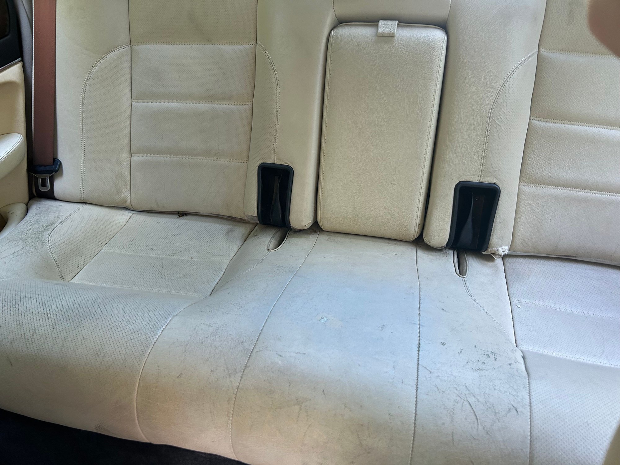

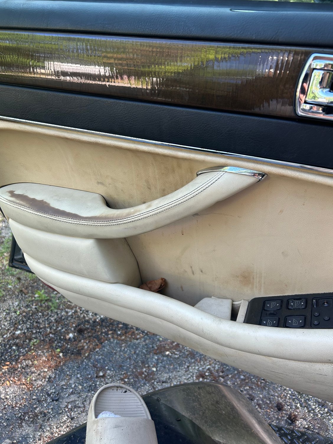

Me and my dad have finally gotten it to the house I jsut gave a good pressure wash, it’s looking much better already. We need a fuel tank does anyone know the model and one to buy if so could yall link where, I want to get advice on these seats, where everything goes in the trunk, and how to get these doors clean. How should I go about fixing the seats and everything else I mentioned?

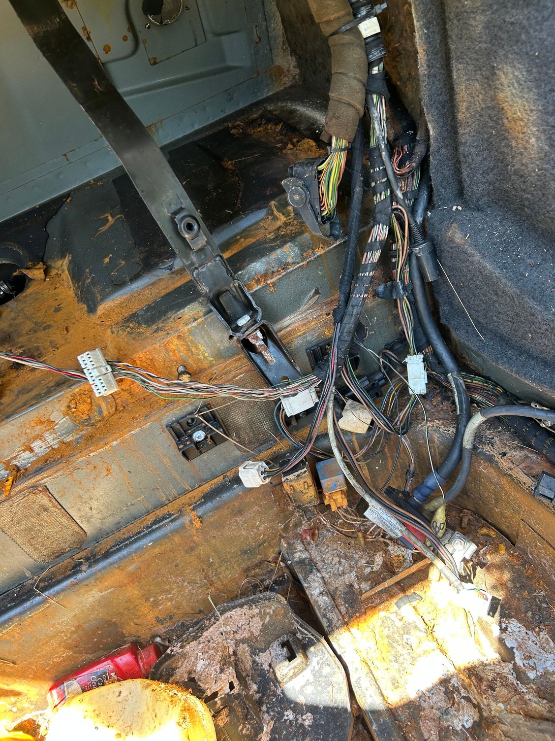

how can I bypass the fuel tank on my car which line would i need to hook into to get the fuel into the car

Diagrams in the JDHT link would show you the way.
I have an XJS with the non-supercharged engine, so you're going to have to check my math here.
The fuel pump is inside the tank, so you'll have to address that obstacle, but you'll have a supply AND return feed at the trunk. You will want to account for a lot of fuel coming back into the tank!
Depends how you're planning to feed the engine. You can tie into it from the back corner of the trunk. At the fuel filter, which may be by the driver's side wheel (which you will have to remove to access), or right before the fuel pressure regulator. Non-supercharged regulates intake to 43 psi. There's no easy way to tie into the system without creating some kind of pipe fitting assembly.
I would just start by getting a fuel tank for the car. www.car-part.com is probably where you want to look? Shipping a tank ain't gonna be simple, but I feel that where you have to start.
