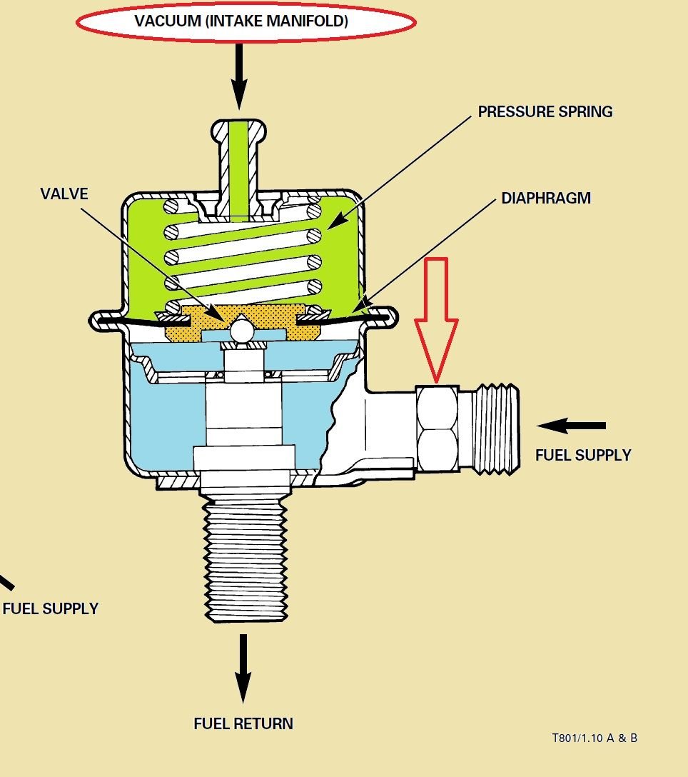

The fuel flow regulator is plumbed like this into your fuel " rail " fitting , remember to use 2 wrenches on the fitting if taken apart least twisting the fittings off , soak with penititrating spray a few days in advance , no hurry to twist them off
The fuel line from pump first enters the engine bay and hooks to rear fitting on the fuel rail , the front of the fuel rail hooks to the side fitting on the FPR , the bottom fitting returns to tank , in normal operation there will be some bypass through the FPR dumping access fuel pump made pressure , this will in fact stir the fuel
