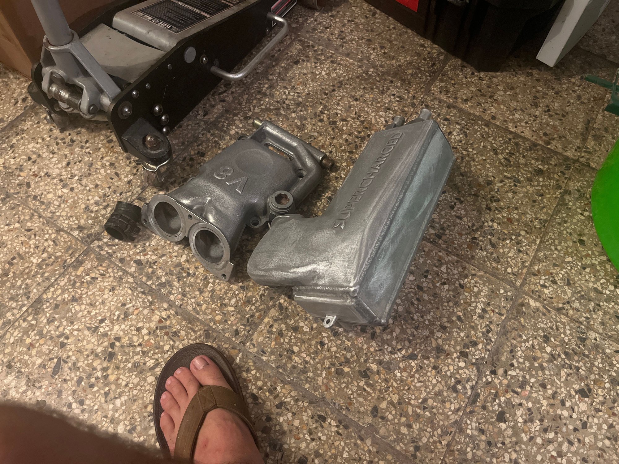

My car's exterior is platinum and my interior is charcoal. I have always hated the muted and dirty color of the charge coolers. I was thinking of painting them a darker red, and trying to keep the lettering polished aluminum, but I am open to suggestions. What color do you think would work best with my car?
Is it possible to paint with the charge coolers in situ, or is it recommended that I remove the charge coolers before painting? When prepping the parts for paint, at what grit should I start sanding and at what grit is it ready for engine enamel?
These pictures are where I'm at at the moment.
You can tell that I cleaned up the valley and one of the charge coolers.

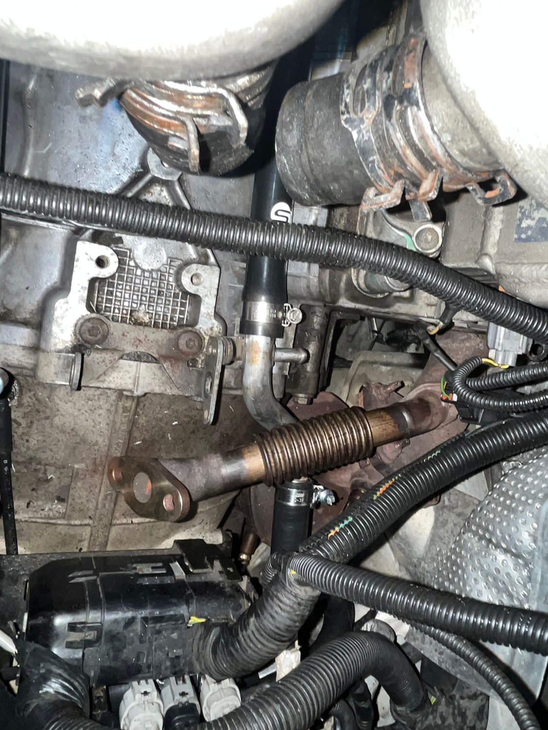

This damn stud to the EGR pipe broke off. If I could just remove the bolt on the other side, I could remove the EGR pipe and then work on removing that stud. However, I cant get ANY purchase on this damn bolt on the other side of that flange to be able to remove the EGR pipe. Does anyone have any idea what tool and what angle would best help here? I have tried socket-wrenches, spanners, off-set spanners, and none seem to work for me. Either they collide with the damn pipe an
This damn stud to the EGR pipe broke off. If I could just remove the bolt on the other side, I could remove the EGR pipe and then work on removing that stud. However, I can't get ANY purchase on this damn bolt on the other side of that flange to be able to remove the EGR pipe. Does anyone have any idea what tool and what angle would best help here? I have tried socket-wrenches, spanners, off-set spanners, and none seem to work for me. Either they collide with the damn pipe an

Thanks for the detailed write-up. I will be doing this soon as well. I really appreciate the time/effort you have put into documenting this.
I don't have much advice for the inaccessible bolt other than asking if you can snake a small dremel tool or fiber disc in there and cut enough meat of the nut off to remove it.
If the first stud broke, there's a good chance the second one will too.

Can you get to it with a small cutting bit on a Dremel at a angle and cut it in half, down to the threads? Doesn't look like a nut splitter will get in there.
The stud may be the attack area. Is that a 5 or 6 point head, 5 is harder to find, but lots of penetrating oil and heat would at least give you a chance.

Thank you, I've left it soaking overnight in the penetrating oil. Let's hope I can remove it tomorrow.

Thank you Wayne! Yeah, that one nut is so uncomfortable to tackle. I'm going to try a swivel joint with a socket but I'll let the penetrating oil do its job first. I agree, a darker shade of red should look nice. Thanks for the tip on the 400 and 800 grit. I've decided to remove the charge coolers to get the job done right. I also realized I have the charge air cooler/intake manifold gaskets unopened lying around from years ago that I bought them for my previous XK8 and then never got around to using them. I confirmed that the part numbers match.

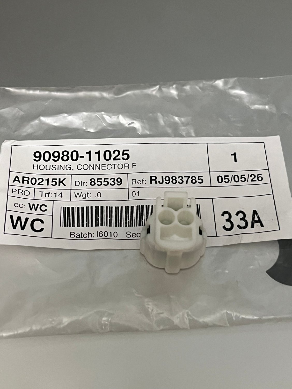

This brittle connector broke off. It plugs to a sensor on the right hand charge cooler. Does anyone know the part number?
The it connects to this.

Did you work out what that connector is? It's probably an Econoseal, but if you know what sensor it is connecting to, you can look it up in the electrical guide.

I have not. I also don't know what that sensor is. I decided not to worry about it, and the EGR pipe bolt for the moment and move on with the rest of the project. Sanding the charge coolers and the coil covers took me way longer than I expected. I applied primer last night. I hope to have some paint on them today.

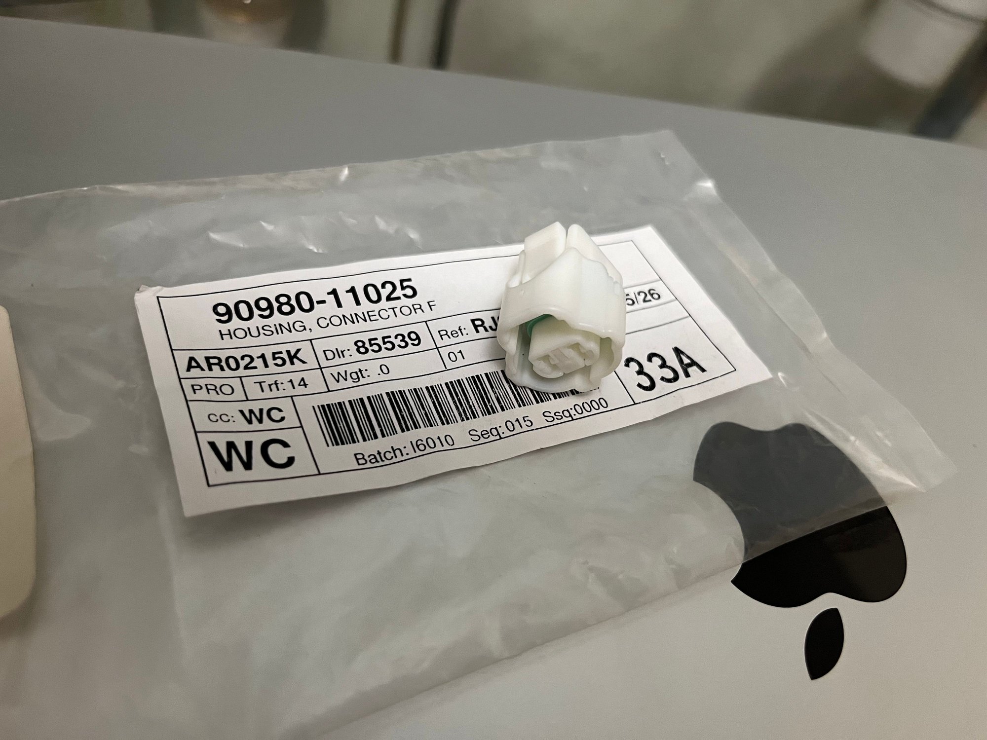

I think I may be lucky with that broken connector. I looked up the number in that picture, 11025 and I believe I've found a match from Toyota. https://www.ksvlooms.com/products/to...-plug-clip-kit
Called a local Toyota parts seller and asked gave them the part number 90980-11025 and he said he can have it here by 2:30 pm; it's $16.50. When I have it in my hands I'll let you guys know if it's a match. It seems to be a Intake Air Temperature Sensor Connector that Toyota used on the Mk IV Supra and many other of their models.

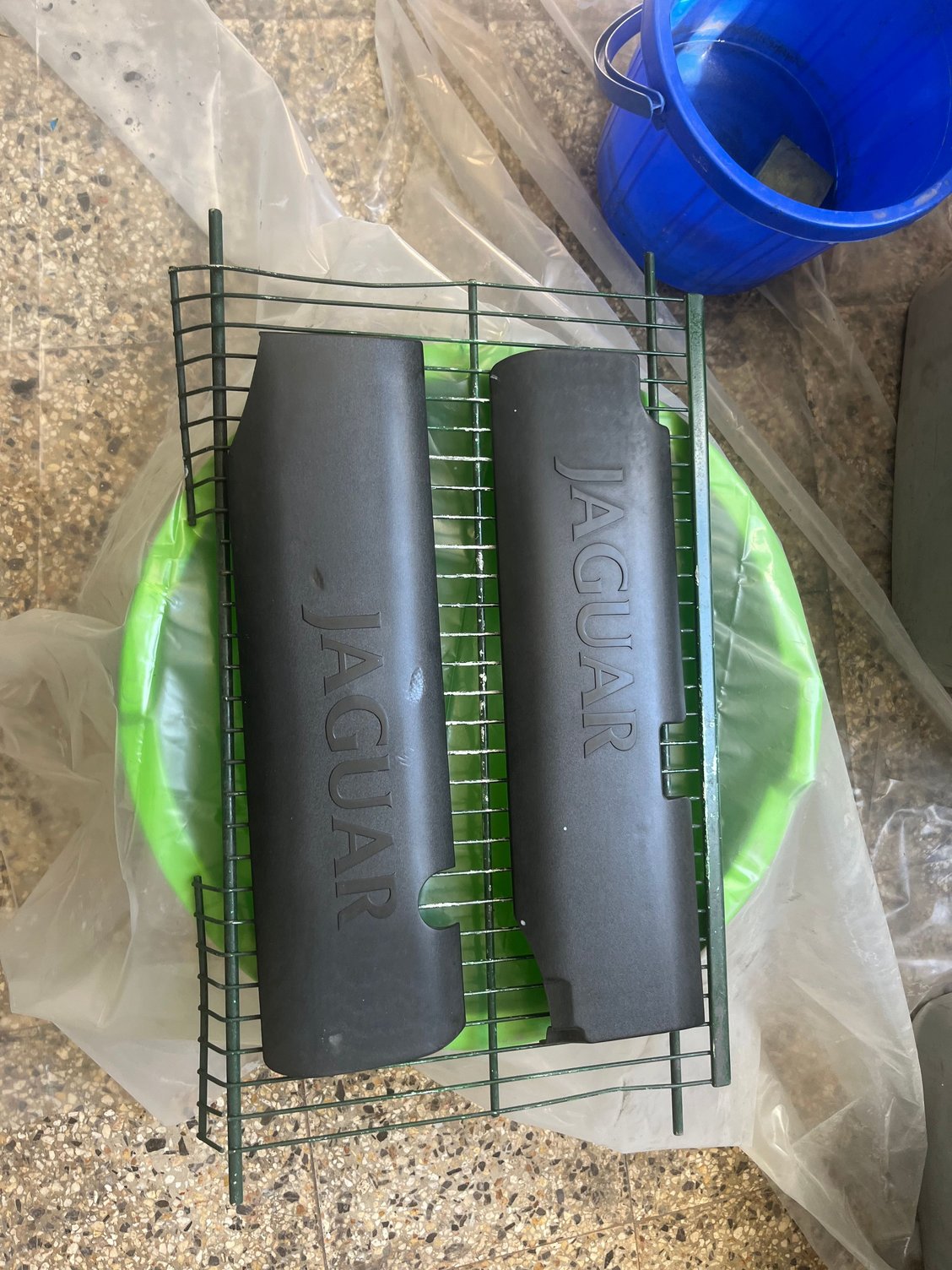

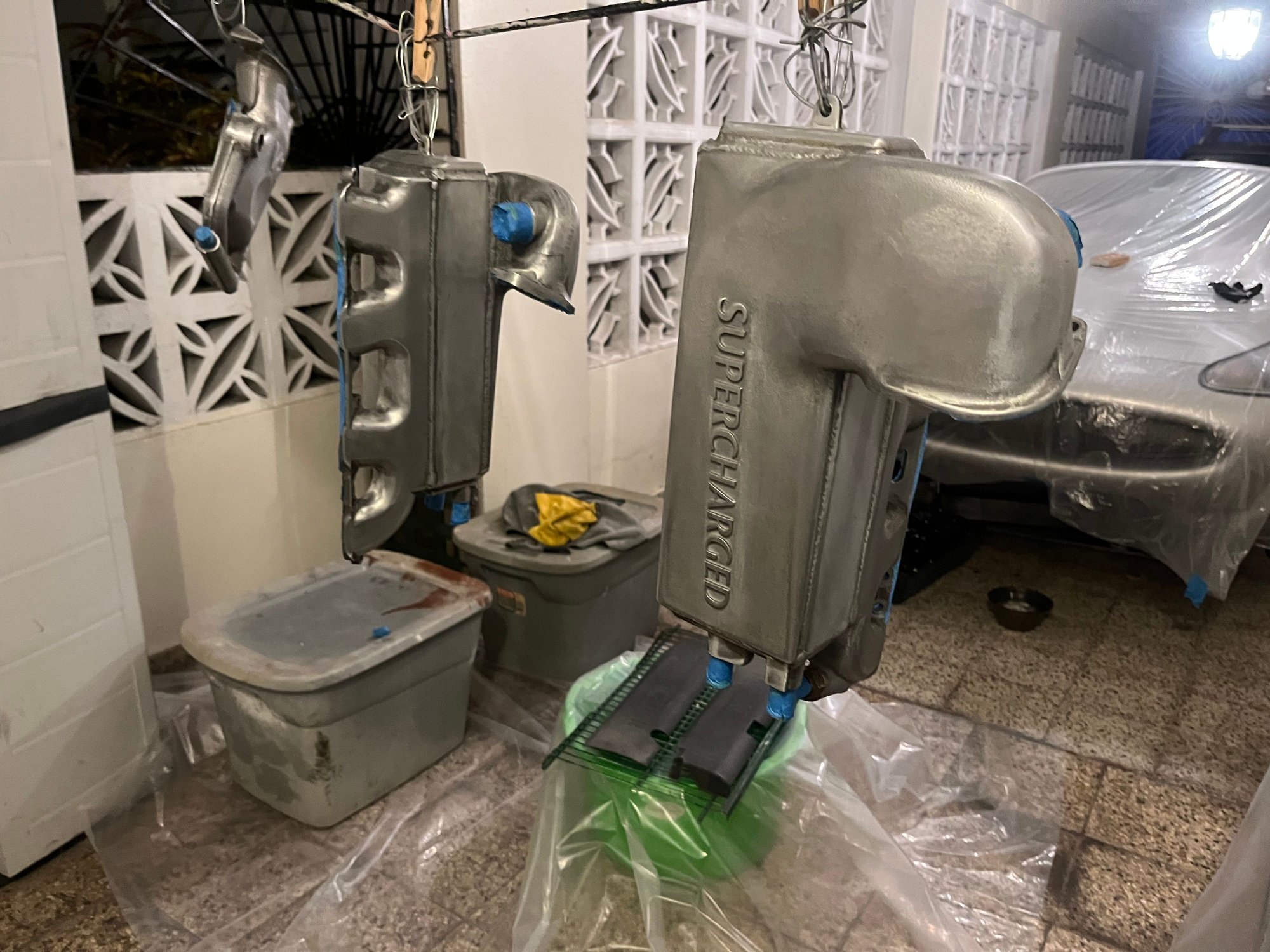

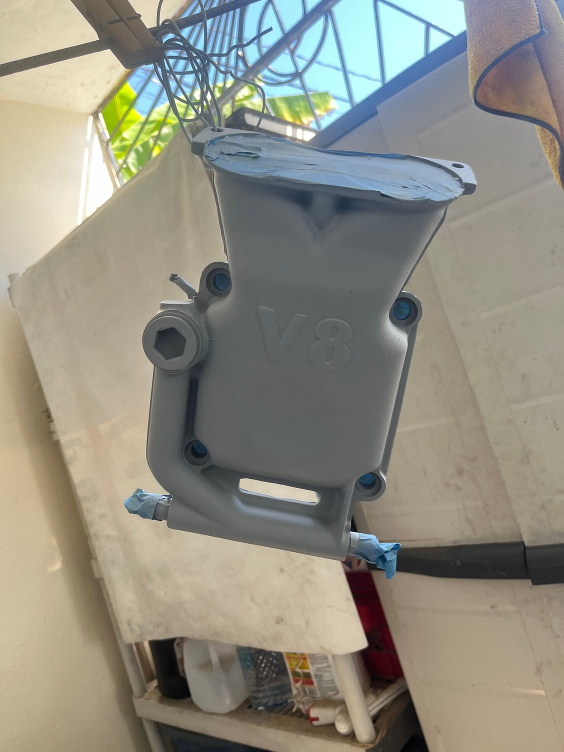

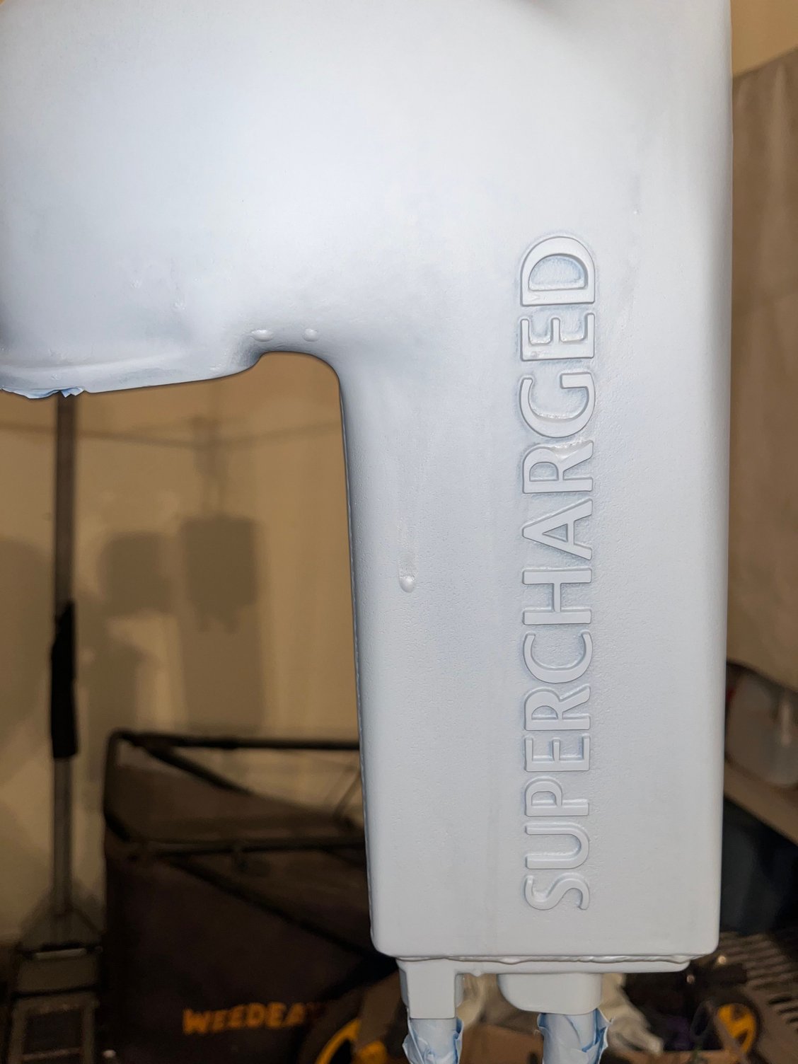

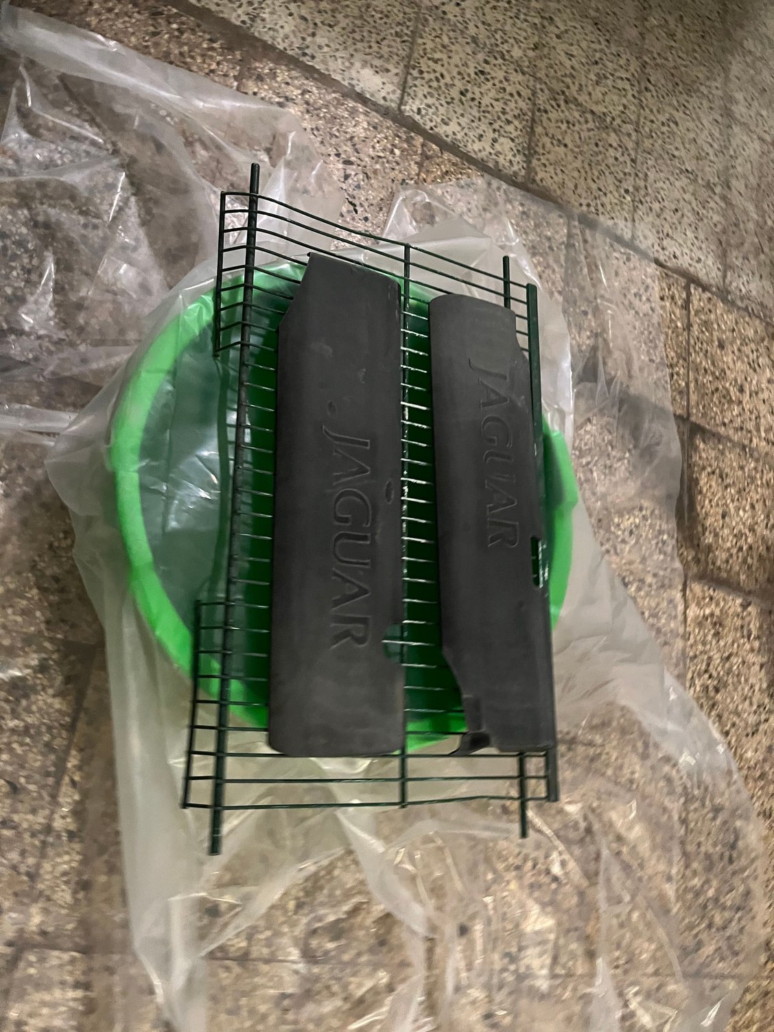

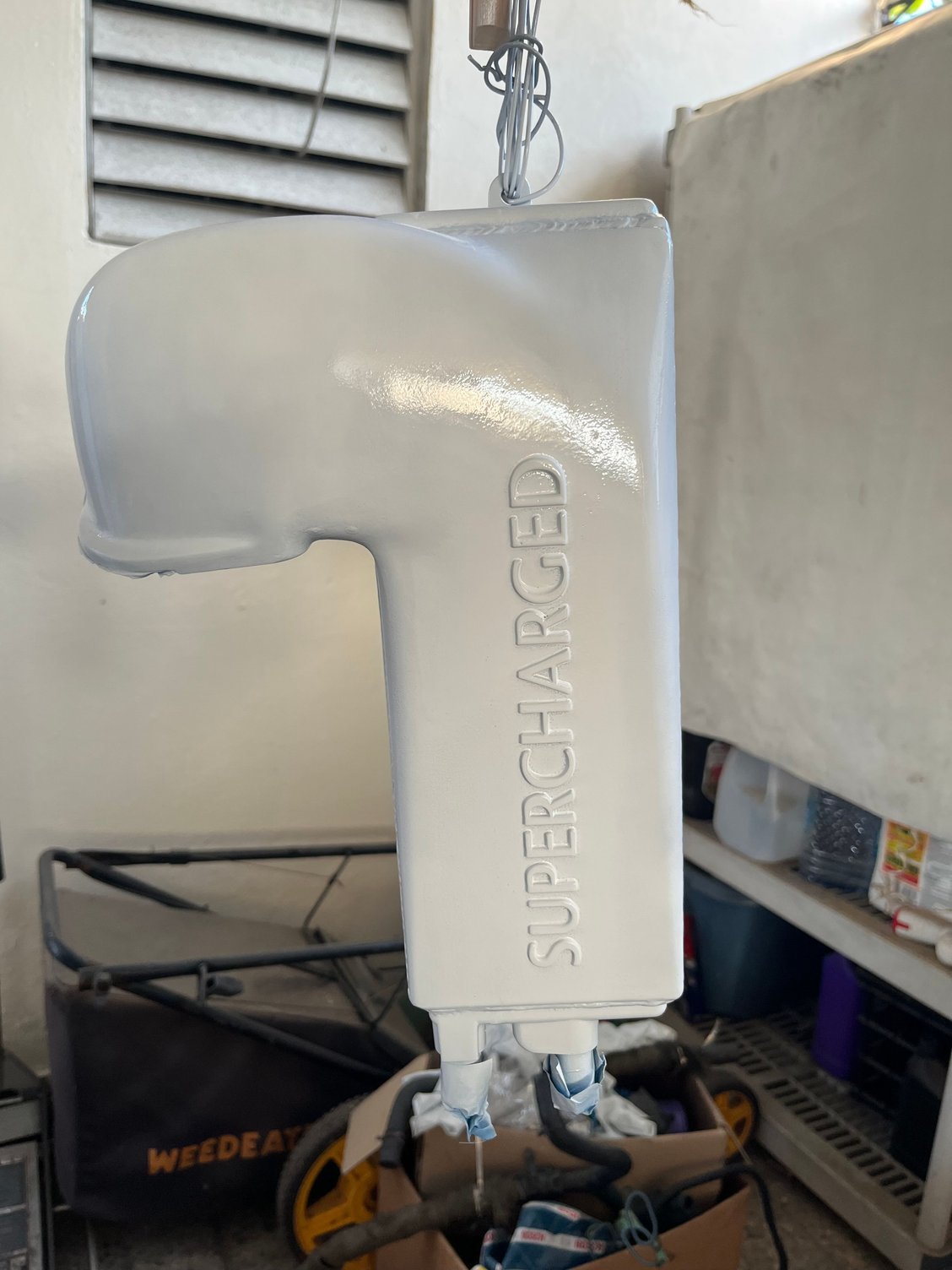

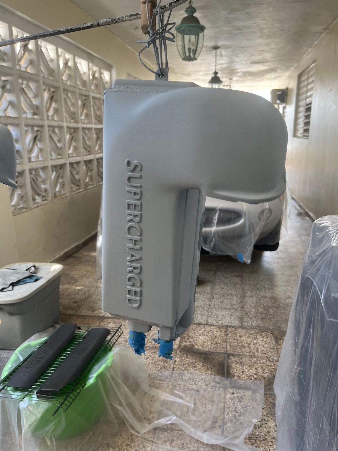

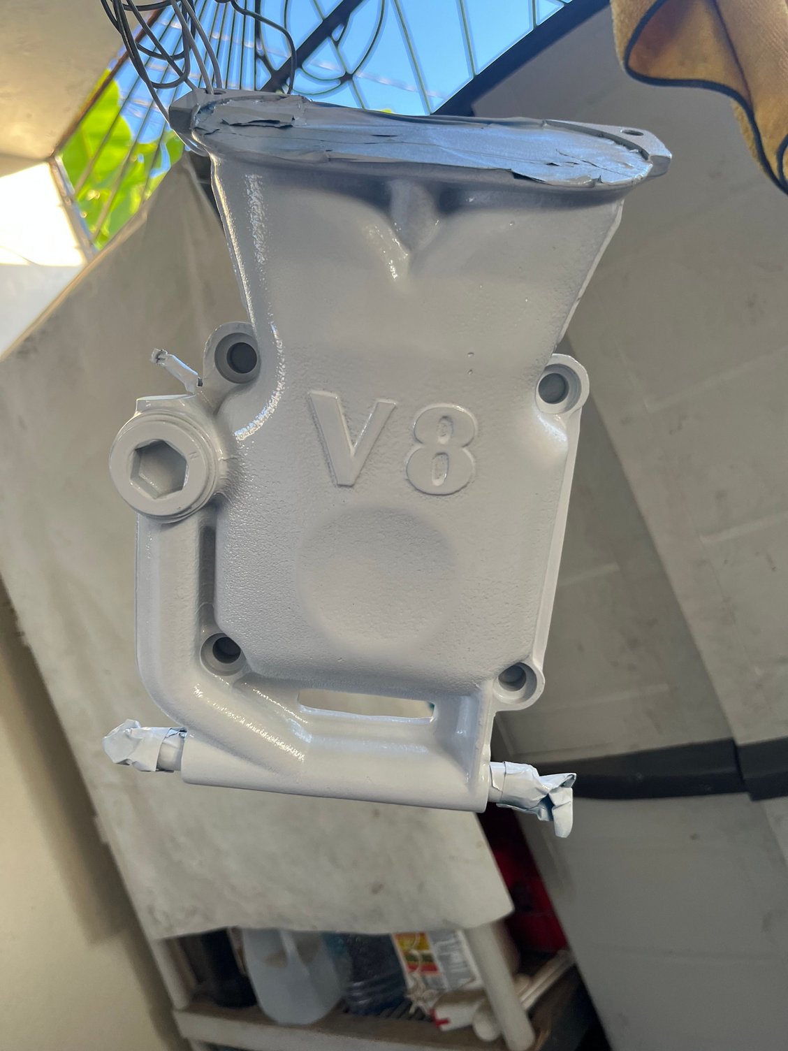

I have decided that the color for the charge coolers, inlet, and coil covers is going to be red with white letters. If all goes according to plan, tomorrow I should be painting red.
Confirmed that the Toyota female connector housing 90980-11025 is an exact match for the female of the intake air temperature sensor.

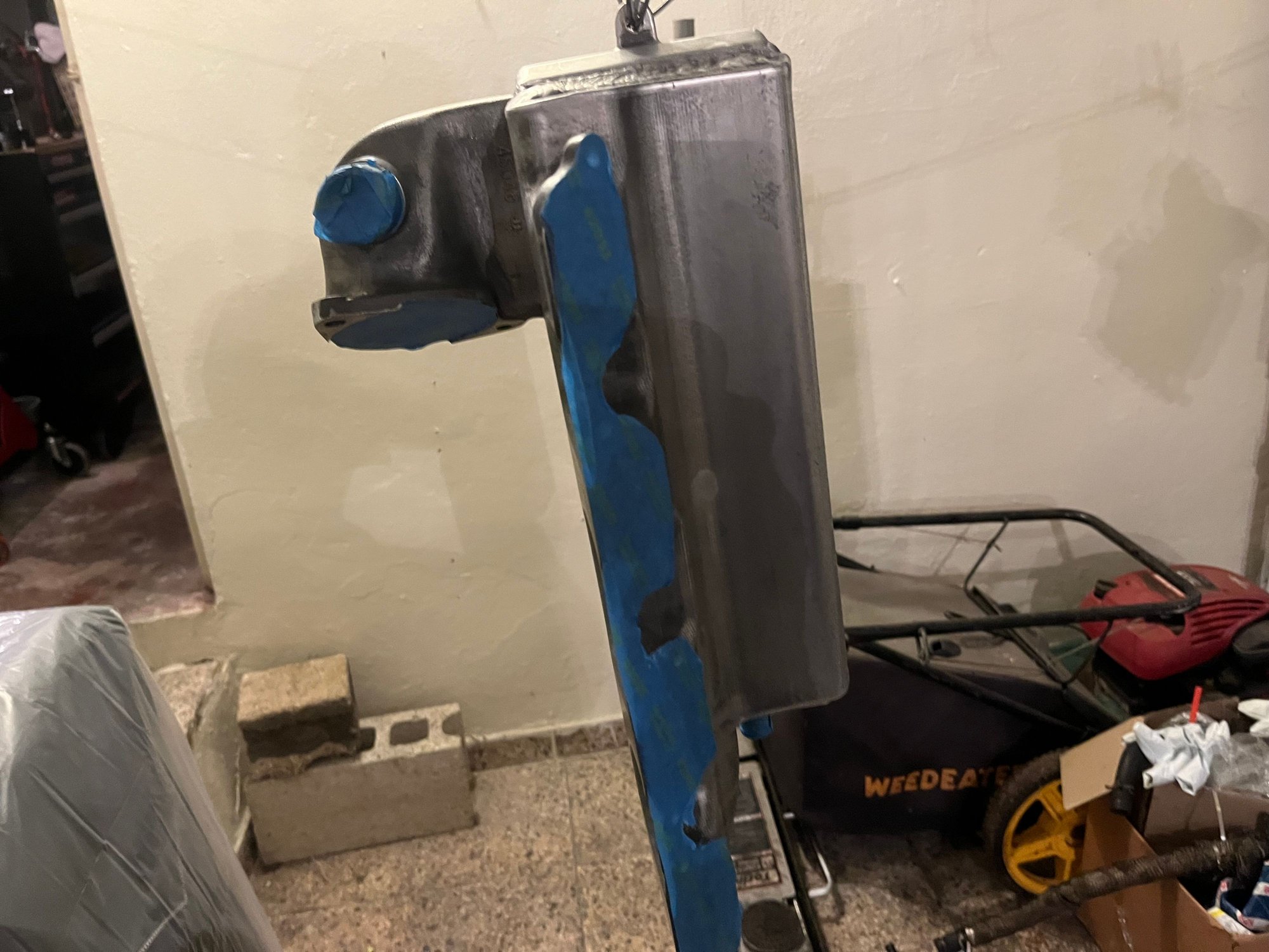

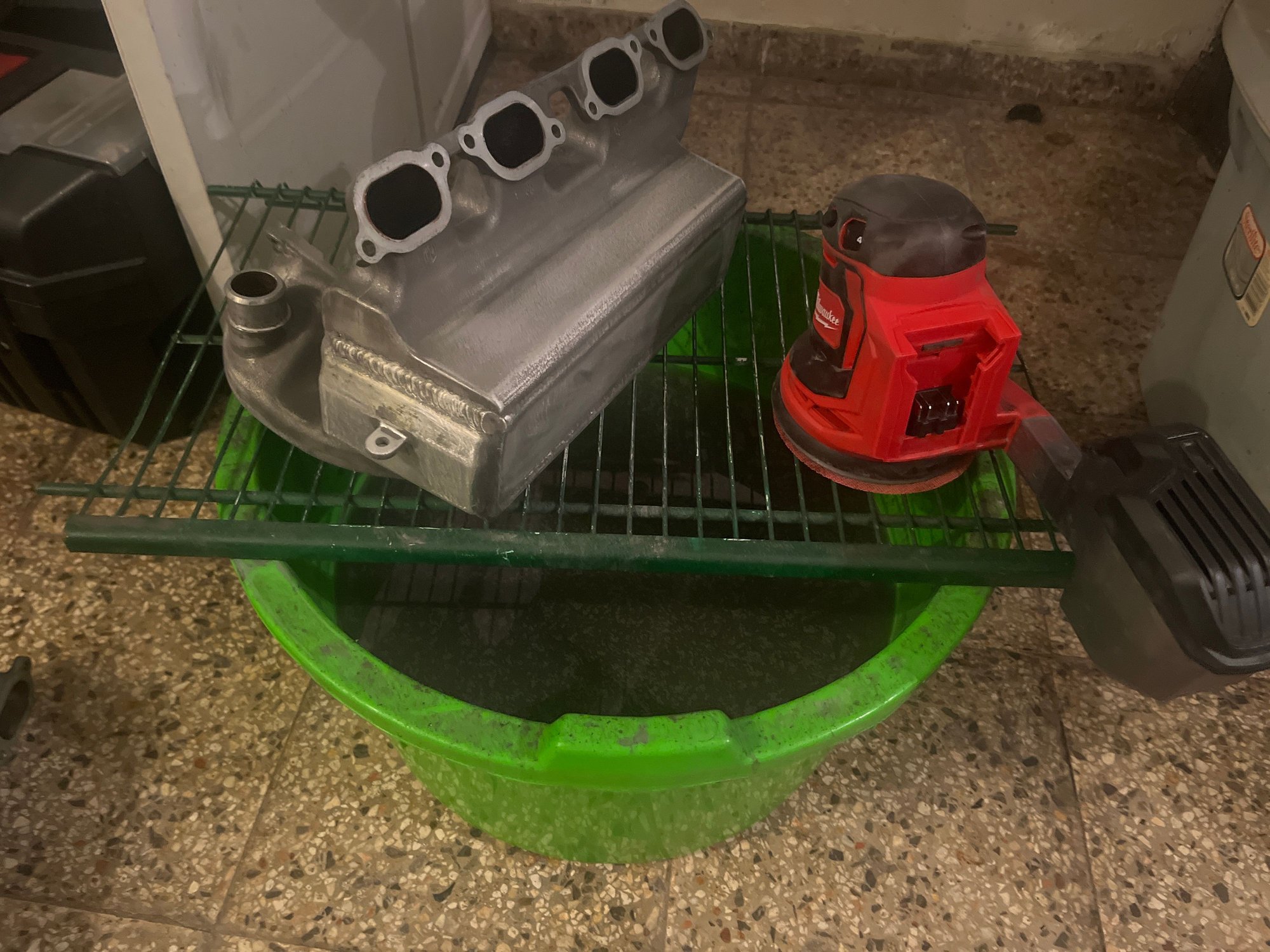

Cleaning and sanding the charge coolers and inlet took forever. If it’s available to you, try Walnut or CO2 blasting instead.

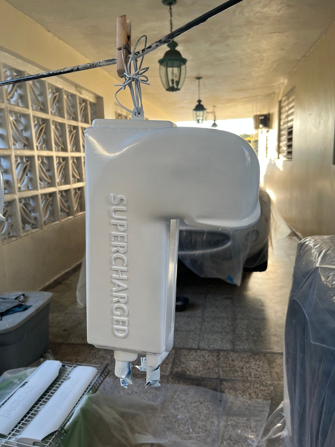

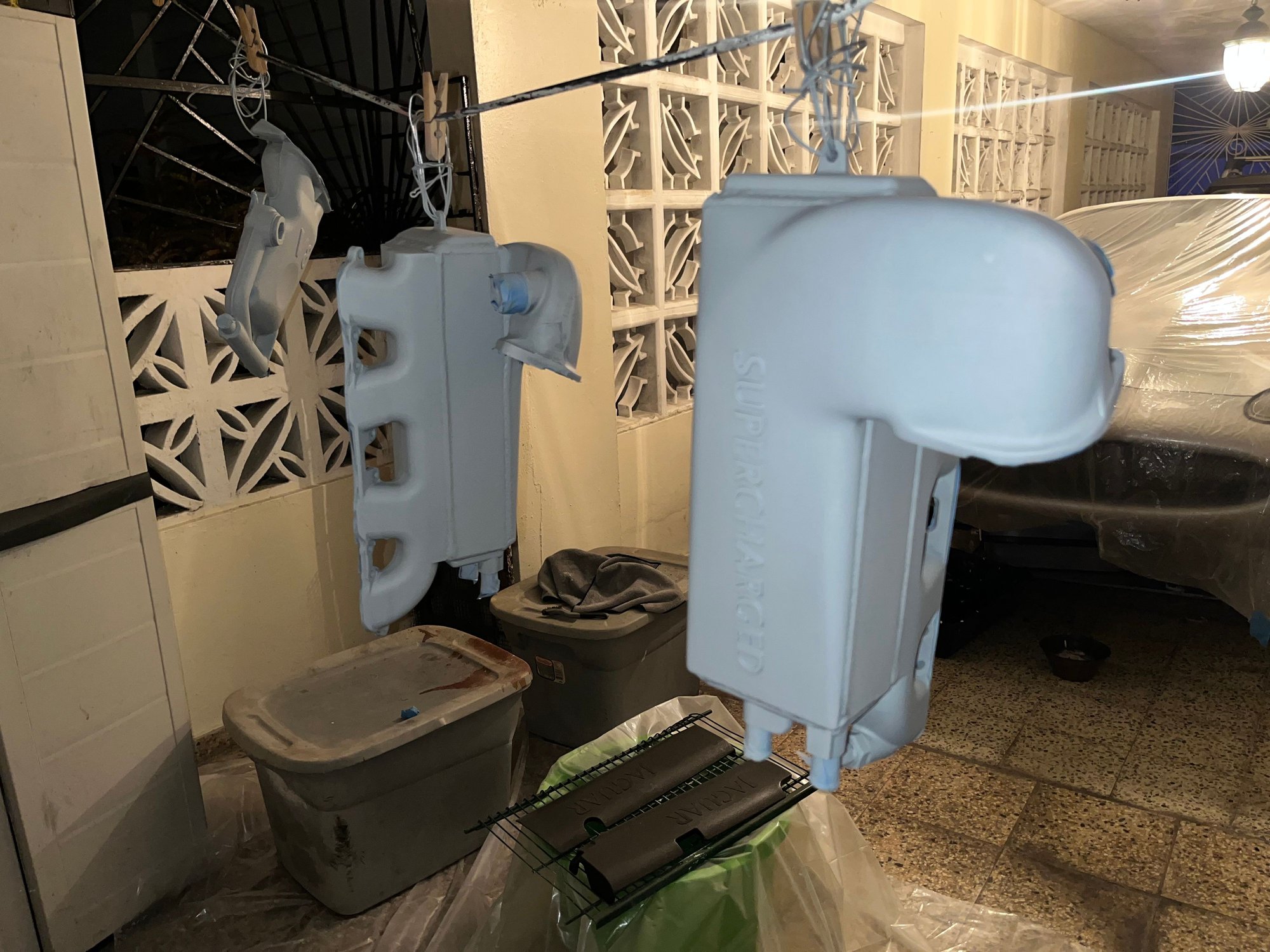

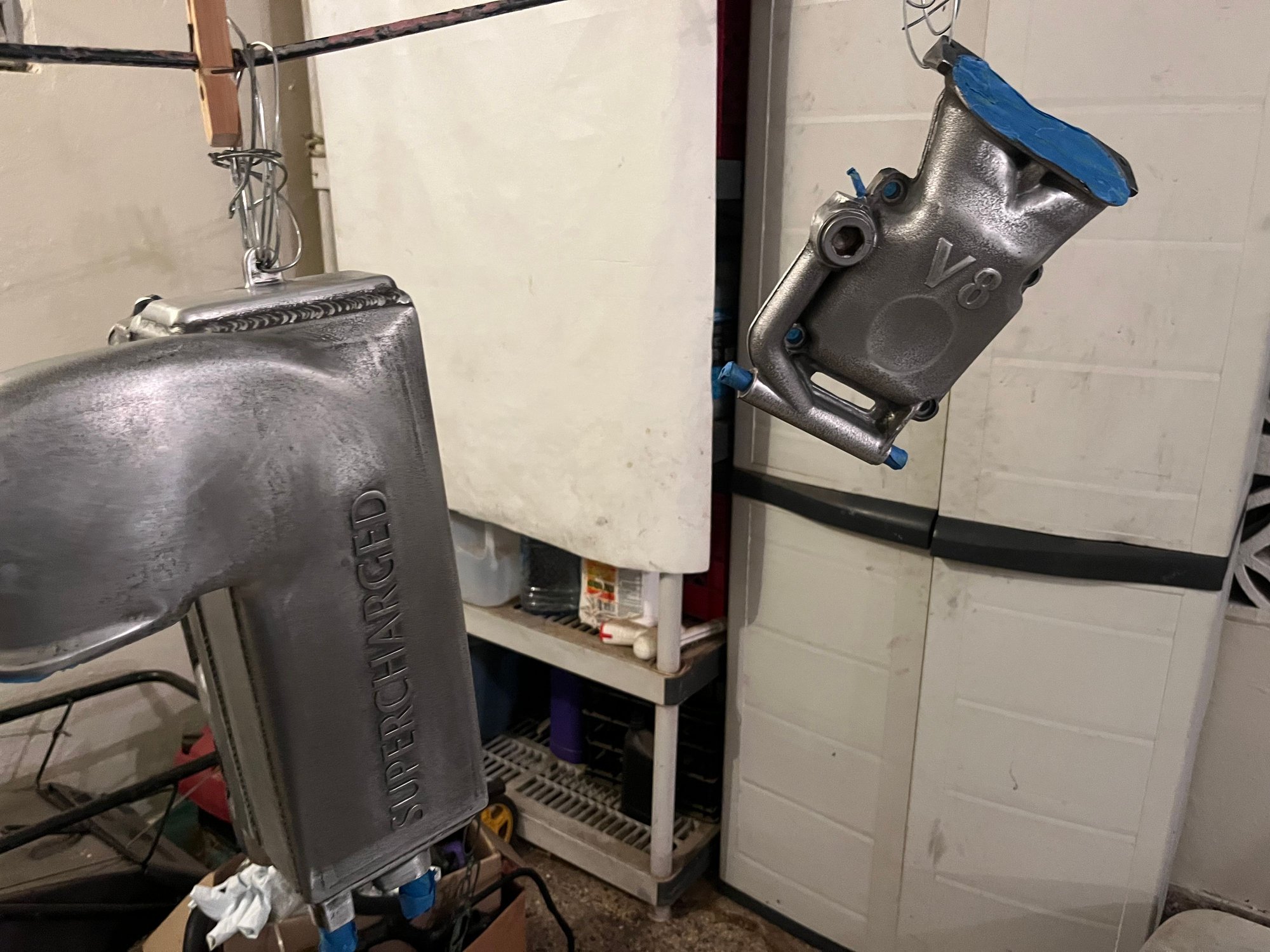

After masking, I got creative and hanged them for painting.
Notice that the Jag has a plastic tarp to protect it from overspray.
The floor and the washer and dryer are also covered in the plastic tarp.
The floor, the washer and dryer are also covered in the plastic tarp.

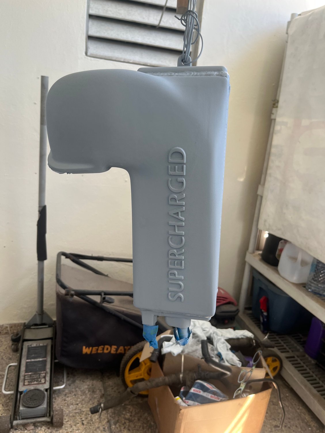

Primer
Primer
Small imperfection that I had to sand before a second coat if primer.
Paint adhesion promoter/clear primer was applied.
After drying
After drying

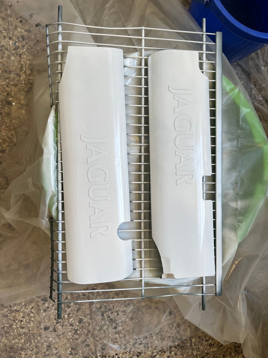

White paint layer
White paint layer
Masking the Jaguar letters before the coat of red is going to be painful.

By the way, I know how much work was involved.
Old May 5, 2026 | 06:24 PM
giandanielxk8's Avatar
Posts: 3,787
Likes: 1,675
From: Puerto Rico
Originally Posted by cjd777
Great job Gian, I'm loving it.
Thanks! It's been time consuming but fun because I'm actually modifying and upgrading instead of just repairing. Have you painted these parts on your car? What color did you choose?
Old May 5, 2026 | 07:47 PM
zray's Avatar
Joined: Jan 2018
Posts: 3,747
Likes: 2,336
Use some woven fiberglass material. It’s safe, won’t degrade, and does a good job of insulating anything. I wouldn’t assemble without some type of insulation, and fiberglass hits all the rights qualifications.
