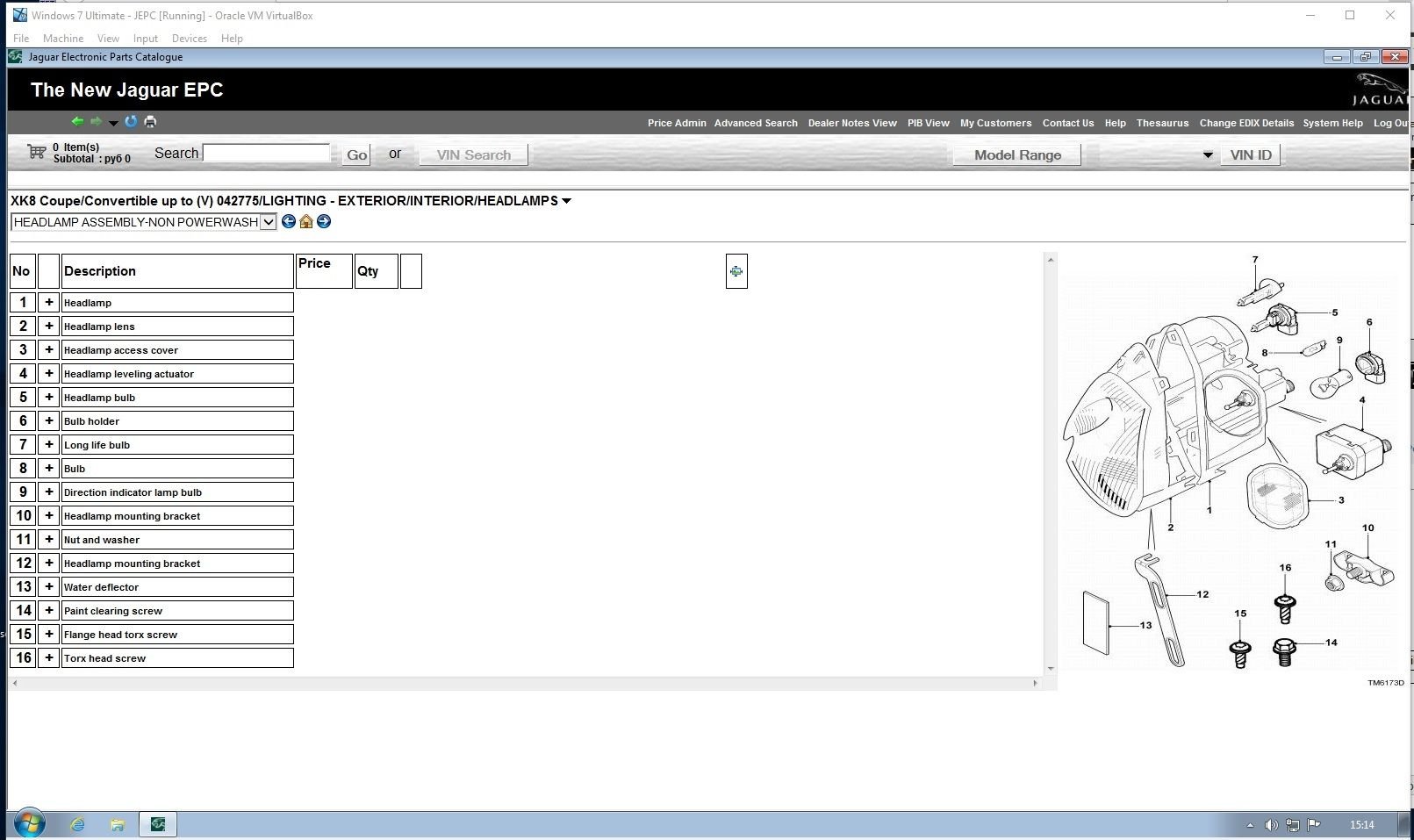

The LH main beam reflector has corroded and I need to change it or get it chromed.....but how do you get it or the headlamp out.
Have an on line manual 1900 pages and its in sect 80 but there are no references on the pages .
Thanks in advance
Old Apr 19, 2021 | 09:20 AM
Likes: 17,018
JTIS section 86.41.33 for removing the LH headlamp assembly attached.
This diagram from JEPC should help understand how to split the lens from the shell:
