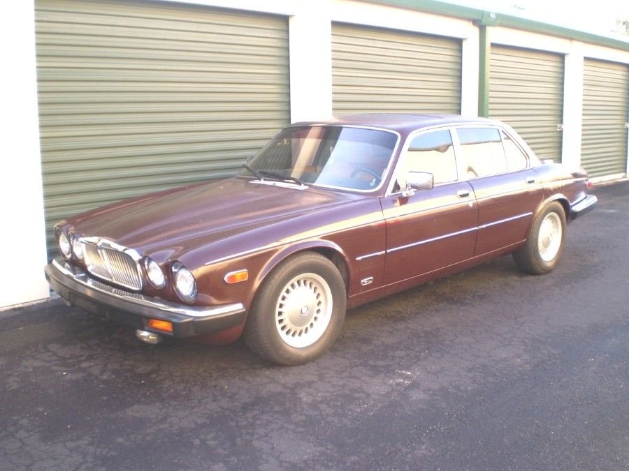

the 4.2 came off a running 1983 XJ-6 owned by Darren, a brit who lives nearby. He lumped his car with a Corvette 8 cylinder and transmission. Gave me the XK engine and transmission for little money. We dismantled the engine for transport, taking everything off of it, so i have it mounted in an engine stand ready to steam clean it.
the engine was pulled with everything, power steering pump, alternator, manifolds, intake, fan w/ clutch, water pump, hoses, you name it, then everything removed. Has a nice solid steel flywheel/flexplate, and one of those torque reduction Starters, I mean, the Starter alone is worth what I paid.
I will keep the DG250 transmission, it is fine and it mates fine with the 4.2. The rebuilt BW66 is for the XJ-6.
i was told that I can get the tachometer signal from the distributor and coil since the 4.2 does not have a tach generator. Or to get a tach from a 420 that does not have the clock. I like the tach with clock. Mike Eck of Jaguar Clock modified it and it works perfectly.
Anyway, I hope to get this done by end of year when the temp drops in Florida and I can drive it w/o a/c.
