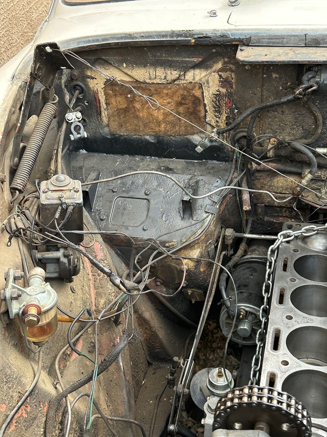

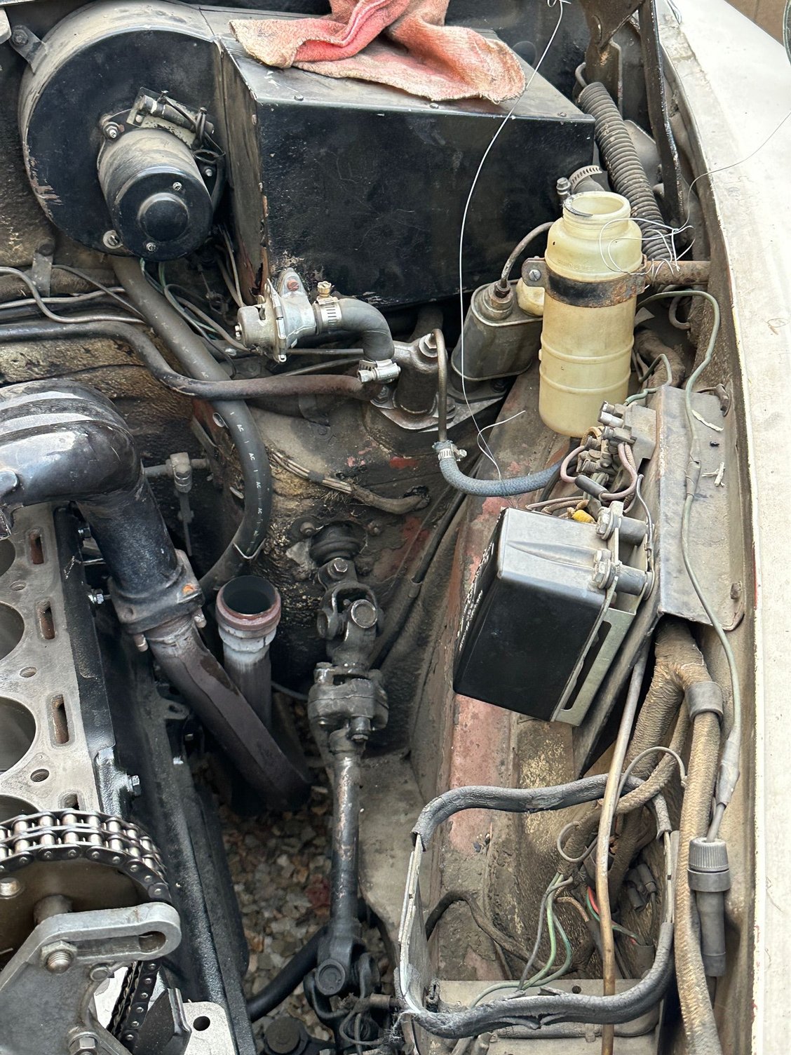

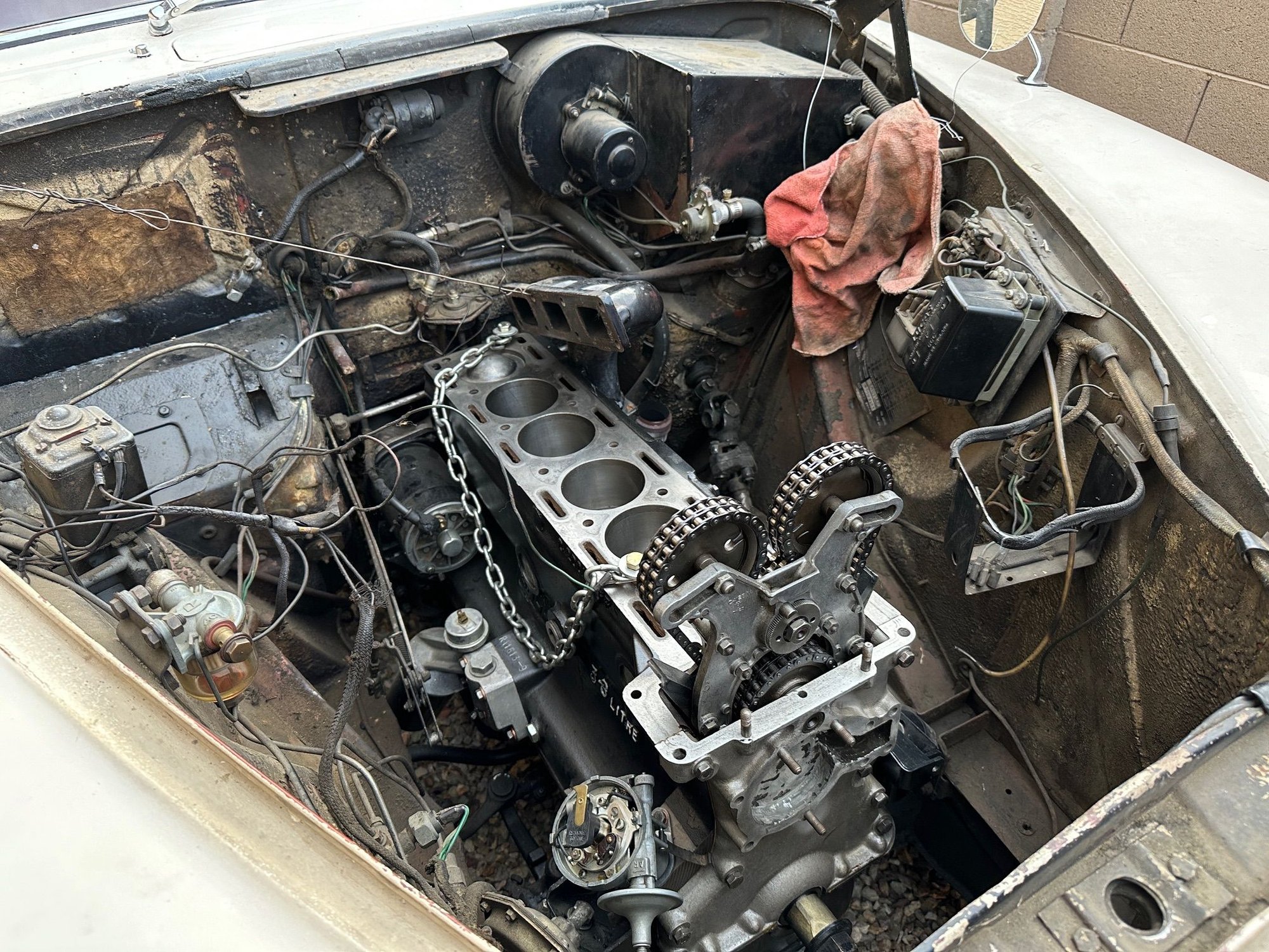

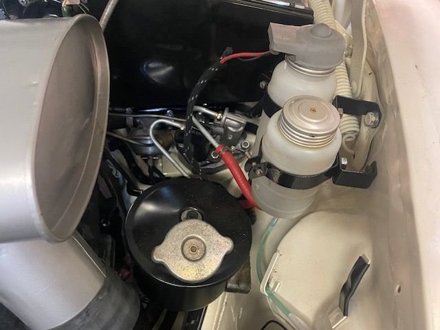

Morning All,
Can I ask a favor?

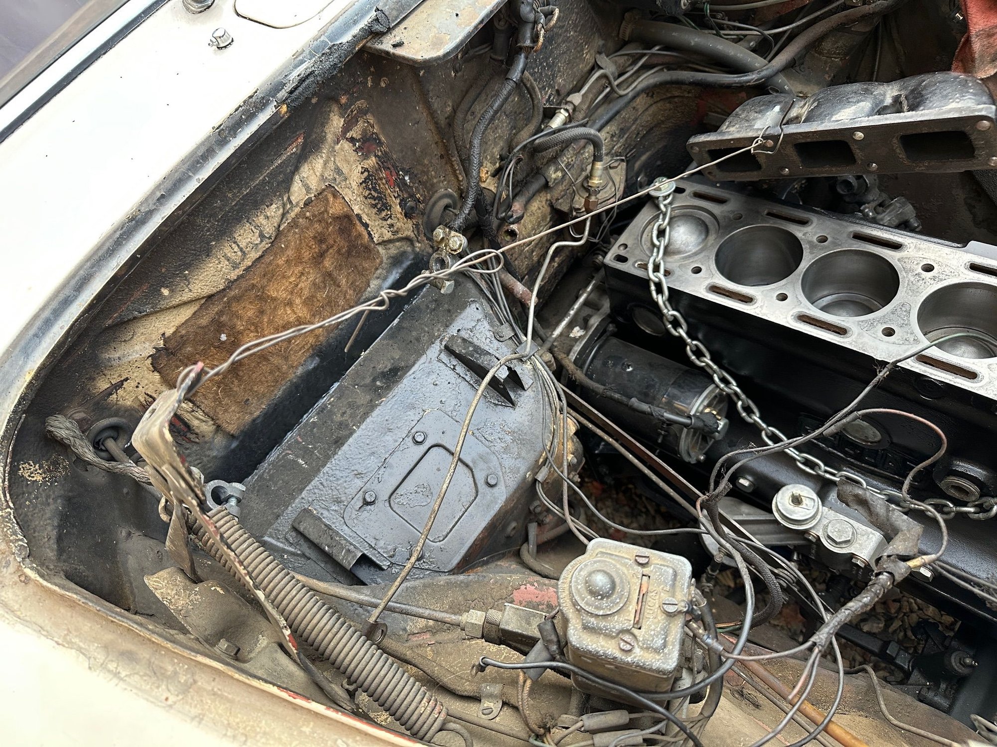

Can you send me photos of your engine bays?

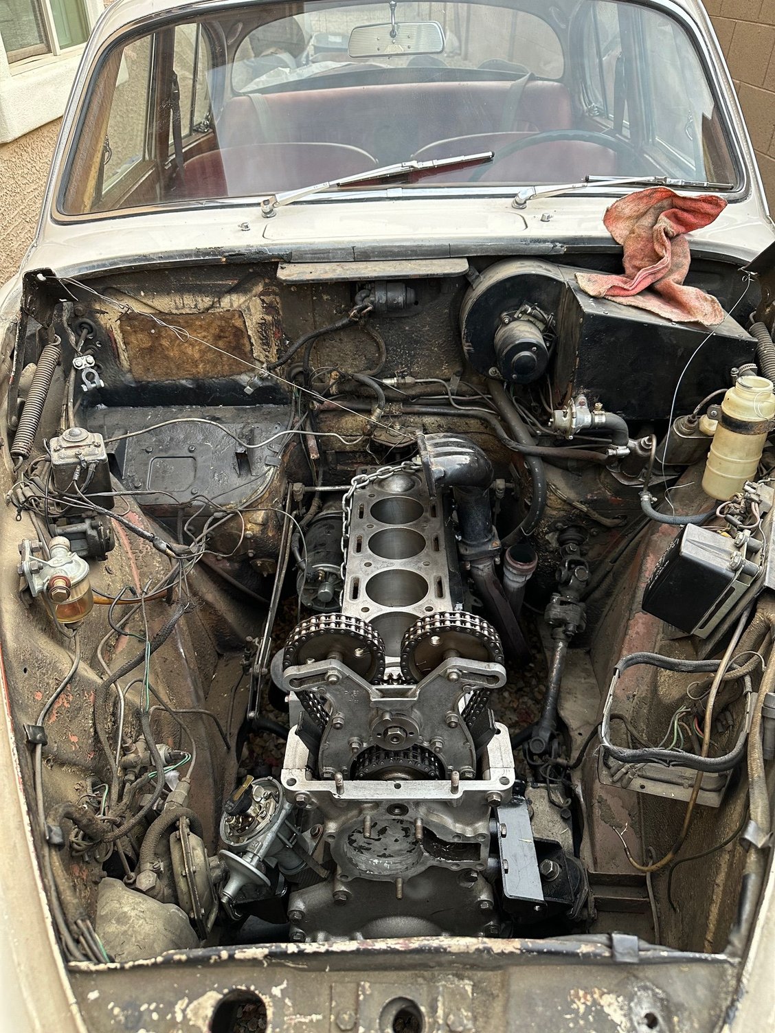

I have a 3.8 that I just took over and its missing a few bits, and I have no idea what i am supposed to see when i lift the bonnet...
All angles
Battery Box Missing?

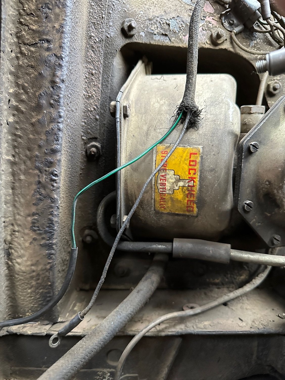

What is this?
What is this?
Where does the brake master cylinder go? what about the clutch cylinder?
, and any tips appreciated.

Where to begin? The Lockheed canister is the power brake servo that is vacuum operated. You're missing the generator and possibly the power steering pump that attaches to the back of the generator if you have power steering which means you're also missing the reservoir for that. Unfortunately you have a massive hole in the wall where the battery goes. It was possibly cut to put in an aftermarket air conditioner. I have a 66 3.8 S Type. You have a MKII. Very similar engine compartments though. Air filter box is completely different
Thank you very much, good news is there is no hole where the battery sits - thats a felt pad glued to the firewall/bulkhead.

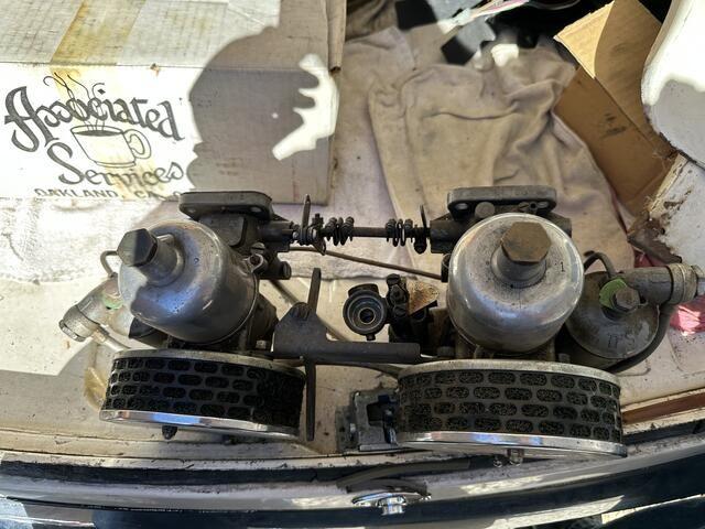

I have so many parts in 6 different boxes including 2 sets of SU HD6 carbs - this one is, is suspect the one for this car
which negates the need for the airbox (but i do have the original parts)
Missing one of the two exhaust manifolds, I have a alternator (generator?). hoses, more gaskets than i can count (10 exhaust gaskets - all brand new)... missing Radiator, and many many other parts..
What i do know is this car was originally exported to Zurich, then imported to USA in '71 and still has KM/H Clock.

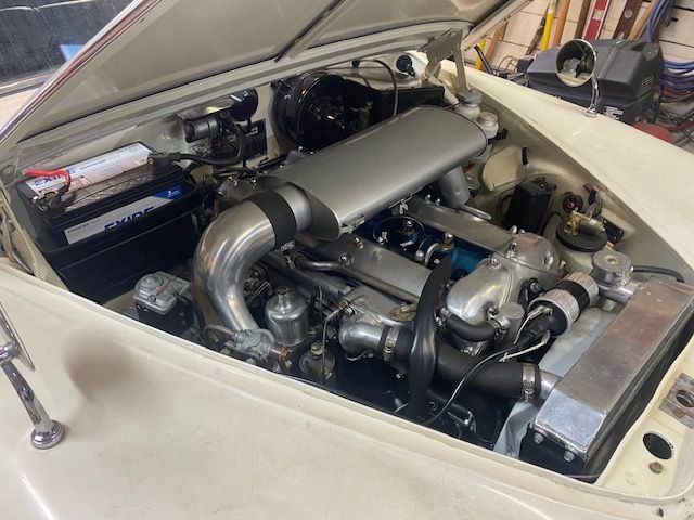

i bought a new aluminum radiator off of ebay for a very reasonable price, had a professional install it....said it was not too much trouble to fit it. i then drove it from idaho to california last summer without issue. ('67 340)

The battery area is OK for a Mk2. They originally had a battery tray but a piece of 3/8 or 1/2 plywood will do the job.
Those HD 6 carbies or Ok but PLEASE fit new diaphragms before putting them on the engine. Well known fire starter as the old brittle diaphragm splits and fuel goes onto the distributor.
Check carfully for the starter carbie bits in your spares. that mounts over the large hole you can see between the HD6s. New bits for this starter carbie cost a fortune.
An aluminium radiator will work OK. Just do your homework and make sure that it will fit. I am running one in my MK1. Check with Huey about his source.
Finally, if you haven't done it get hold of a MK2 workshop manual.!!!!!!
Just be a little wary as there are subtle differences between early MK2s vs later cars e.g. 340 and S types
Dont suppose you still have the link to the radiator?

ha! you're in luck! like is mentioned it looks like i DID buy it on ebay, and fortunately for you, they never throw away any info that might bring them so much as a dime in the future, so they still had the info on my purchase. and it looks like they are still available too.
https://www.ebay.com/itm/284737466550
as i noted, i didn't install it, my mech did and the installation was just a minor part of a major engine and trans overhaul, i did ask him about the radiator install and he said he had to do a little fitting. i didn't ask for any more details, but i sensed that it wasn't all that difficult, but then again he's a pro. it appears to be up to the task...no leaks.
of course, it doesn't look OEM, but that's not all that important to me. if it were i'd first remove that double snouted manhole cover of an air cleaner that effectively blocks any access to the carbs!

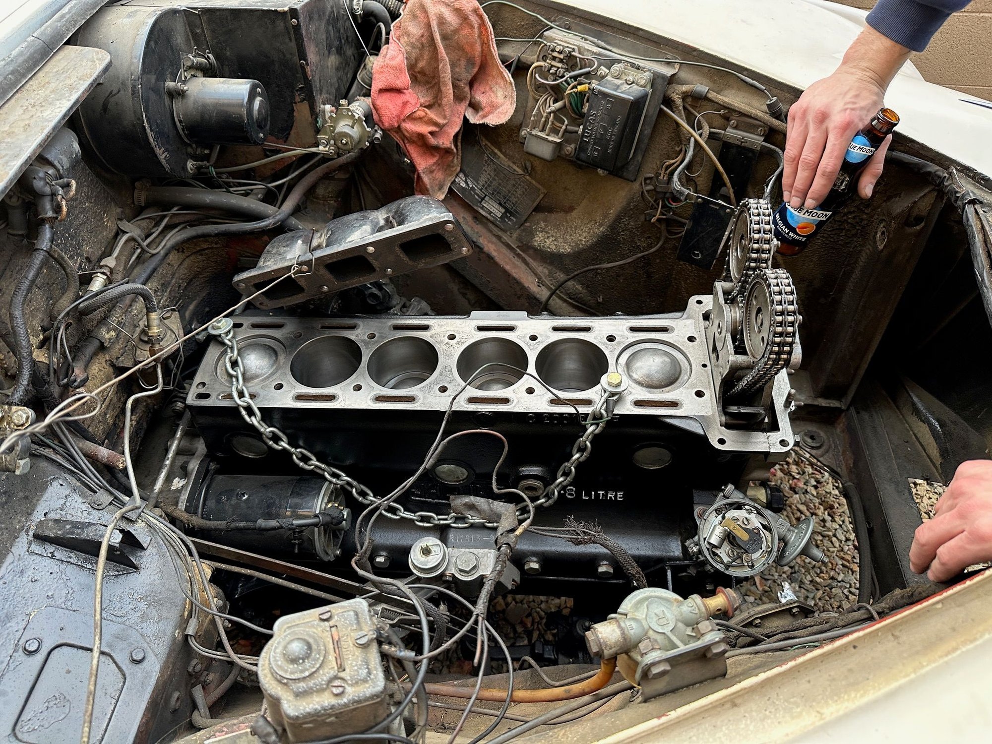

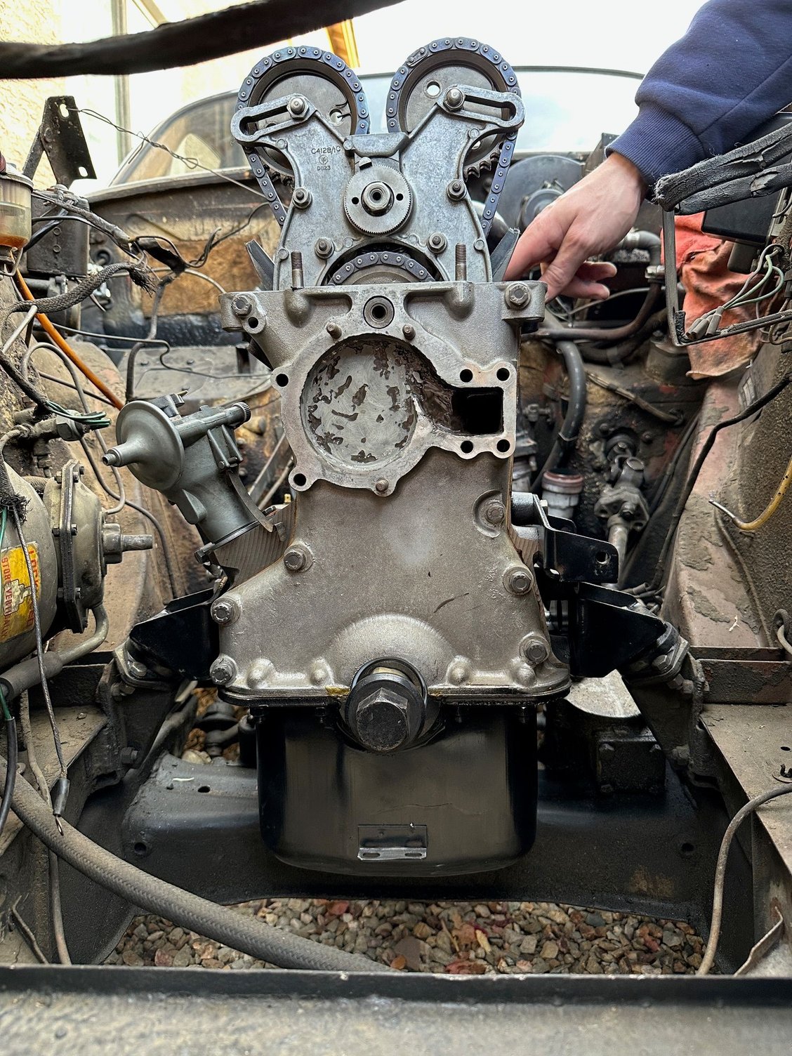

That engine looks like it has been through an overhaul. Note the shiny pistons, missing cylinder head studs and clean timing chains.
I believe it would be worthwhile to do some serious detective work and find out where the overhaul work was done.
That may assist you in the mystery of the missing cylinder head and its current whereabouts.
PO’s grandfather was a jag dealership and had installed bigger pistons and decked the block for more power. The block and gearbox look like they just came out of the showroom.
unfortunately the grandfather passed away and the family split the content of his garage, the PO thought he got everything for the Mk II but alas did not. I have a literal ton of XJ parts, MG parts and a small box of Mk II parts (so far)
still got 3 or 4 boxes to go.

If you need a cylinder head, later XJ heads fit. They have an extension at the rear that overhangs the older blocks. It's not a problem, but exposed water passages have to be plugged. Also, you will need an inlet manifold from a straight port head (XJ or 420). In fact, the series 3 XJ heads are probably the most desirable.
