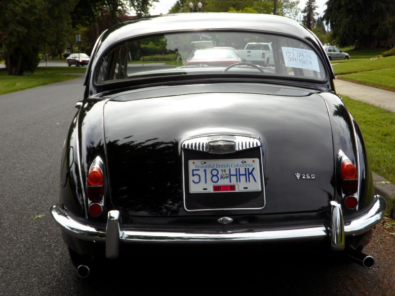

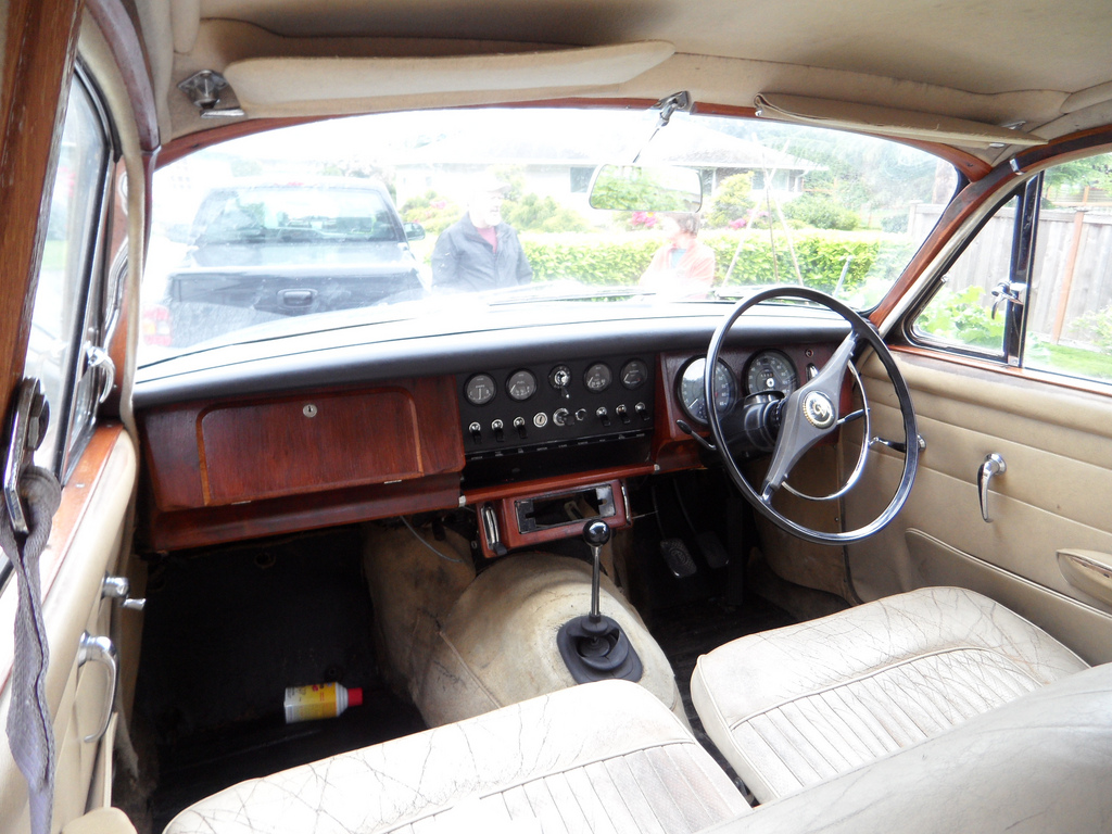

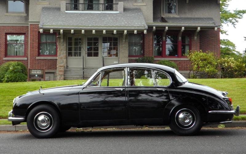

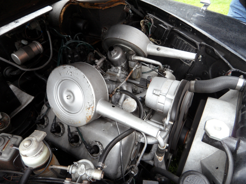

I had seen this car briefly at the Vancouver, BC (VanDusen) ABFM. It appeared to be complete, original, and rust free. I followed up with some email exchanges with the owner over the last couple of weeks and went to examine it today...with a car carrier and cash "just in case"
It turned out to be all I thought it was and more. The little V8 purred like a kitten. No rust whatsoever. Everything was there. I drove it on the trailer and cleared customs back into the US from Canada easily.
It still needs a lot of love. I want to go through the brakes, drive it some to determine if it needs anything else mechanically, clean it up, then decide if I want to do a full blown cosmetic restoration on it or just maintain it as an "original".
Oh, I did drive it some tonight (couldn't resist). It really scoots with the 4 speed OD and that little V8. Far better than I would have expected out of 2.5 liters. I believe it must be geared relatively low since the OD can compensate on the highway.
Here's a few pictures...

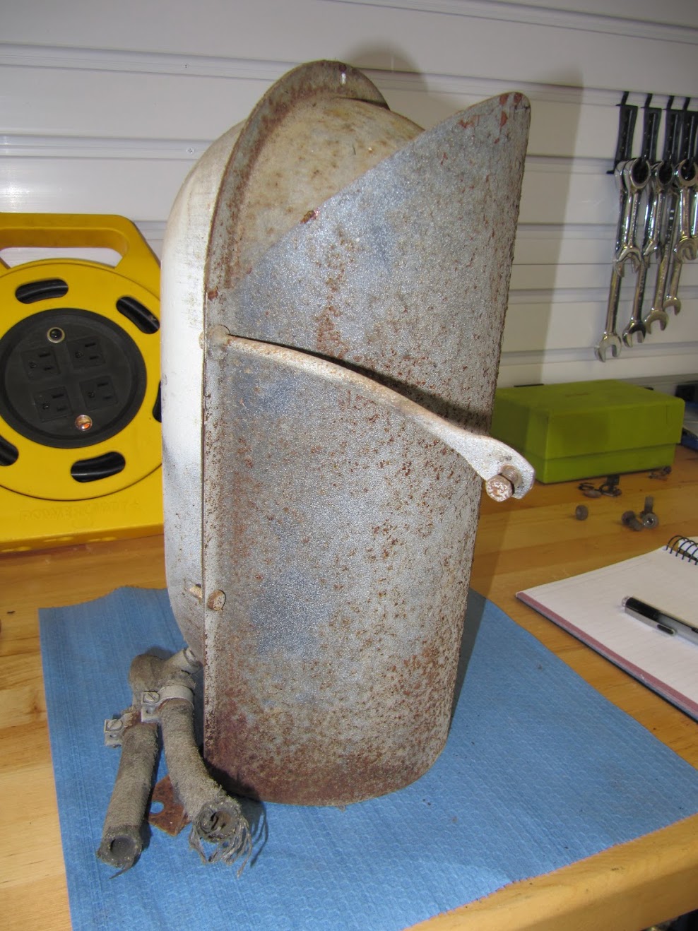

This is an old thread, but I am the new owner of this car, and I have the following update:
  1. The brake servo gave up the ghost this fall. It got us through a cross-country trip before doing so, though, so I can't really complain.
  2. While installing the newly rebuilt servo (thank you, Power Brake Exhange!), I found a hole in the Reservac tank.
In other words, the correct answer was: "C - All of the above". Thank you for playing!

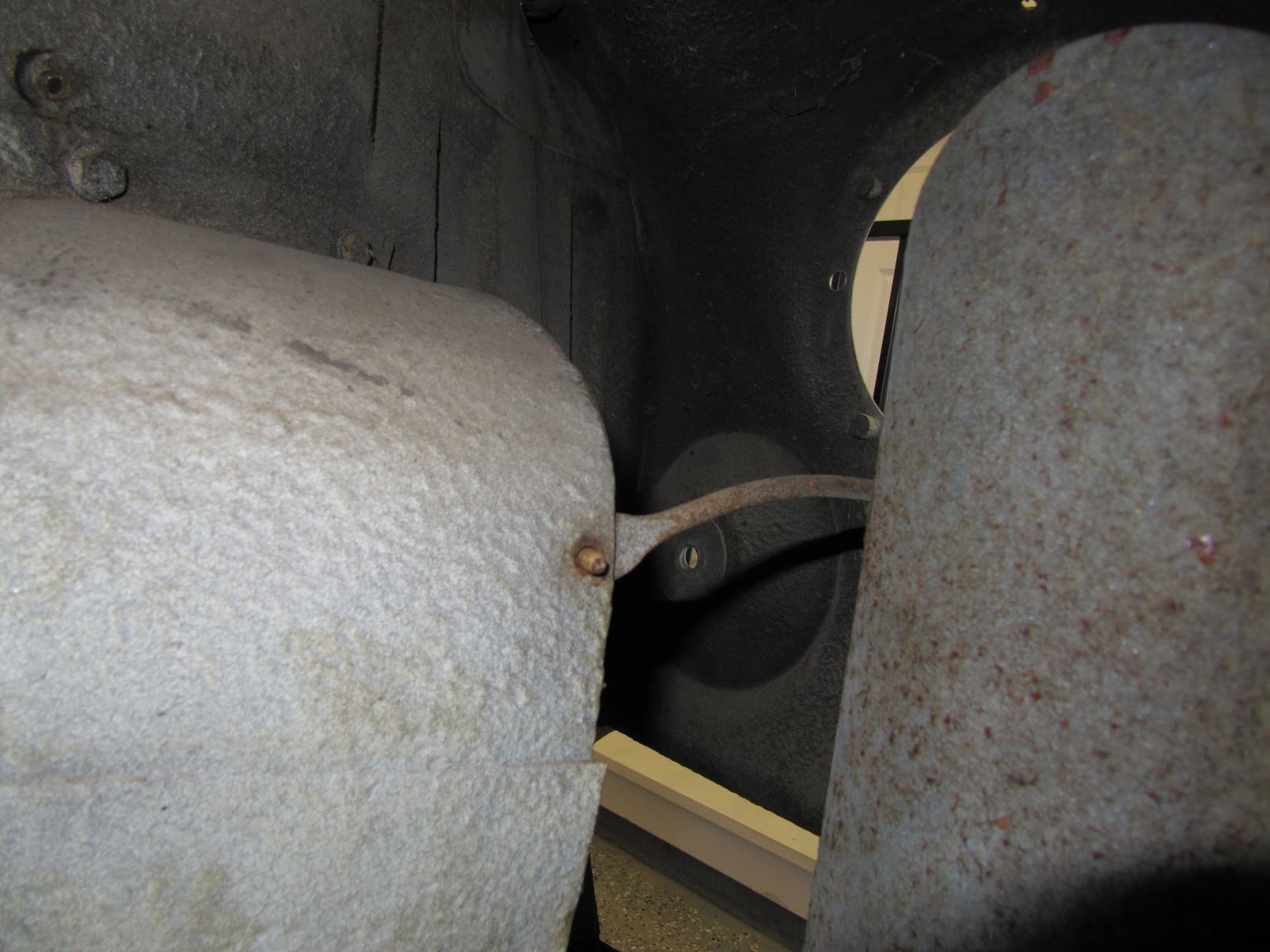

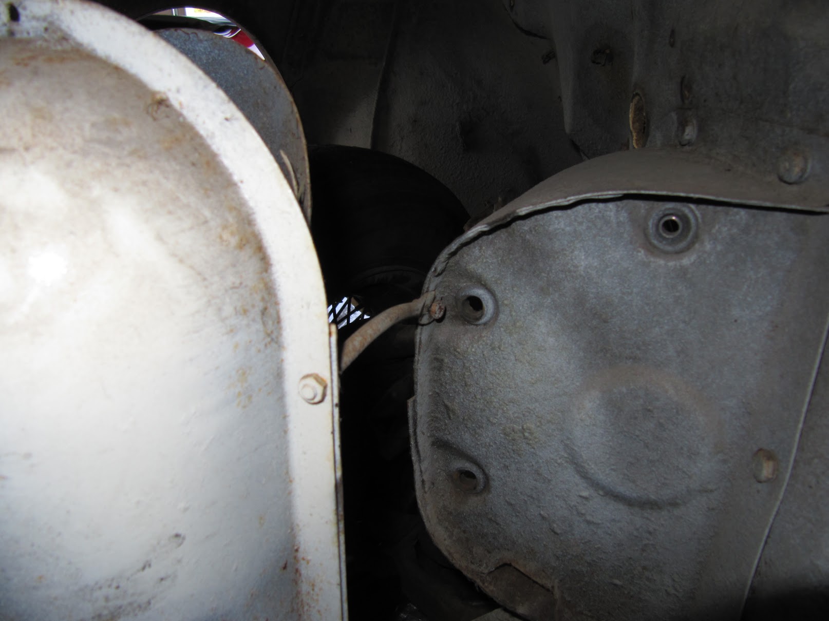

While I am here, does anyone have a good photo of the Reservac installation so I can set it back as it ought to be? I see from the SNG Barrat Catalog that there is the tank, the check valve, and the stone guard, plus a support rod. Most of that looks obvious, but I am unclear about the support rod, which seems to be NLA. This car's old tank was mounted horizontally using angle iron and metric bolts, so what was there before is of little help.

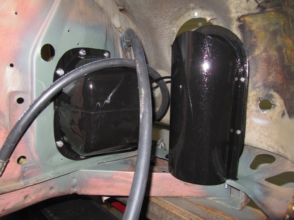

Tom,
Check my website for a good photo.
Air Conditioning ? Valve Chatter
The link will take you to the air conditioning post. Scroll down a fair amount and you will see the servo cowl, the reserved tank and the little mounting arm. Click the photo to see a larger image. Let me know if you need something more.
Lin

Thanks for the links, Lin, that's one heck of a project! I only wish I had the resourcefulnees and skill to pull something like that off (I actually need to do something similar to re-mount the dealer-installed A/C system in my MGB GT - The standard install left a lot to be desired, such as big holes in the firewall).
I attached the photo you mentioned for the benefit of the archives, and here's the relevant text, too:
"I then mounted the Reservac vacuum tank. It mounts to the body with two 5/16″-24 x 3/4″ hex bolts, flat and shake proof washers and nuts. A small brace arm connects the vacuum tank to the cowl for additional support."
I can't really see the support rod, but I presume it crosses between a bolt hole on the tank shield and one of the bolt holes on the servo cowl?

Here you go Tom.
Attached Thumbnails Newbie...dragged home a '67 Daimler 250 V8-img_1991.jpg   Newbie...dragged home a '67 Daimler 250 V8-img_1992.jpg   Newbie...dragged home a '67 Daimler 250 V8-img_1994.jpg   Newbie...dragged home a '67 Daimler 250 V8-img_2000.jpg
