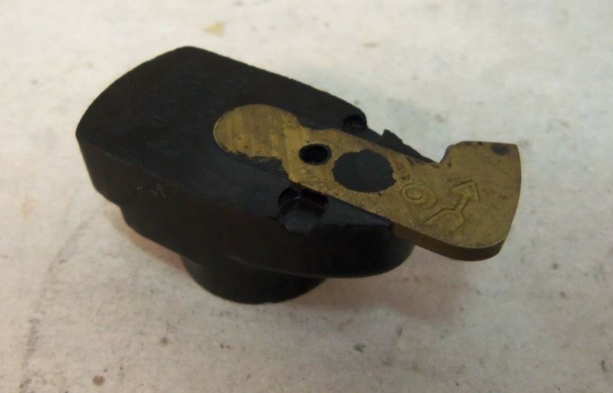

Some bad rotors out there with rivet that discharge to the shaft instead of the cap.
Genuine NOS Lucas ultrasonically welded rotor. Holden sells a reasonable facsimile
New.

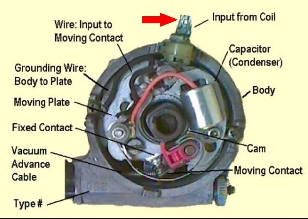

Rotate the engine until your points are open (on one of the lobes), disconnect the wire from the spade terminal on the side of the distributor, next take your multi metre and do a continuity test from the spade terminal arrowed in RED to ground _ there should be no continuity.
If there is, the braded wire inside the distributor is shorting or you have not mounted the points correctly with the plastic washers on its mounting stud.
Also check if there is continuity from where the coil hooks up to the spade terminal on the side of the distributor to the end of the terminal of the braded wire where it connects onto the mounting post.
Sometimes the braded wire may look like it's crimped into its terminals properly, but maybe not.
Without checking, I believe there is also a fibrous washer at the bottom of the mounting stud to keep the points return spring isolated from ground.
At any rate, if you perform my test in the first paragraph, that will tell you if you have things mounted correctly.
Other obvious things like making sure you have 12 volts to the coil with the key on, check with a test light or the voltage setting on your metre, just to make sure.
Make sure that ground wire is actually grounding the base plate and do a continuity test there.
Check that the braded wire from the spade terminal on the side of the distributor is not grounding out somewhere.
Current flows through the braded wire, through the closed points, saturating the coil with 12 volts, when the points open, that's when you get spark.
When the points open, the magnetic field in the coil collapses, inducing a voltage on the secondary windings creating spark at the plugs, depending on where the rotor is.
