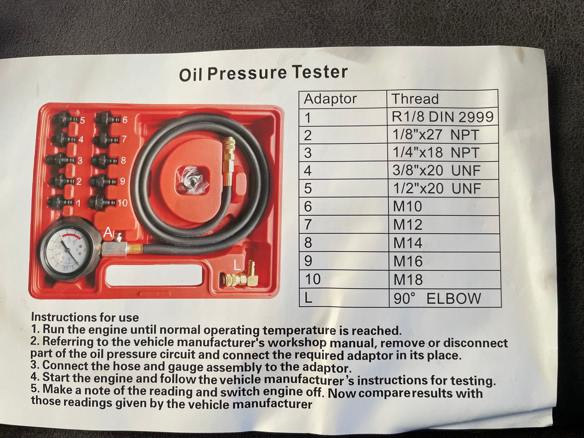

Just to continue this thread. I have the new sender from Barretts but have not fitted it yet. The oil gauge with this sender in is still running wild ie one minute zero then up to 60 then back to normal on a run. Not too bothered regarding oil pressure as I think it is either the gauge or the sender unit that are faulty. Before I fit the new sender I thought I would buy an oil pressure testing gauge. Arrived a couple of days ago and in the advert it states it has adapters to fit most applications. My question for now though is which adapter fits our oil sender unit. Comparing the thread patterns against the new unit going in it looks like 1/2" X 20 UNF is the closest thread on the adapters but is this the correct thread?
I have to wonder about the design of this tester though as it has a quick release system like you would find on an air line. Problem is the quick release system seal is on the end of the gauge hose not on the adapter? So if you release the gauge from the adapter that is screwed into the oil filter there is nothing to stop the oil (if the engine was running) from shooting out of the adapter all over the engine. Surely common sense would say that the end you want to seal is the end where the oil comes out under pressure not the dribble of oil that might be in the gauge. Can you imagine disconnecting an air line from a compressor with this same set up and having all the air from the compressor jetting out of the fitting whilst the hose you have disconnected is sealed. Does not make sense to me.

I think the sender thread will be BSP, probably 1/8 inch parallel. Unfortunately, BSP isn't in the list on your box. It's possible one of the ones in the box will be near enough. The best thing to do is compare the diameters and distance between threads on a sender with the fittings in the box to see if one matches. NPT is sometimes close. In case you don't know and to avoid (?) confusion, the size of a pipe thread relates to the nominal bore of the pipe the thread would be on the outside of. So a 1/8 inch BSP thread has a diameter of approximately 1/8 + 2 x wall thickness.

....however, as you mentioned 1/2 inch UNF looks close, then it's probably 1/4 inch BSP. Still check the threads per inch before forcing the UNF adapter into the hole. Sorry, for giving the wrong size before. My memory of what I'd used years ago must be failing.

Thanks for the suggestion Richard but the threads on the female side of that adapter do not equate to any of the adapters in the set I have. 3/8 UNF is fine but I have 20 TPI where as the EBay adapter is 24TPI.
I also need someone to confirm what thread is on the oil sender. Don't mind jamming 20 TPI in to 24TPI on the adapter but don't want to do that on the oil filter housing as it will bodge the thread up and I will not get the Oil pressure sender back in to sit tight. I see there are a lot of these adapters and they are relatively cheap so if I can get confirmation of the thread on the sender I could possibly find one to fit.

Cass, sorry my info is a bit confused, but it was shortly after my Dad bought the car that he and I were trying to attach a second pressure gauge to investigate the mystery of the disappearing oil pressure. I was still at school and the Beatles were still together and someone had lent us an industrial size bourdon gauge. The threads on the sender connection tappings were definitely BSP. The bolts on the side of the block that close the oil gallery, being bolts, will almost certainly be UNF and might well match one of the nipples of your test gauge. Using one of those will also allow simultaneous measurements from the car gauge and the test gauge.

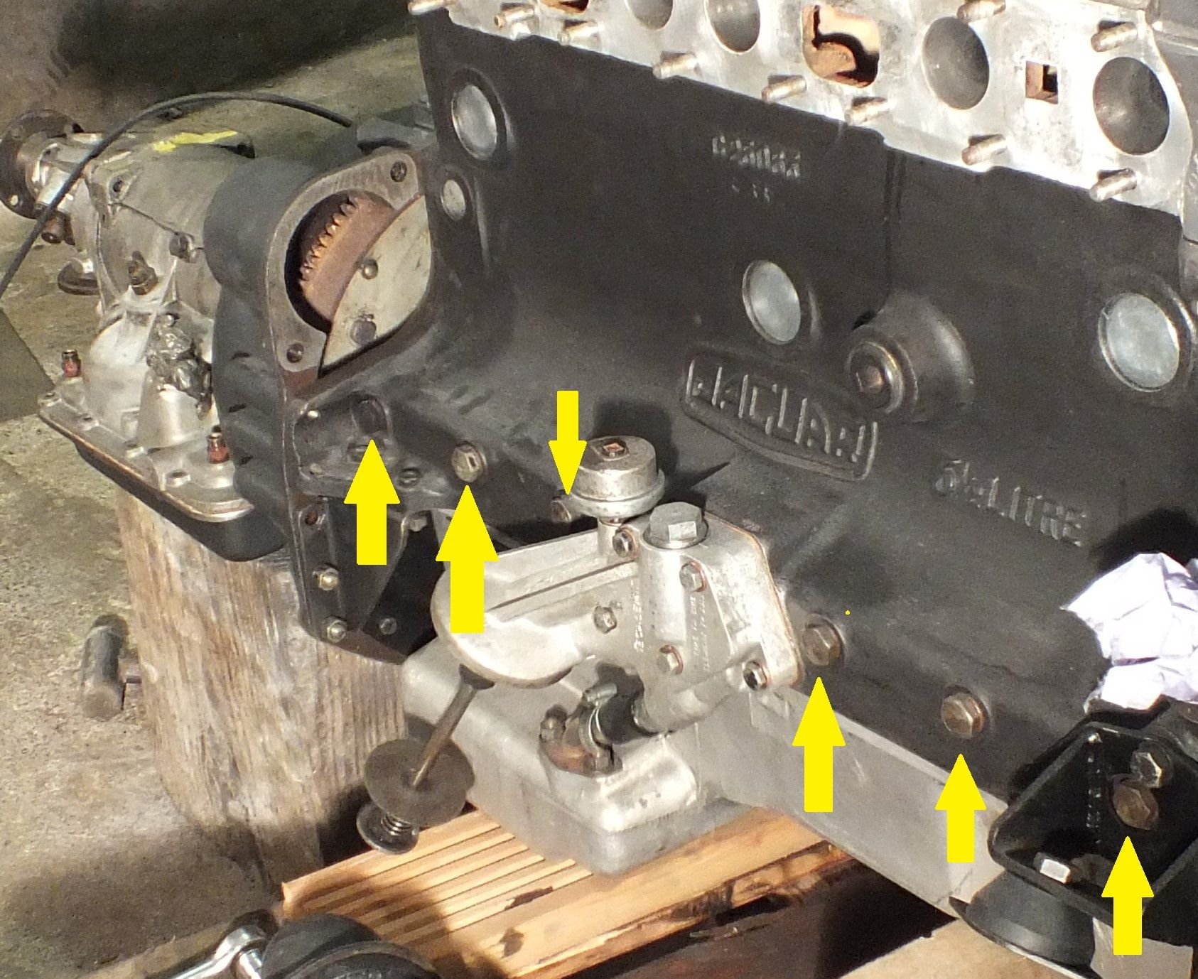

Thanks Pete as that is what I want to do. Have the test gauge running at the same time as the oil gauge on the dash so I can compare them. Are these the bolts you are talking about on the oil gallery. There are Six of the them.

Yes, those are the ones. If they are brass as in your photo, apart from access, it shouldn't be too difficult to remove one. I think these are where the block is drilled to take oil from the gallery to the main bearings. In view of that, it may be a good idea to clean the area before taking one of them out as it's not a good place to mainline some dirt. With a bit of luck, they will be half inch UNF.
Peter how dare you think I have a dirty engine. Clean as a whistle and no oil leaks. Not even from the gear box or the power steering.
Access might be a problem but no worse than getting to the Oil pressure sensor itself.

Well, you know a tiny speck of dried Brasso might just have been caught on the ledge above the gallery. And I didn't intend to judge you by my low standards. I had thought of looking at my engine to check the size of the bolt heads, but realised how much oily mud I'd have to shift ... .
