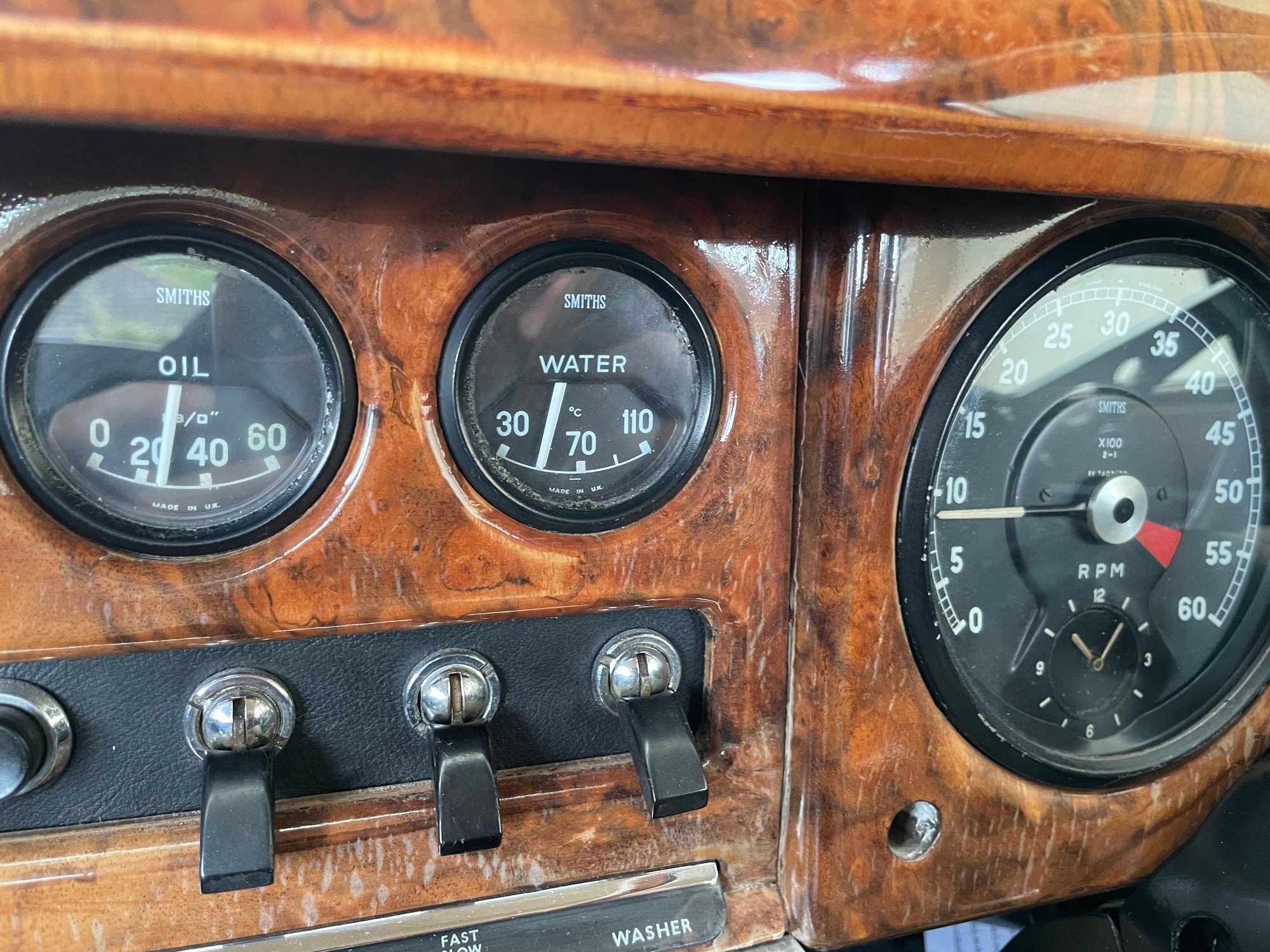

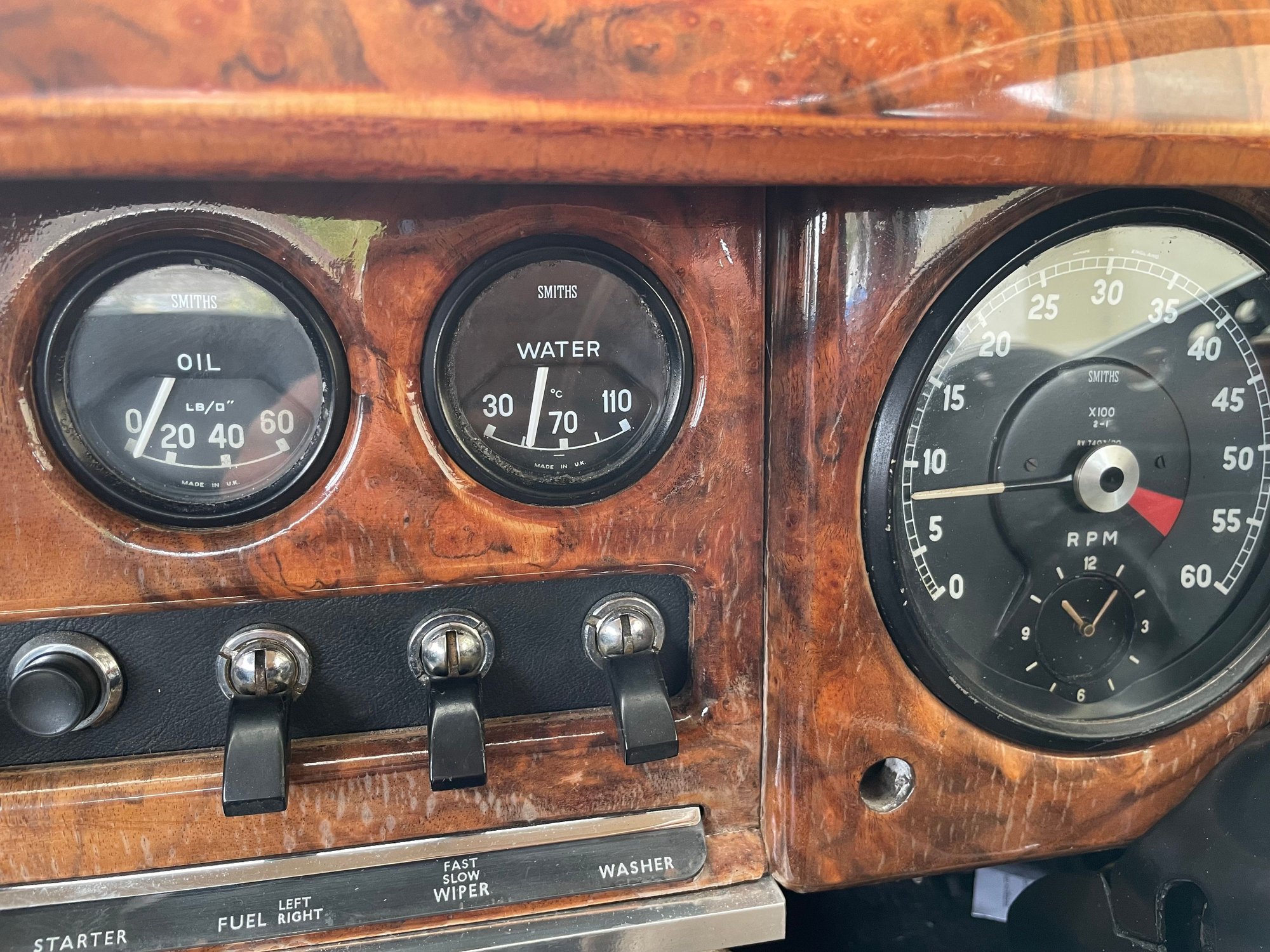

A bit disconcerting but recently I had a massive drop in oil pressure. From a normal running PSI of around 40 it dropped to below 20 at 3000 rpm and whilst sat at traffic lights it dropped from a normal 20 to zero.
Zero psi on tick over
Less than 20 psi at 3000 rpm.
Now I checked by looking in the oil cap that I had oil at the top of the engine on tick over so I was not that concerned. I had no oil leaks so it had to be either the gauge, sender or something blocking the pressure relief valve.

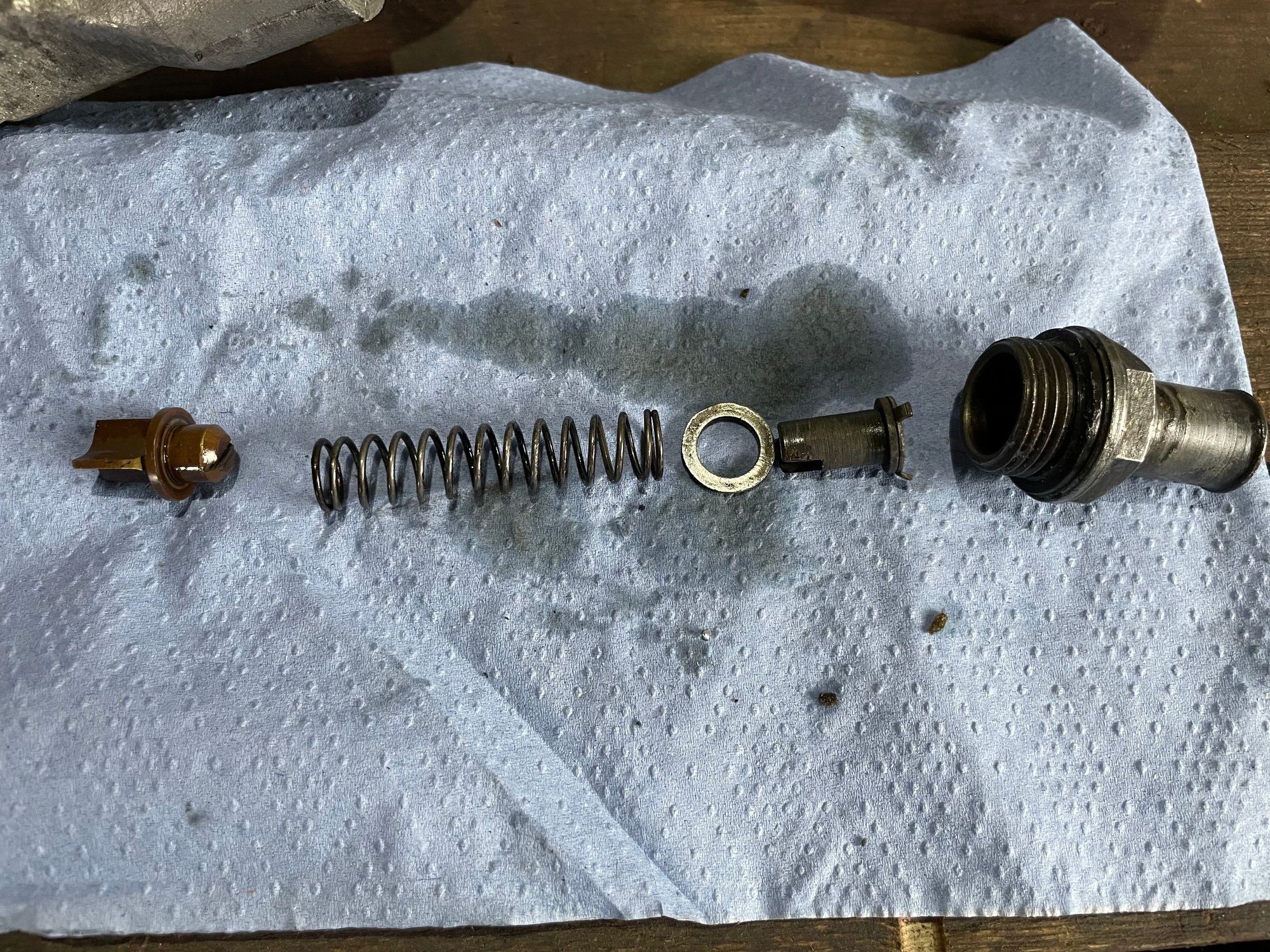

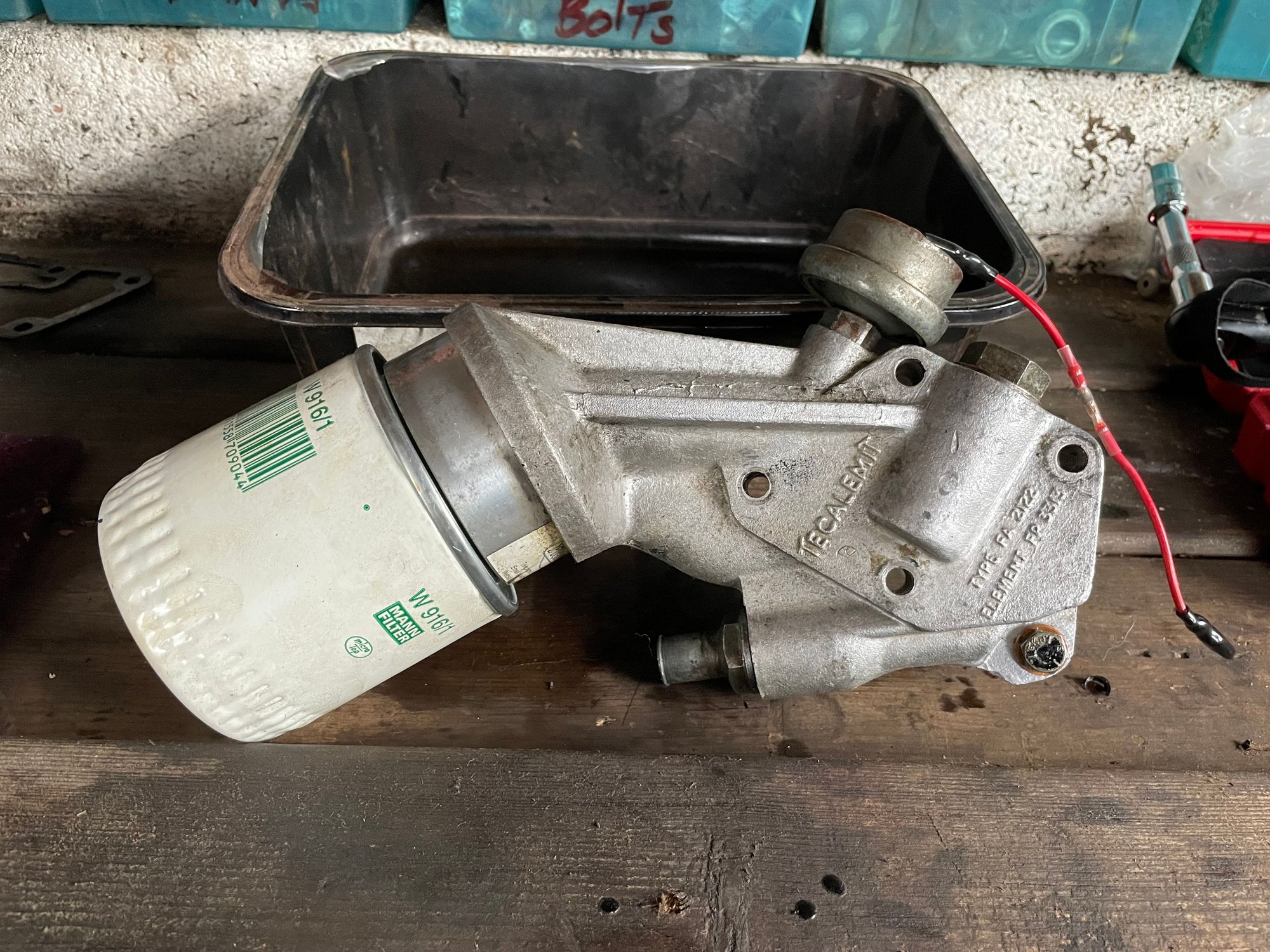

Last week I bit the bullet and got under the car and removed the oil filter housing from the side of the engine. Not a difficult job other than access to the five ½ bolts. Once the bolts were out (you have to leave the bottom front bolt in situ as it fouls on the steering box) a screw driver to release the jubilee clip on the bypass hose and the housing slides out. On the bench the housing was checked, the pressure release valve was stripped and cleaned and there was nothing obviously wrong with it.
Oil filter housing with screw on filter modification.
Oil pressure relief valve.
The housing was refitted (not forgetting to insert the lower front bolt first before offering it up) and everything tightened. Checked the oil pressure and it was still showing no pressure.

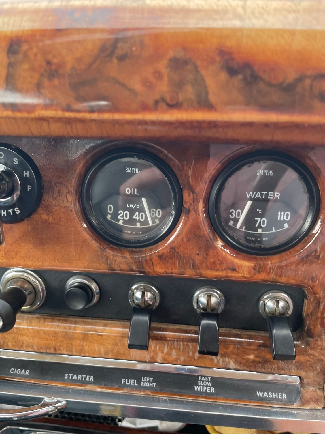

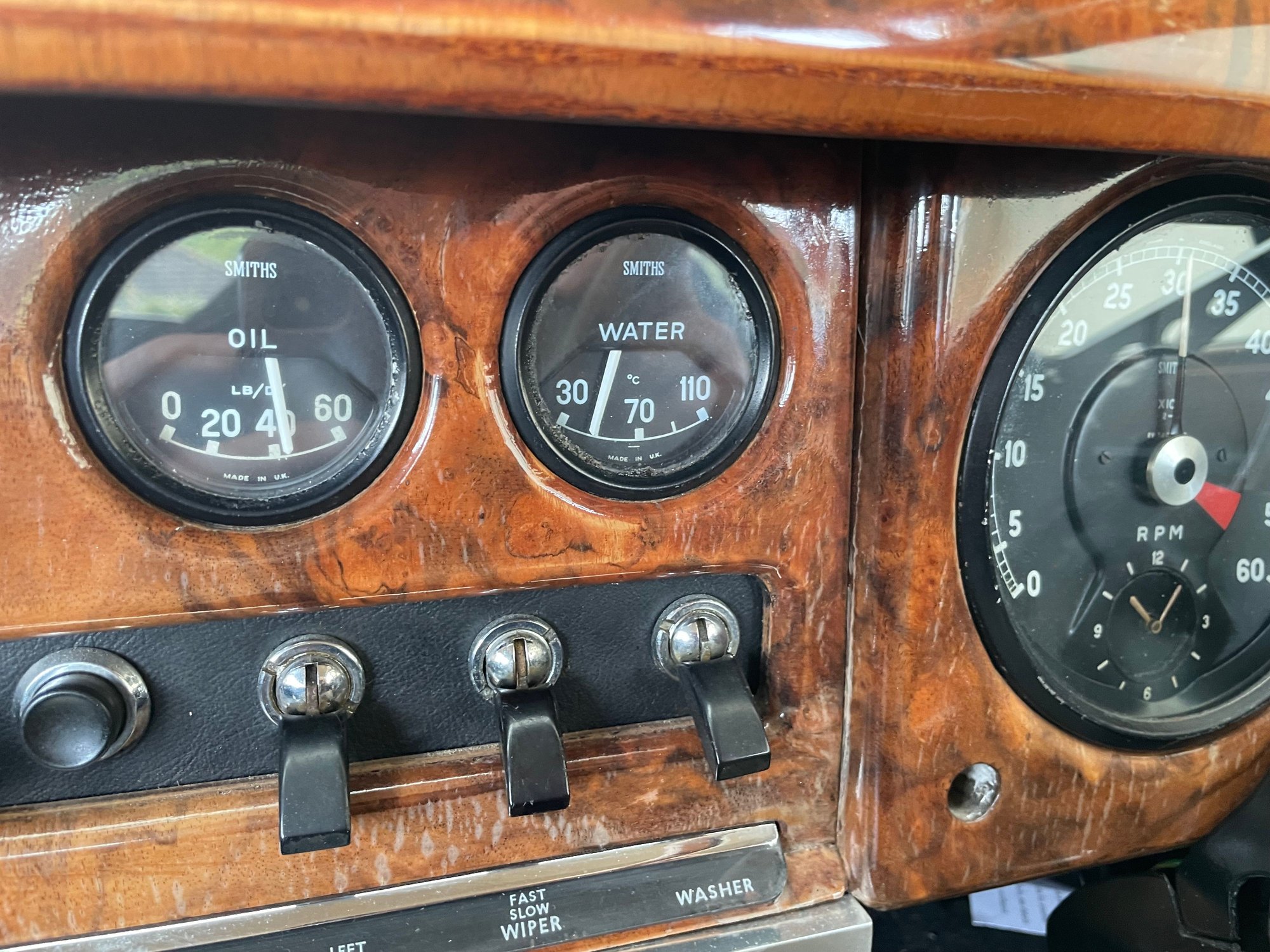

OK next was the oil pressure sender. Not a cheap part as they are nearly £90 at SNG which is why I went for the pressure release valve first, but I bit the bullet and ordered a new one. It arrived today and although again it is difficult to get to, an 18mm spanner with one arm down the front of the carbs and the other down the back and I was able to release the old and fit the new. Started up the engine and Hey Presto, oil pressure back up to 25 psi on tick over and over 40 at 3000 rpm.
Naughty old Oil pressure sender telling me lies.
25 psi at tick over
Over 40 psi at 3000 rpm.

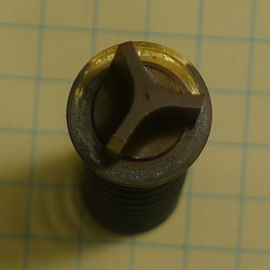

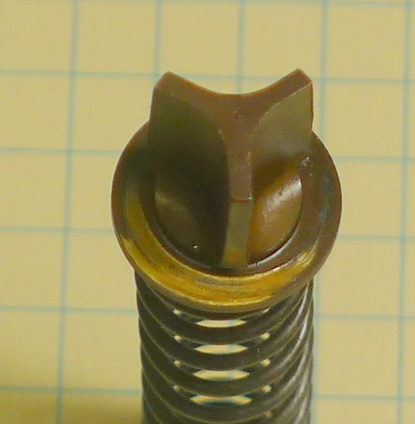

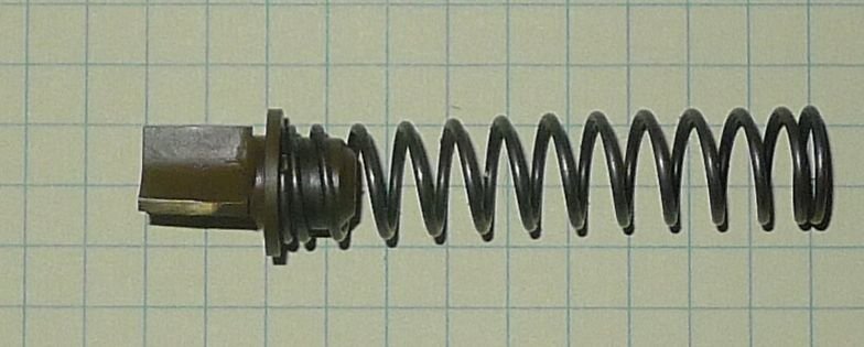

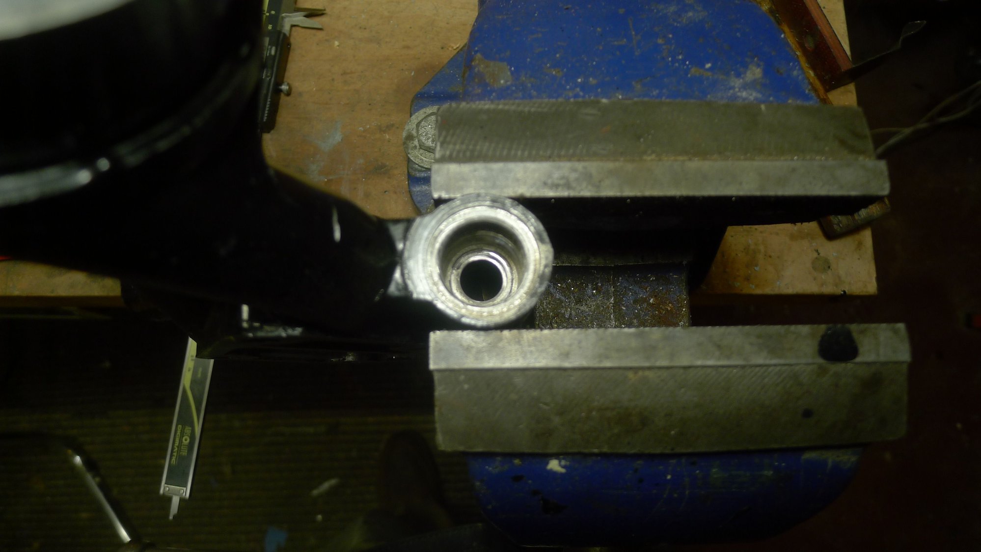

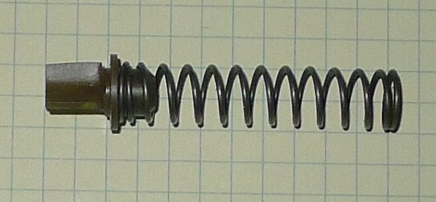

Three years ago I experienced a drop in oil pressure that turned out to be due to wear of the pressure relief valve. The flutes on the valve wore such that the sealing face did not sit evenly on the mating face.
I wrote up a memo and took some pictures in case anyone was interested.
They are attached
Bruce
Face uneven wear
Uneven wear
Wear on flute face
Wear on housing face

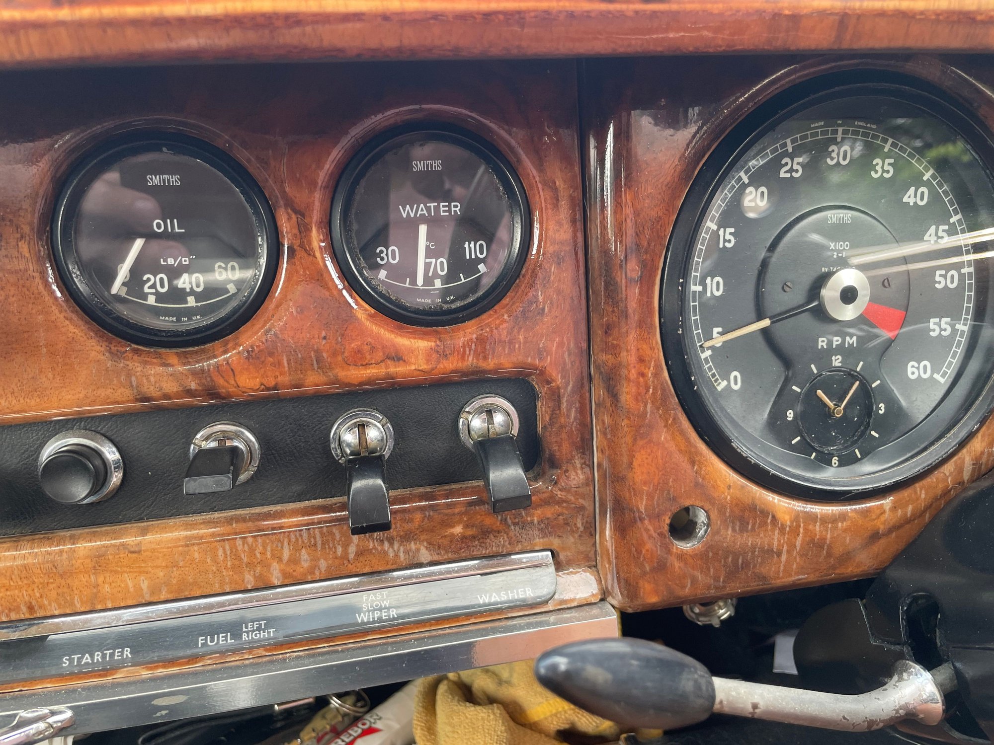

Quick up date.
The oil pressure sender that SNG sent me and was fitted is now playing up. Driving along happily with the gauge showing 40 psi then suddenly it goes all the way to the top of the gauge, 60 psi, where is stays for a couple of mins before dropping back to zero then back to normal at 40 psi. Could be the gauge but I contacted SNG who have sent out a new sender which should be here tomorrow. I have to send the old one back for testing but if this new one plays up at least I should know if it is the gauge or not. I am in the middle of refurbing a spare gauge so if I have further troubles I will swap the gauges over.
