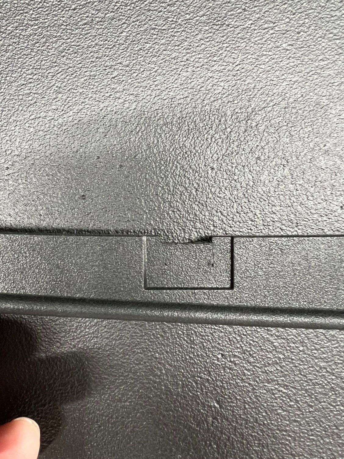

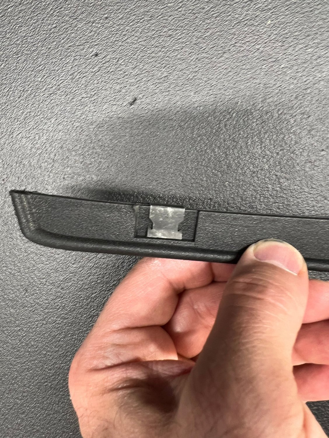

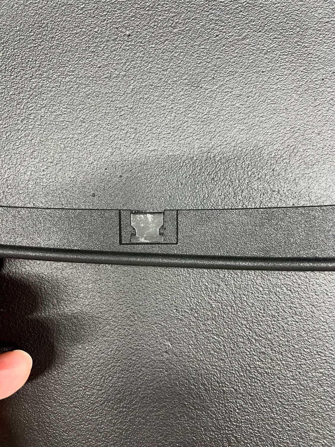

(1) In MY experience I found that there was some advantage in slightly cutting/modifying the locations on the slat where the clips are going:
My first install attempt proved to be frustrating for some of the clips. It seemed that, for whatever the reason, the clips were not always able to seat well in all cases. I realized that there was some advantage in cutting into the slats a bit carefully with a knife to allow the clips to go a bit deeper, and then this seemed to correct the problem I was having. I found that as long as the bottom of the clip was able to reach the bottom of the little rectangular notches on the slats then this improved the seating (at least in my case).
For example, the first pic immediately below shows the top-most clip notch on the slat. I found that without cutting at all the clip could reach the bottom of the notch (second pic immediately below), and it was fine. In the case of the second slat clip notch down from the top of the slat, however, I had to trim into the notch with a knife (3rd pic immediately below) to enable the clip to reach the bottom of the notch (4th pic immediately below). I found that I had to trim all the notches on the slats except for the ones at the very top of them.
NOTE: You don't necessarily need to do this trimming like I have done, as I haven't heard of anyone else needing to? But keep this method in mind if you end up running into trouble in your case too. This should help you out, make you not want to murder someone, etc... ;-)

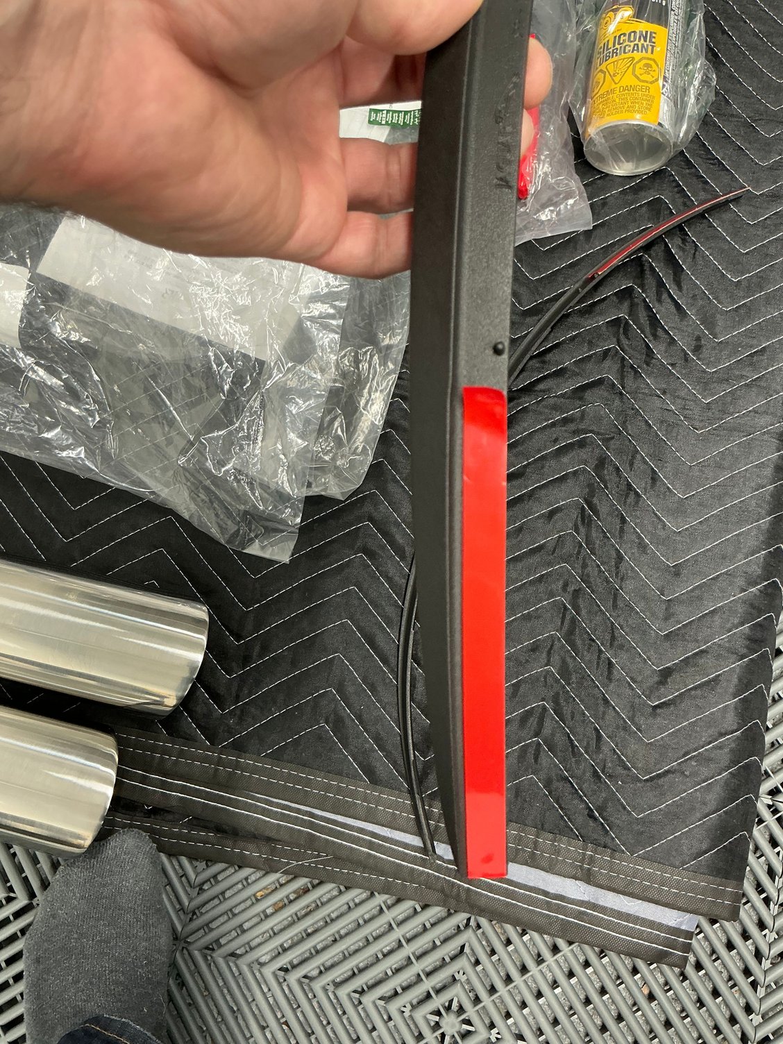

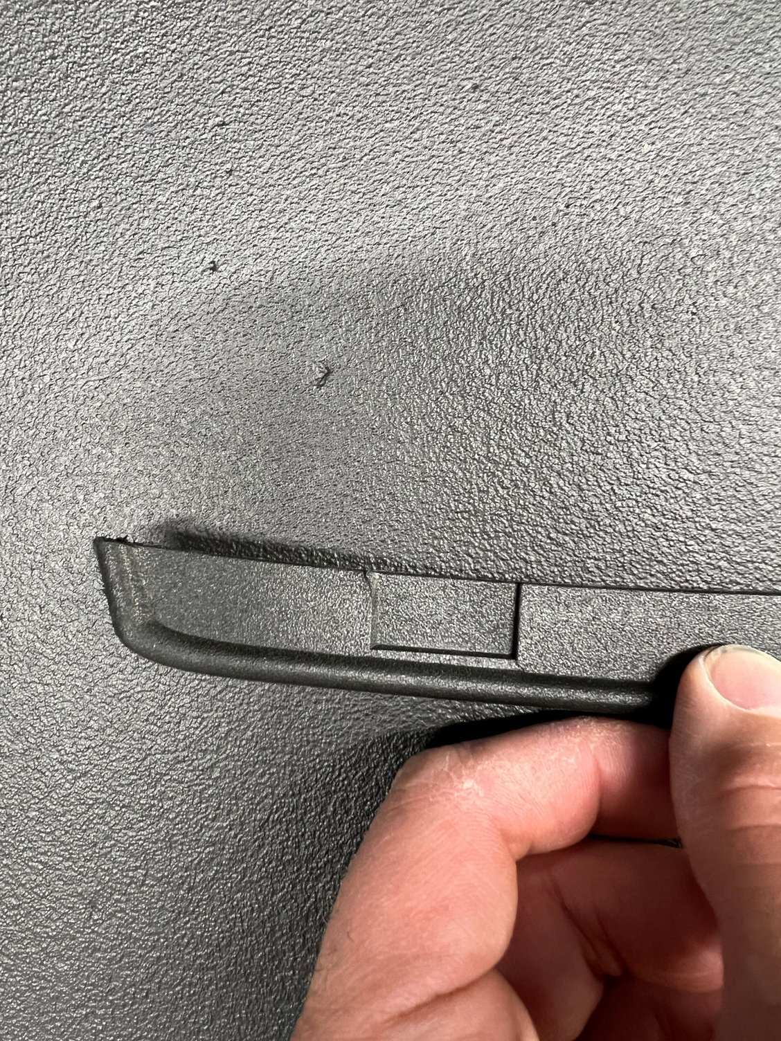

(2) Carefully and cleanly cut the 2 tabs off of each slat (i.e.: That are located adjacent to the tape that came on the slat towards the bottom):
Those tabs are for the XKR and are just in the way in the case of the F-Type. The pic immediately below shows one of my slats with those 2 tabs clipped off...

(4) Added additional 3M Auto Exterior Attachment Tape to the slats:
Again, not everyone is doing this, but I felt I needed to (mainly because of my PPF situation, and the slickness of it). This tape is readily available on Amazon.
IMPORTANT NOTE: I ended up putting completely fresh tape the entire length of the slat. If at all possible I would NOT remove the original 3M tape that was on the slat at the bottom, and then only run your other tape in the other areas. My first attempt at installing didn't go well, and I ended up compromising the original tape at the bottom of the slat a bit. So, in the moment I had the not so great idea of trying to remove the original tape. Yeah, again, don't if possible. That was brutal trying to get that off. An absolute mess to be frank. Even if you mess up a bit your first install, and damage the tape a bit, it will still be sticky enough combined with the clips. Seriously, save yourself A LOT of trouble by NOT removing that original tape. Did I mention that it is a REALLY BAD IDEA to remove the original 3M tape that came on the slat? ;-) Lol, seriously, I'm still traumatized.
If you end up adding this extra tape like I have, run it the length of the slat, EXCEPT for on the 1/2 to 3/4 inches of area at the very top of the slat. I also inset the tape from the outside ridge of slat ever so slightly, approx 1/8 inch in or so (i.e.: Just as was the case with the tape that came on the slat at the bottom).

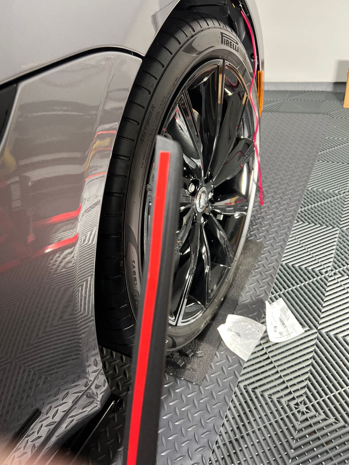

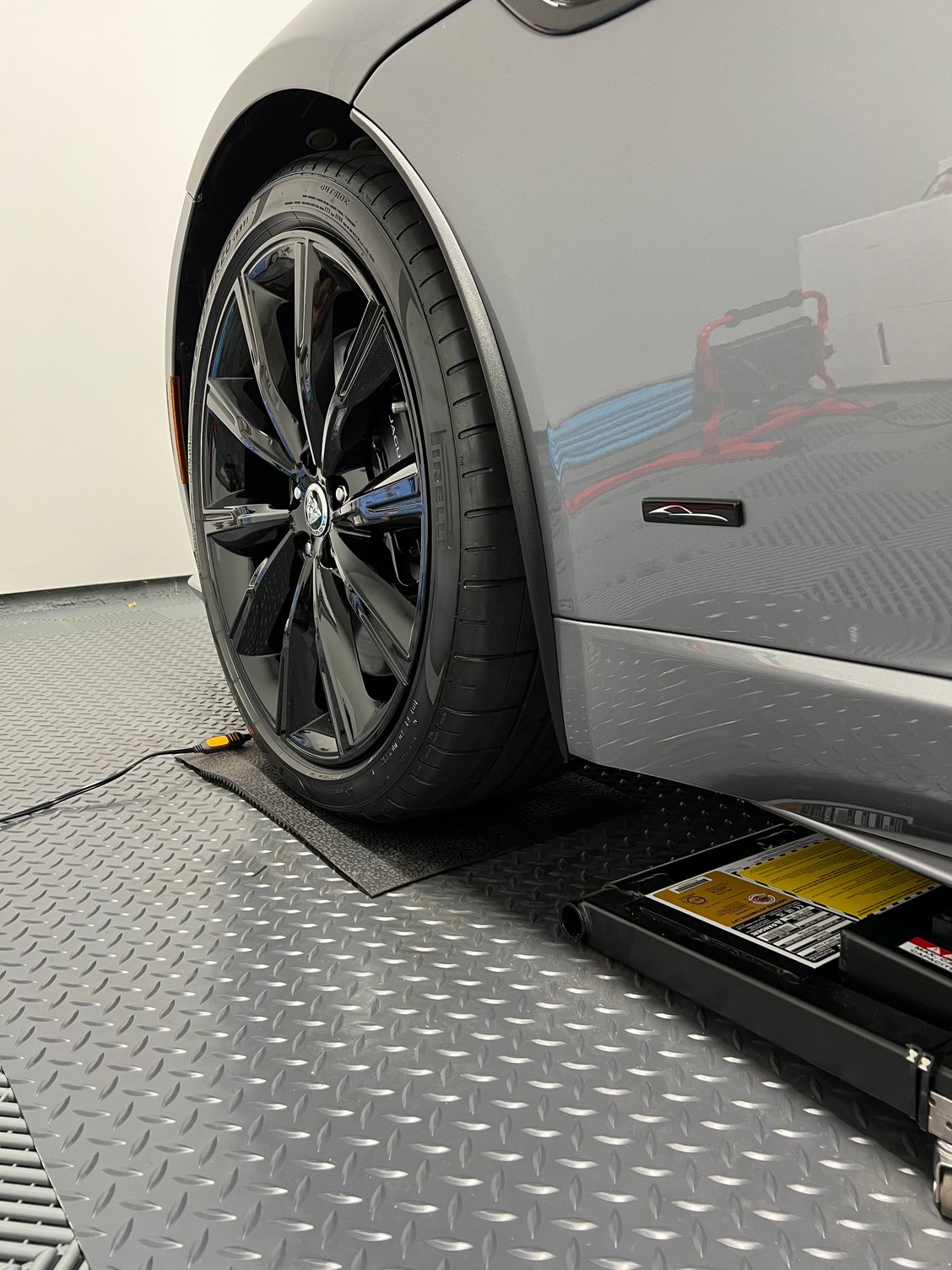

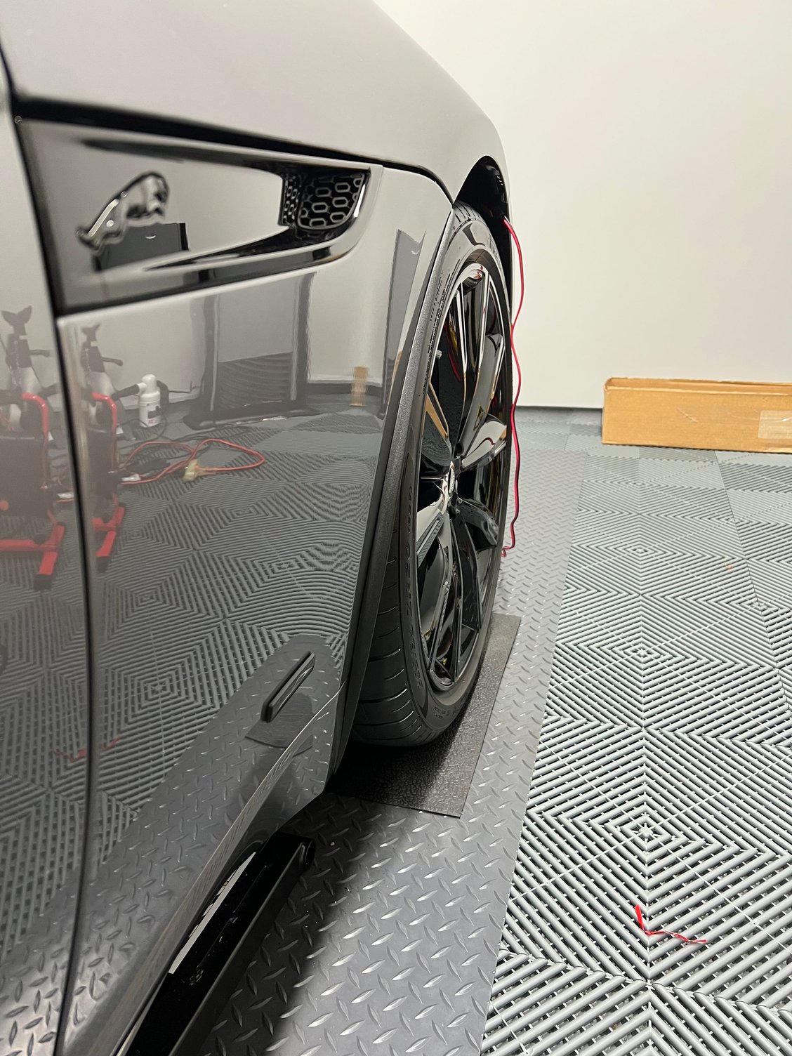

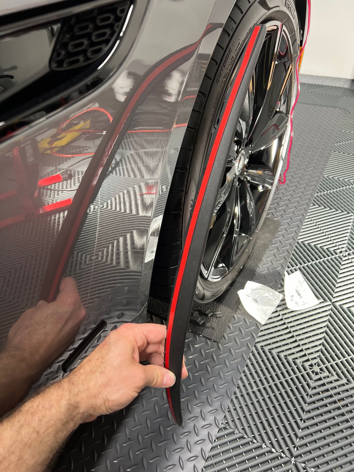

(5) Install slat:
As some tips, the way I did it was -->
- I removed the backing for the tape the entire length of the slat all at one time (first thing).
- Then I carefully started at the top of the slat, affixing the starting point where I wanted it, and then worked my way down to the 4th clip location (pushing the tape on as I went). I stopped affixing the tape once I got to the area around the 4th clip location, leaving the tape around the bottom 2 clip locations just hanging there (not pushing it on yet).
- I then went back over the area for the tape I affixed so far and pressed all over really well for 30 to 60 seconds, before then installing the first 4 clips from the top downward.
- Once those top 4 clips were installed I then proceeded to seat the remaining unseated tape at the bottom of the slat, pressing for 30 to 60 seconds there as well, and then installing the 2 remaining clips.
You're done! It probably wouldn't hurt to press over the tape a few times at the end just to make sure. I did anyway. Rinse and repeat for the other side of the car and you're good.

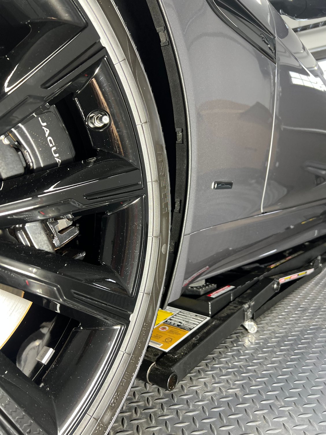

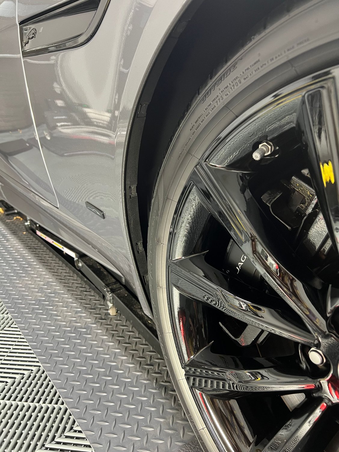

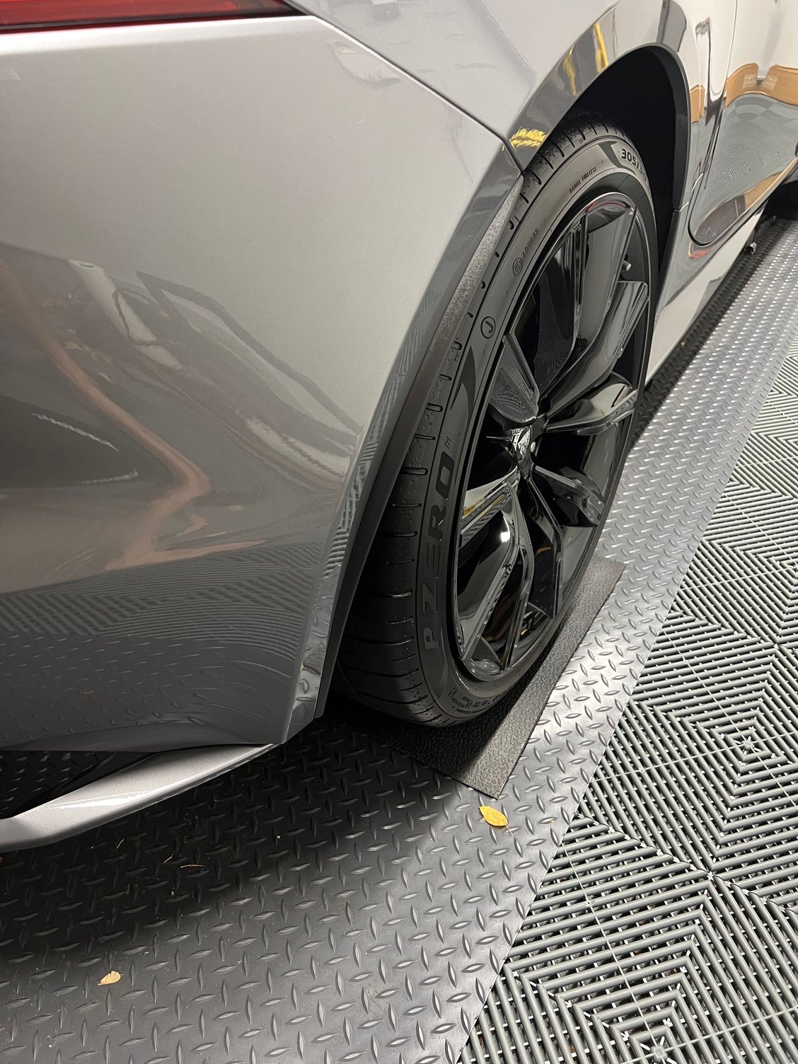

OF NOTE: With the way I wanted the top of the slat aligned, it end up leaving about a 1/2 inch or so of slat going below the bottom of the car. Oddly enough, it really doesn't look all that bad or out of place like that. I'm still deciding whether or not I will take a sharp knife and trim that off. I will decided later. Just wanted to mention this.

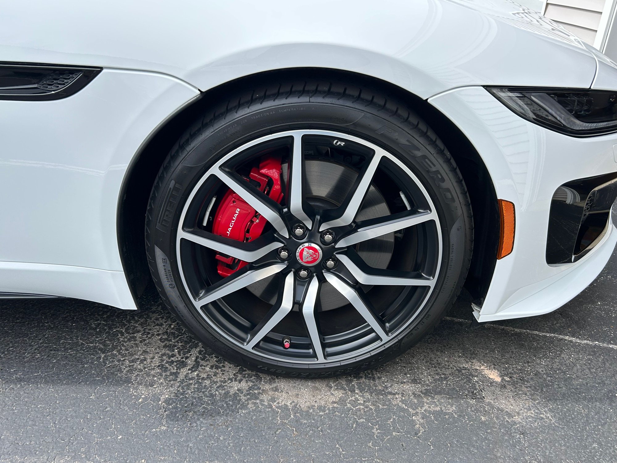

That's about it...I still think I prefer the look of not having the slats at the front of the car, but really, they looked fairly good installed. Definitely does not look bad, and the added protection they will provide is definitely welcomed.

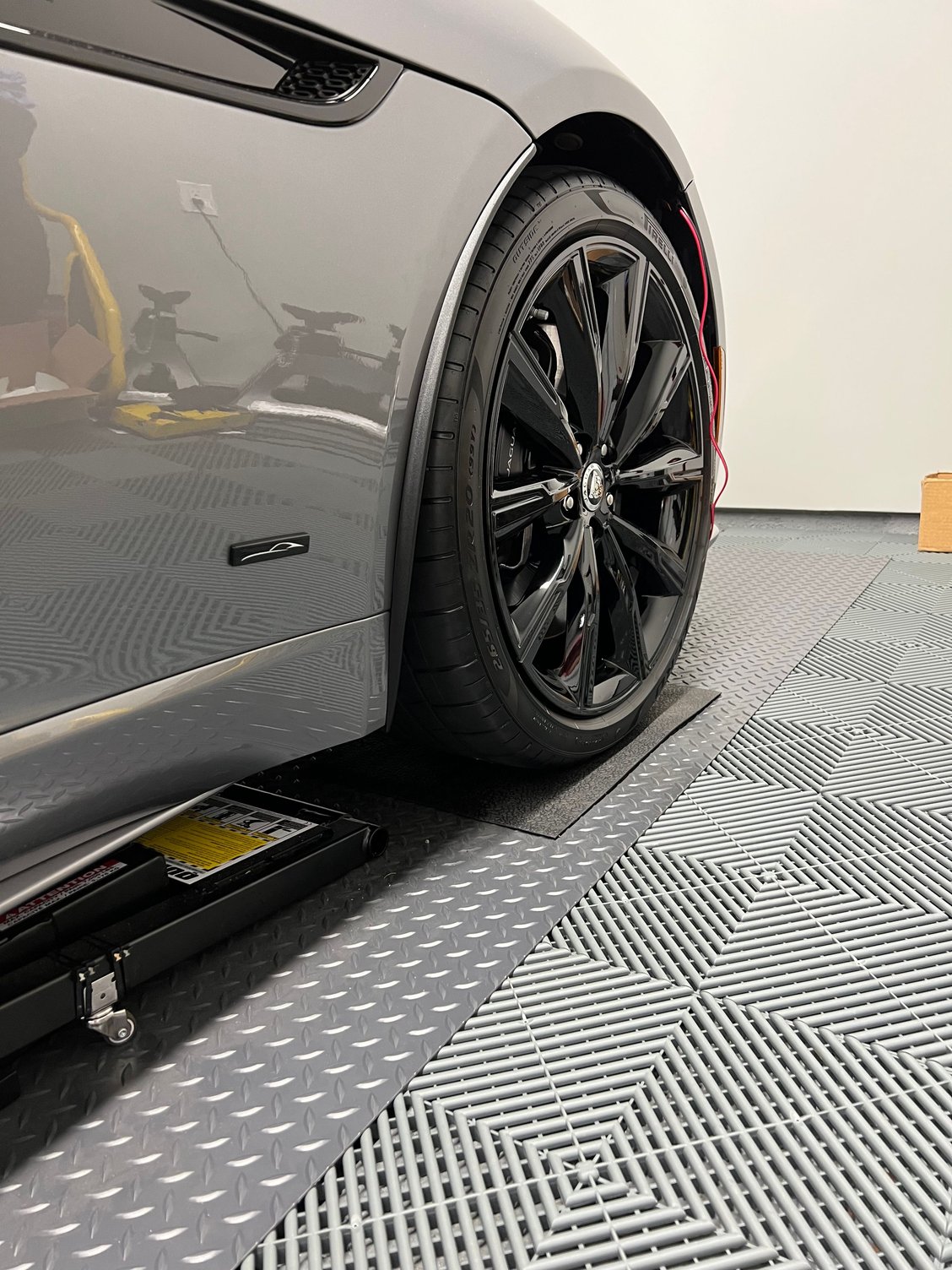

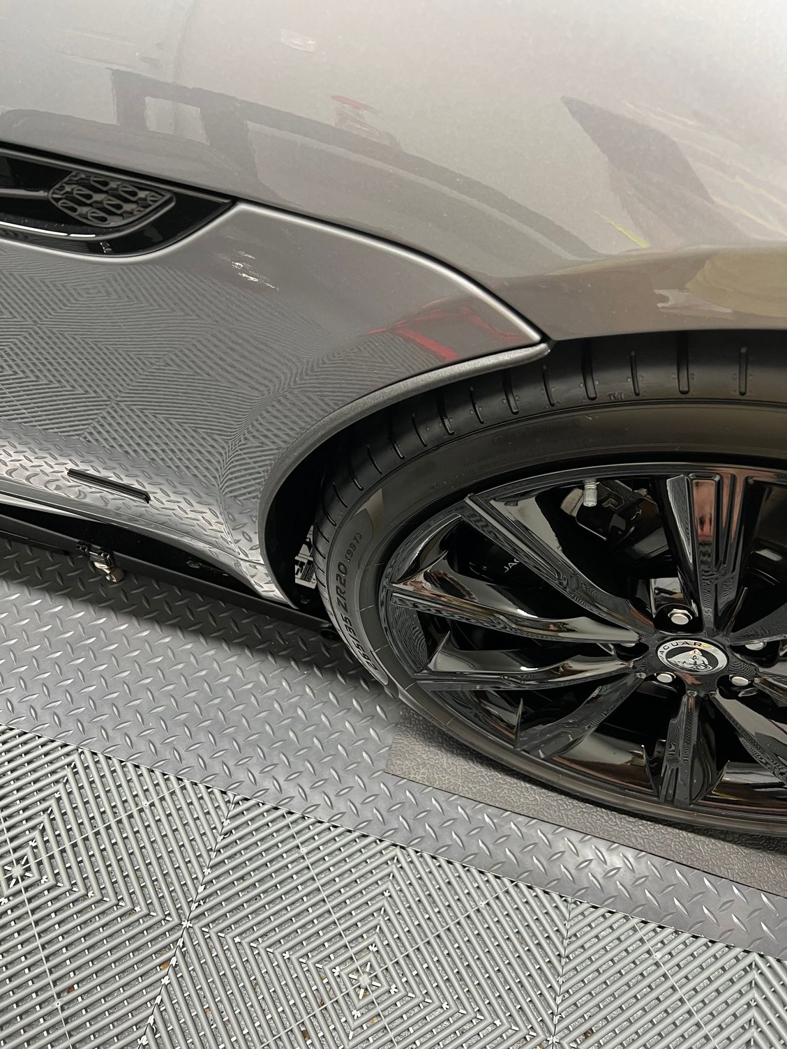

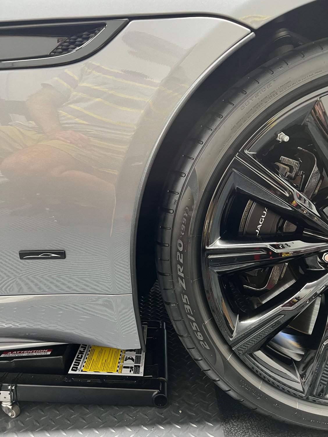

Here's a pick of the stock slat at the rear of the car (If feel the installed front one matches quite well) -->

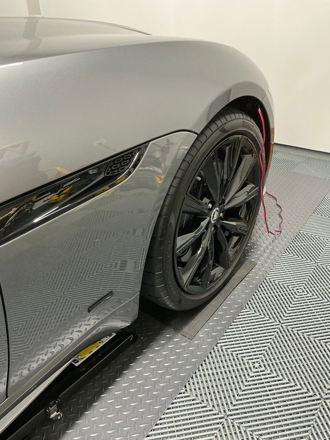

And here's a pic of the front wheel well before the work -->

Alright, well, I did the driver side this morning. I must say, at first I felt like I would miss the stock look without them on the front, but oddly my eye has really come to like them. They just look so cohesive with the stock rear ones, so they basically almost look like they were on there from factory.
Anyway, definitely recommend this "upgrade". Not a bad look overall, and they should definitely protect your pride and joy from a few more rocks. There's no doubt.
The only thing I have left to do is take that 1/2 of slat below the car off, but I will wait until I have better access with the wheels off, when it's up on my lift, etc...Don't want to mess that up ;-)
FINAL THING I WOULD SAY: My opinion only, but I actually feel that extra step I took cutting into the clip locations to seat the clips better (see above) also had the added effect of almost making the clips look more purposefully installed. It almost gives the illusion that the part came like that purposefully or something. When I cut them into the material I carefully made sure the cuts were done in the middle of the clips notches on the slat. That make the final product almost look like those are the manufactured specific location for the clips on the part if you will etc...If that makes any sense.
