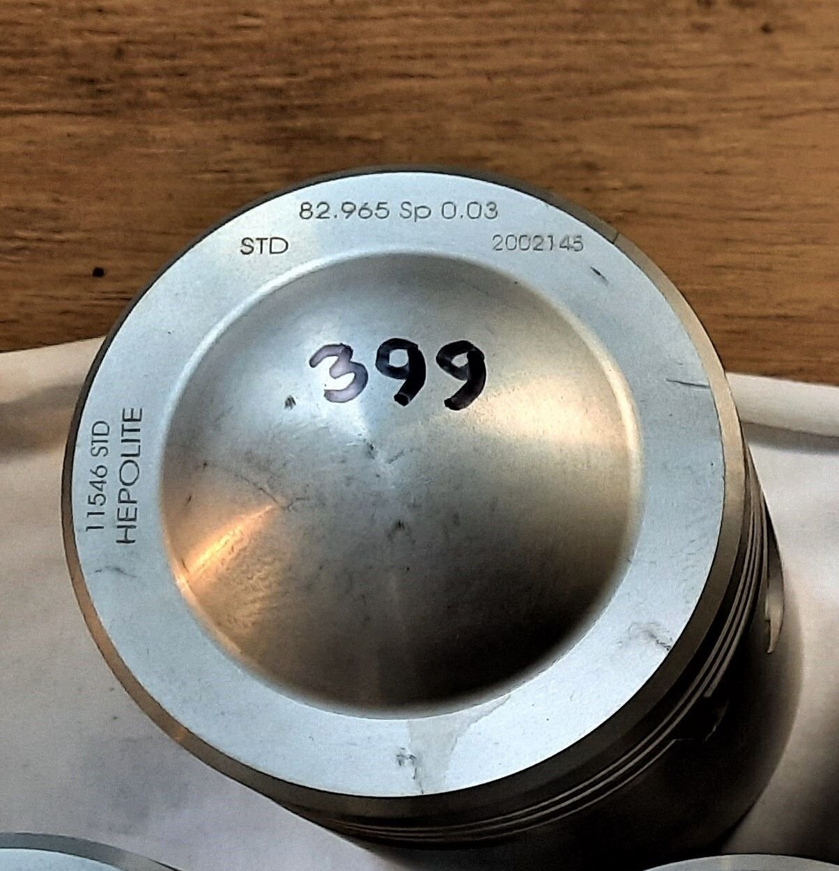

Hi Glyn,
All new HEPOLITE automotive pistons have the piston size and minimum clearance marked on the piston crown. The clearance is the "SP" number, in this case it is 0.03mm
Kind regards,
Paul
info@marmotorsport.com
3.4 piston marking example, could not find a 3.8 ~ excuse weight matching scriblings by a chap at Jag-lovers.
On Mon, 20 Sept 2021 at 14:00, Glyn M Ruck <gmruck@lantic.net> wrote:

Old Sep 21, 2021 | 05:14 AM
  #29
Glyn M Ruck's Avatar
Posts: 5,546
Likes: 1,495
See Hepolite piston example image added above.
