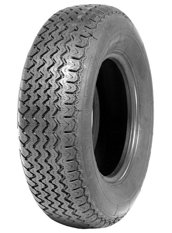

Peter this is the photo of 185 X 15's that you are likely referring to. It should however be noted that none of these are mounted or inflated to equal pressure. All fitted to classic Jags OE at some time ~ The monster 2nd Right was under the old British cross-ply rating e.g. 640 X 15. It's a Dunlop RS 5. Tyre 2nd to Left is a Dunlop SP41 or SP73 dependent on market. It was known as an SP73 in SA as an example. Cross ply tyres ran at lower pressures than Radials where max 40 psi was dictated by Jaguar & the tyre manufacturers. ~ Source of picture, the UK E Type forum.
I'm sure you recognise them left to right. Michelin, Dunlop, Good Year, Pirelli, Avon, Dunlop, Michelin.
Sorry to admit an error on my behalf 3rd from left is also a Michelin. Tread pattern similar to that preceding the Good Year Grand Prix. It even has Bibendum on it SMH. Silly mistake. Jaguar predominantly fitted Dunlop RS 5 (X-ply whitewall US market) & SP41 OE to sedans. E Type saw more Pirelli & Michelin.

Still, the point remains that the radials look significantly different. It's hard to imagine that, even after inflation, they will have the same rolling radii and footprints.
