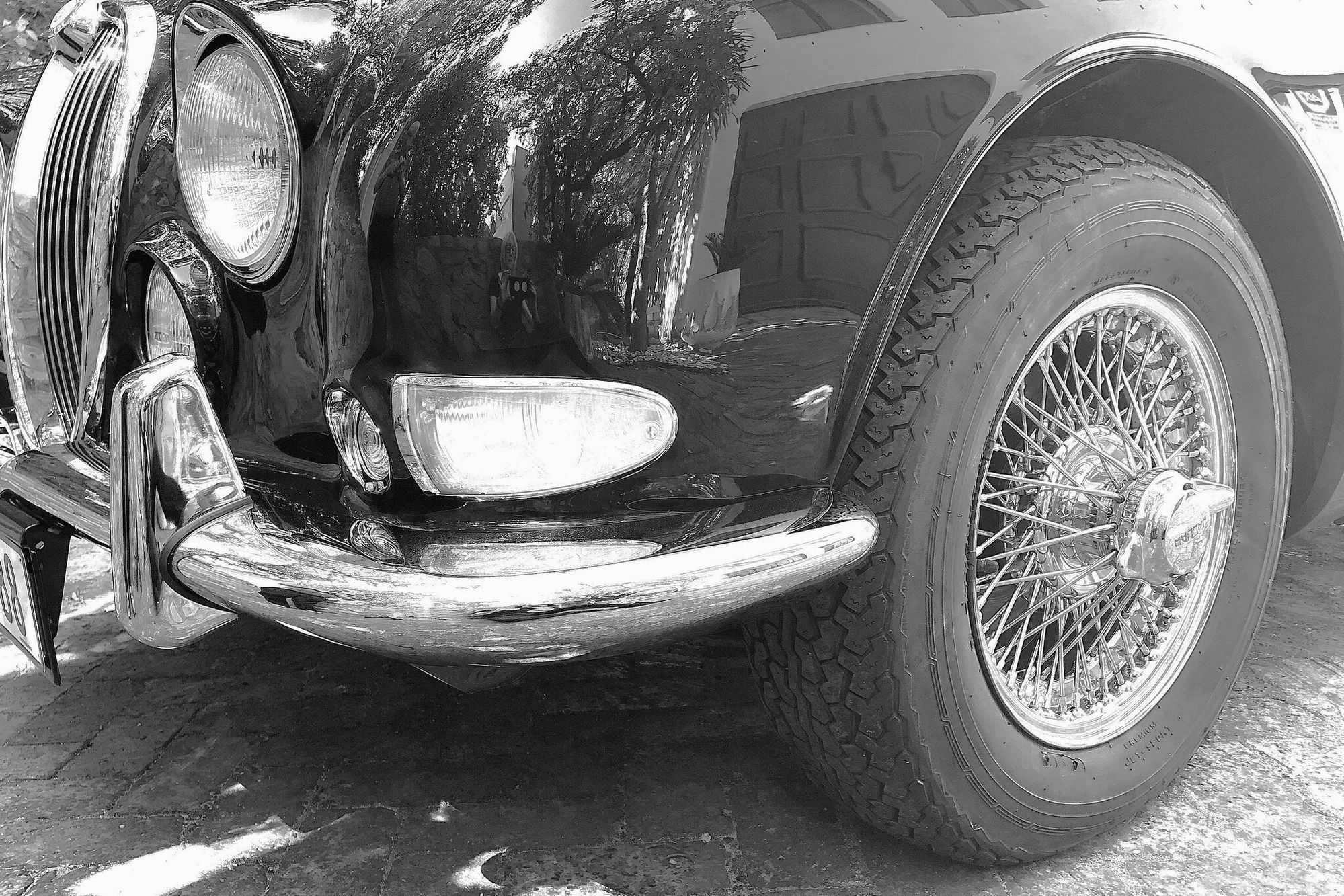

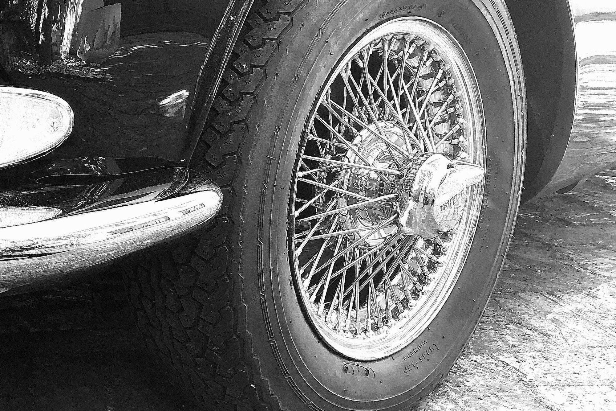

EDIT ~ The last time I checked Longstone Tyres UK have plenty of stock, I'm fitting 185 HR 15 Michelin XVS-P to my car to replace the 20 year old new Generals now fitted. I don't trust them. Another benefit of the Michelins is that they have substantial rim protection built in and are latest carcass construction..
Playing around in black & white on my camera.
Correct Michelin.

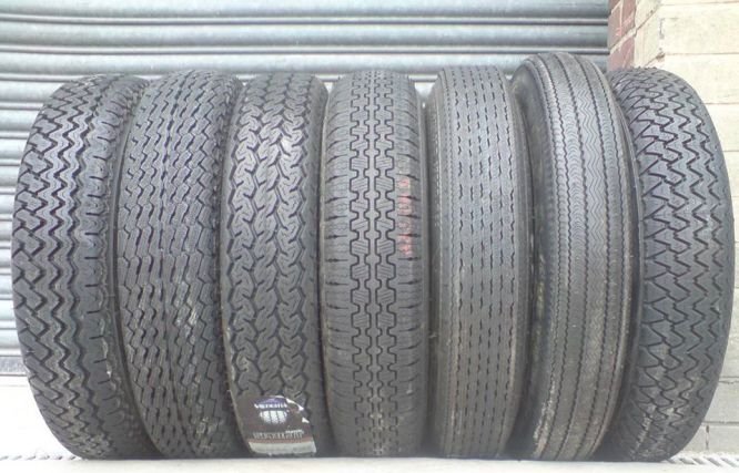

Originally Posted by Peter3442
... and if we recall the last time we discussed tyre sizes, Glyn found the photo (from Lonstone?) that made it clear that some of the numbers on the sidewall are a touch 'nominal.'
Fine were definitely not good for American cars.
Peter this is the photo of 185 X 15's that you are likely referring to. It should however be noted that none of these are mounted or inflated to equal pressure. All fitted to classic Jags OE at some time ~ The monster 2nd Right was under the old British cross-ply rating e.g. 640 X 15. It's a Dunlop RS 5. Tyre 2nd to Left is a Dunlop SP41 or SP73 dependent on market. It was known as an SP73 in SA as an example. Cross ply tyres ran at lower pressures than Radials where max 40 psi was dictated by Jaguar & the tyre manufacturers. ~ Source of picture, the UK E Type forum.
I'm sure you recognise them left to right. Michelin, Dunlop, Good Year, Pirelli, Avon, Dunlop, Michelin.
