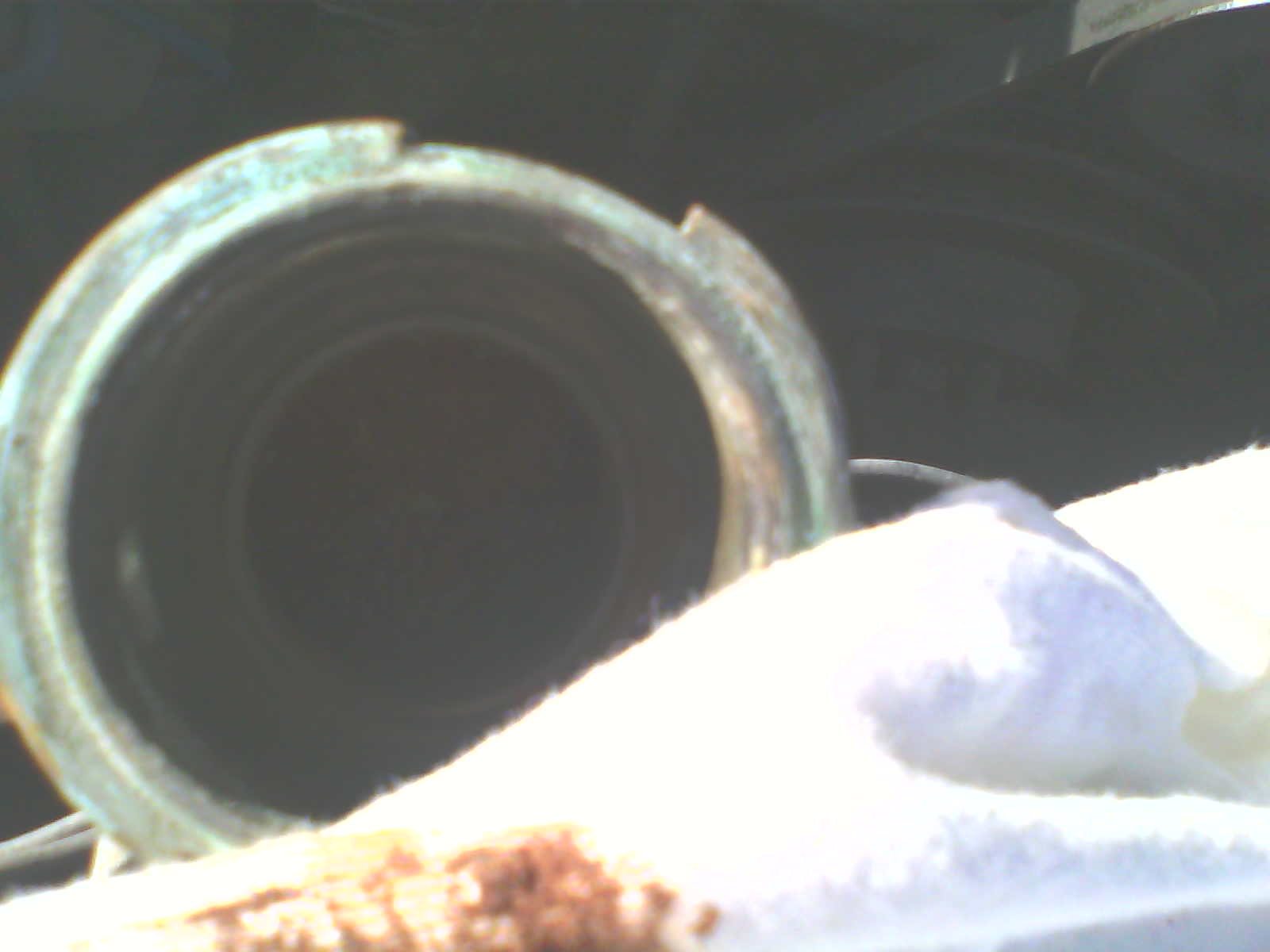

The radiator HAD water in it, but it appears to have evaporated. Now there are bits of rust inside the neck of the radiator. I wiped out a sample. (pic)
I suspect there is more rust in the radiator and probably in the engine block. So before I start the engine and run a chemical flush through the system, this is what I thought of doing....

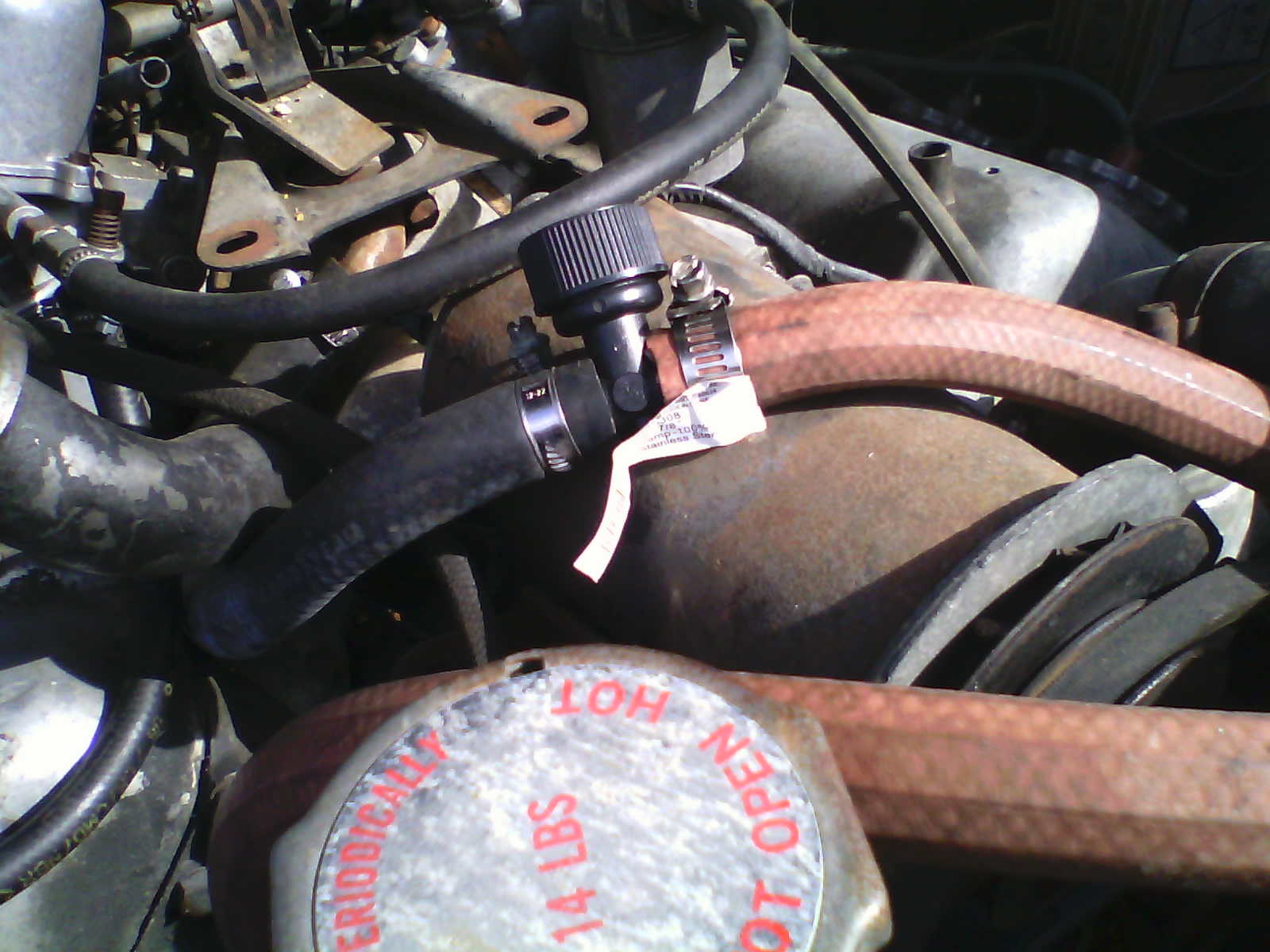

I went out and bought CLR. The directions on the container state not to use on aluminum. A quick magnet test on the radiator suggests it is made of aluminum. So using CLR is probably out.
Last night, I removed both the upper and lower radiator hoses.
I flushed out the radiator with a garden hose.
Lots of rust and crud, but eventually it ran clear.
Then I clogged each the hoses with old t-shirts and reattached the hoses.
Now it's a clogged system.
I was going to fill with a diluted CLR mixture and let sit for about five minutes and flush again, but have reconsidered.
Thoughts and opinions...
Or I was thinking of using Prestone radiator flush and letting it sit.
I want to clear out the radiator BEFORE the reverse flush.
( Bought the kit for $3.53 )

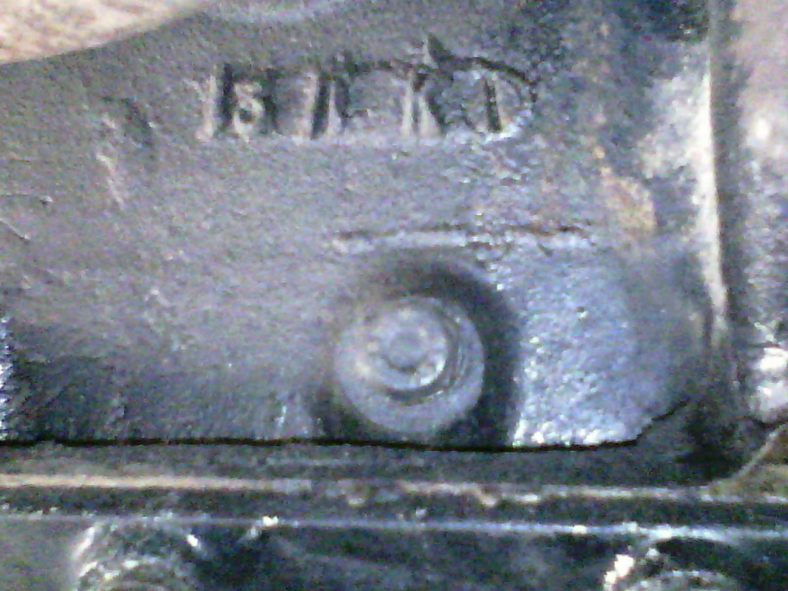

BTW, where is the drain spigot/plug under the engine?
I ooked in and around the exhaust manifold and cannot find it. Then I went to a guy who had one some 30 years ago, and he said it will be like a radiator drain **** where all I have to do is twist to drain.
Looking but cannot find it ....
the block drain spigot looks like the picture below, usually silver in color.
it would be located behind the exhaust manifolds in the 3.4, 3.8, and 4.2 liter Jaguar XK engines, but if the engine is the 2.5 liter V8, I don't know where it might be or even if it has it.
The Daimler V8 does not have the taps described by Jose. There are two drain plugs near the front of the engine with hexagonal headed bungs in place. I don't remember the size. But they are easily accessed from underneath at the front of the engine. The radiator does have the drain tap operated by the remote arm from the top of the radiator.
I'm looking for these darin plugs. I jacked up the car, and I found these, both on each sde of the engine. Are these the drain plugs?
I'd say the radiator is copper and not aluminium, if its original

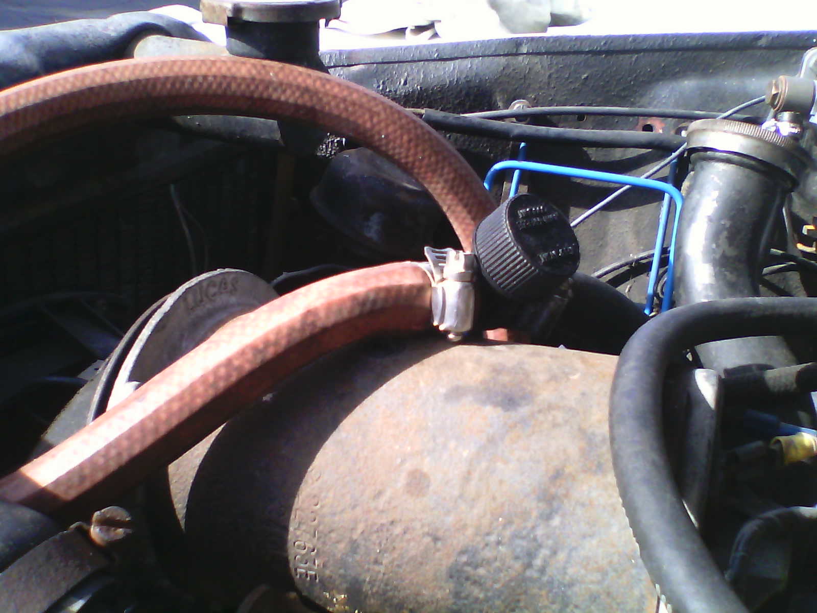

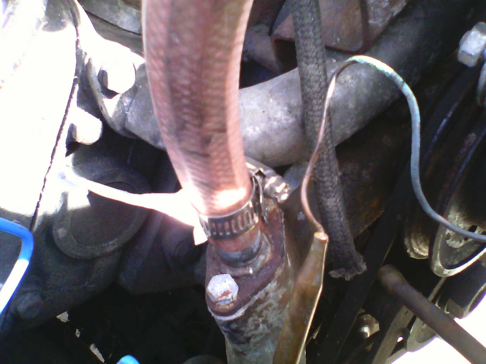

I back flushed the cooling system.
Everything came out CLEAR!
No rust, no gunk.... thank you, God, for taking time to away from the woes of the universe to make my radiator functional !
There was some jelly-like orange junk accumulated at the thermostat.
So I removes the thermostat, cleaned it, and tested in boiling water.
It opened like a mussel in a plate of marrinara linguini.
( Thanks for the extra blessing, God... )
Rather than cut into existing heater water hoses/lines to insert the water T permanently for the flush as the kit advises, the end of the existing line was removed, fitted with the new T-Insert, and a second water hose was fitted onto the engine. I don't like to cut any type of lines if at all possible, and this way make the removal of the T-fitting and back to normal set-up much easier.
Will flush with Prestone as the engine and system fires up again.
hi there
there is a drain tap that will dump the whole coolant load . Go to the bottom of the radiator and look for a spigot poking out. Some are spring loaded so you push the bottom part up into the barrel. Also turn the top which will look more like a tap..
as replacement parts are freely available it really does exist and is really fast.
There is a drain tap at the bottom of the radiator and another one at the rear of the block behind the Exhaust manifolds. I would suggest you have the radiator re-cored with an uprated tropical core/ If it's an original radiator it's brass.
