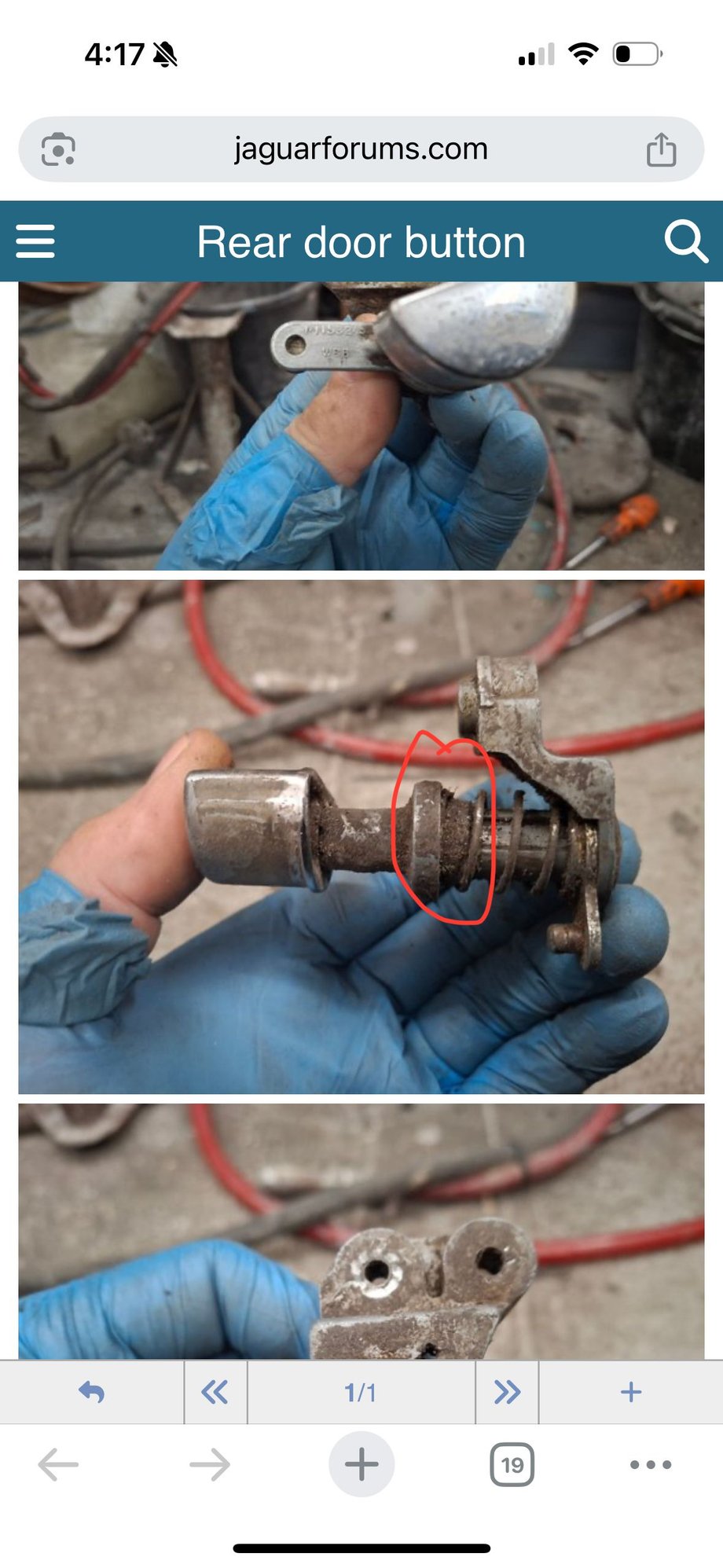

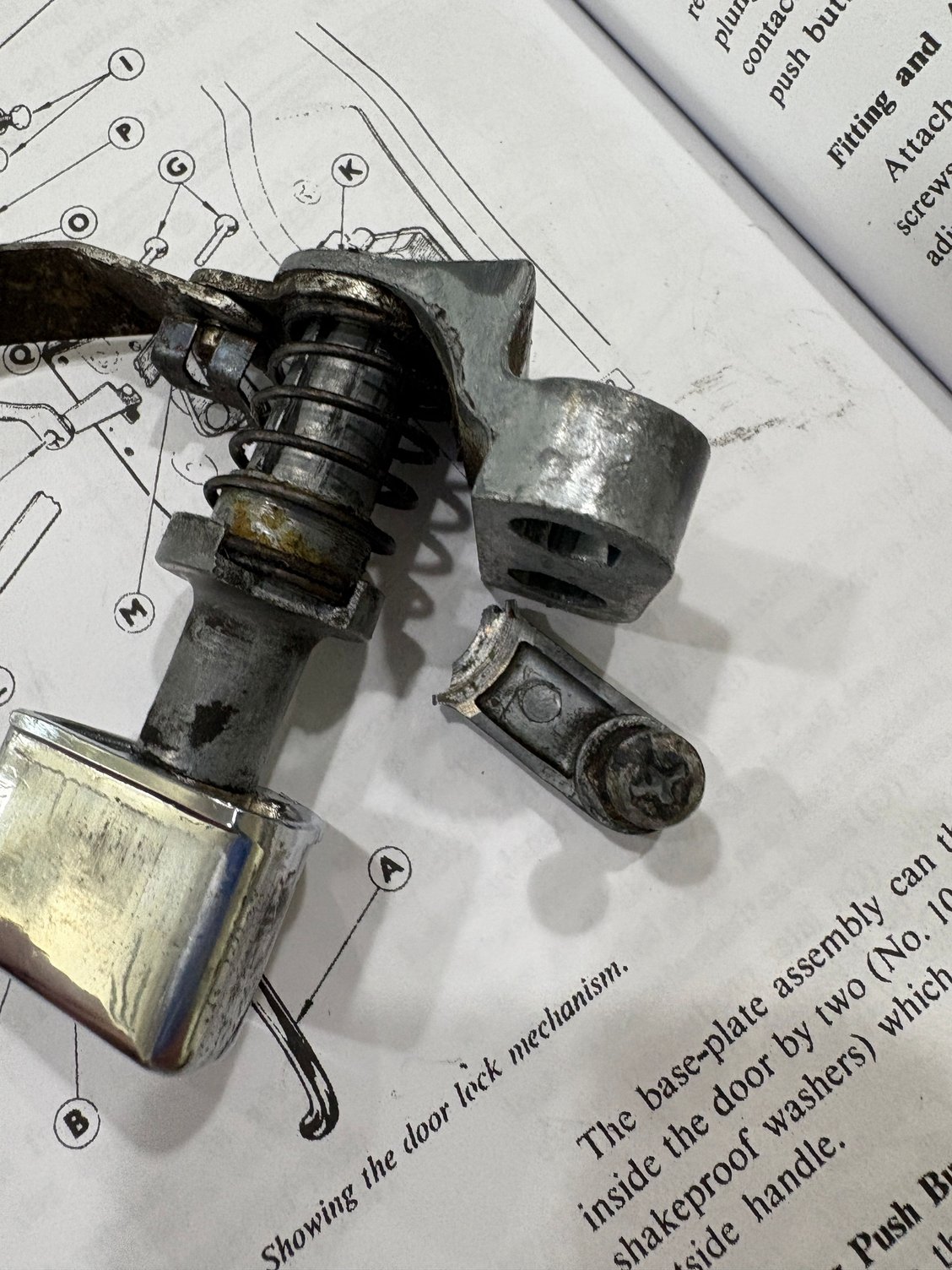

rear right door won’t open from the outside, found the culprit.
the thingy is snapped where the whatchamacallit sits on the springy thing.
can’t find a replacement online… weld it?

added photos (thought i had in the OP)

Have searched several parts suppliers sites and schematics and I cant find a single instance of this part so i can isolate the partnumber... next ill try 3D Print Search Engine

Do not lose any of the pieces, try to "weld" them with JB Weld epoxy for Metals, you might be amazed.
**adding a connecting Pin will help reinforce the parts stay together then "weld" and clamp but not too tight.
I have permanently repaired similarly broken parts with a Pin and JB Weld.
*Let the parts cure for at least 1 week before reassembly.

never used JB Weld… got a flux welder… zap zap zap should be stronger than JB?

if the parts are made of Pot Metal, zapping them might deform them or ruin them.
Try a less destructive method first.

my neighbor who’s a professional welder just told me the same thing…
solder?

solder won't stick for long. Think "surgery Pin" for a permanent, one-time fix that will not fail after a while.

forgive my lack of knowledge… how would I pin it?
not a lot of metal to work with

I have used a Dremmel tool to drill a tiny hole into each broken piece, then inserting a short pin into the holes making sure that both parts are aligned perfectly.
Then apply the epoxy to both broken parts and clamp.
If there is not enough material to drill tiny holes, the alternative is epoxy only.

US based these days. My jag guy in the UK - next town over from my former home has the part I need but shipping to USA is expensive and then I’d have to pay tariffs… so I could get it sent to my best mate who’s coming over in September.
it’s broken in such a way that it’s v difficult to repair.
want I’d like to do is render a replacement in ABS or ASA on a 3D Printer and share with the jag community. But I’m not that skilled yet

the concept of adding a pin is the same concept as adding a so called "biscuit" when joining wood parts. Joinery ?
Do a search for "joining two wood pieces with a biscuit" and you'll see how it works.
Adding a pin or two reinforces the glue bond, makes it permanent. But it is very delicate surgery to do initially, (drilling the pin holes).

I think the metal is just too thin to pin.. the edge is 1mm thick at most, bracing may work (lay a couple of rods onto the flat and JB Weld to the surface) but I doubt it would hold up for long.

ok, that is also a good approach. You have nothing to lose by trying with JB Weld, it cures like a rock. Just let it cure for a week.
