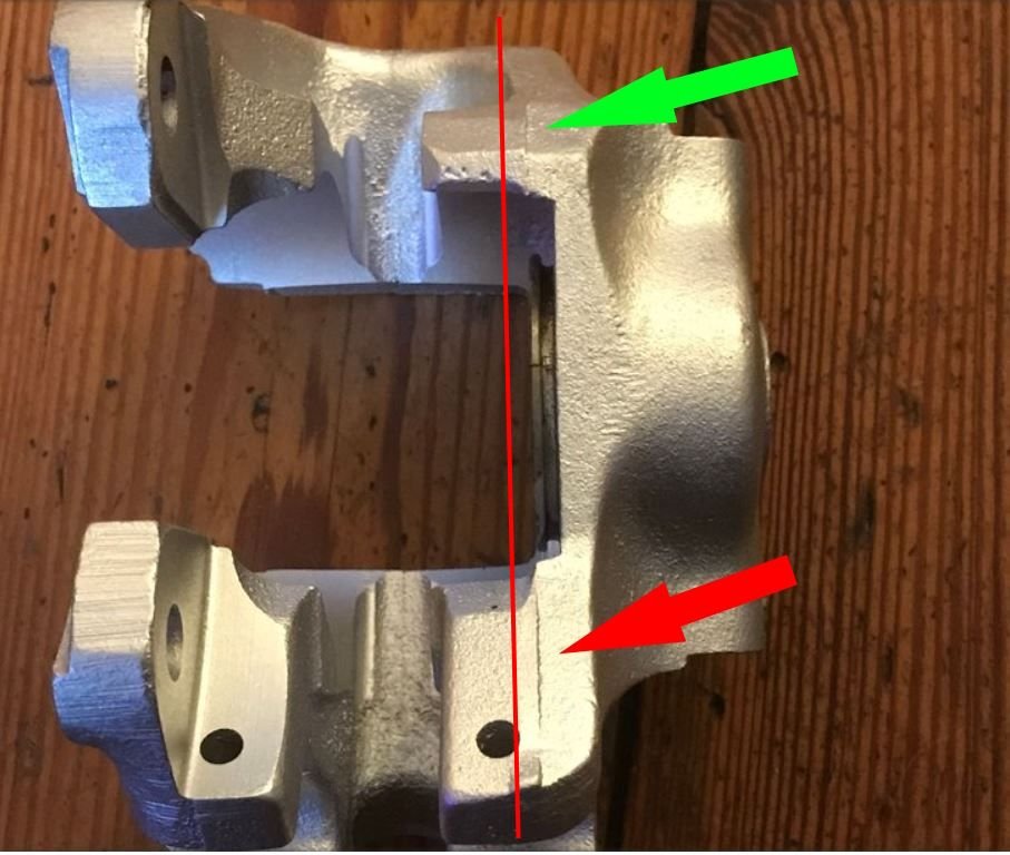

I'm just putting my rear brakes back together as part of the rear suspension rebuild. Unfortunately I've just spotted that the rear LH caliper/carrier part number C22724 and pictured below has a crack in it. Don't know how I haven't noticed it till now as I have spent the last few weeks disassembling, cleaning, sandblasting, cleaning, painting etc etc the caliper and only noticed when I was putting in the new pistons...
Anyway, I need a replacement and wondered if anybody here could help. Ebay has a couple of possibilities, but one is complete junk and could be cracked as well & needs relining and the other is being sold as a fully refurbed pair. As I have already spent quite a bit of the green stuff on replacement pistons, seals etc for mine what I'm after is a crusty but not too far gone example that I can rejuvenate.

I think what you're looking at is what I call a "casting step", what may look like a crack, isn't.
I'm assuming what you think is a crack is what I've pointed out with a red arrow ?
What are the chances of that crack lining up with the other casting step pointed out by the green arrow ?
They are both in line indicating that it just a part of the casting.

I believe Jeff is correct but to be sure I suggest the following
Anyone in the aviation engineering business is familiar with dye penetrant crack detection.
I would suggest that this calliper be taken to an aviation engineering place and subjected to this process.
Would be a hell of a lot cheaper than replacing the calliper.
I would do it for a 6 pack of the amber fluid.
And if you don't want to take the caliper to Australia, most welding suppliers will sell you a three bottle kit for about the same price.
