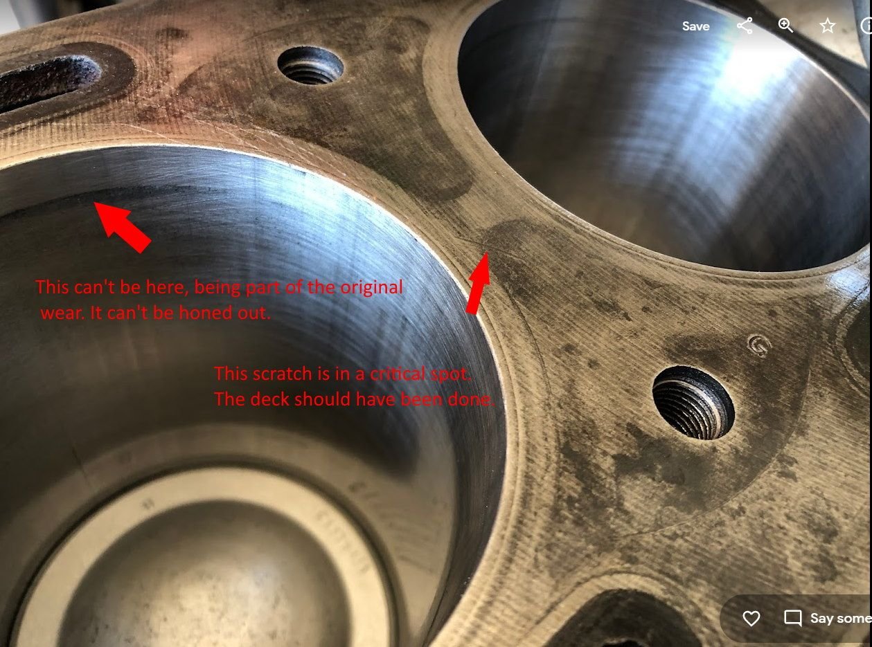

Personally I would not touch this engine now, DYI honing jobs are just that, the bores now need a proper machine shop to fit in oversized pistons and bring the bores back to "true", as they did from the beginning.
I find that even engines that are with in spec with simple honing procedures, will have more blow-by and piston slap then normal, even if it is with in spec.

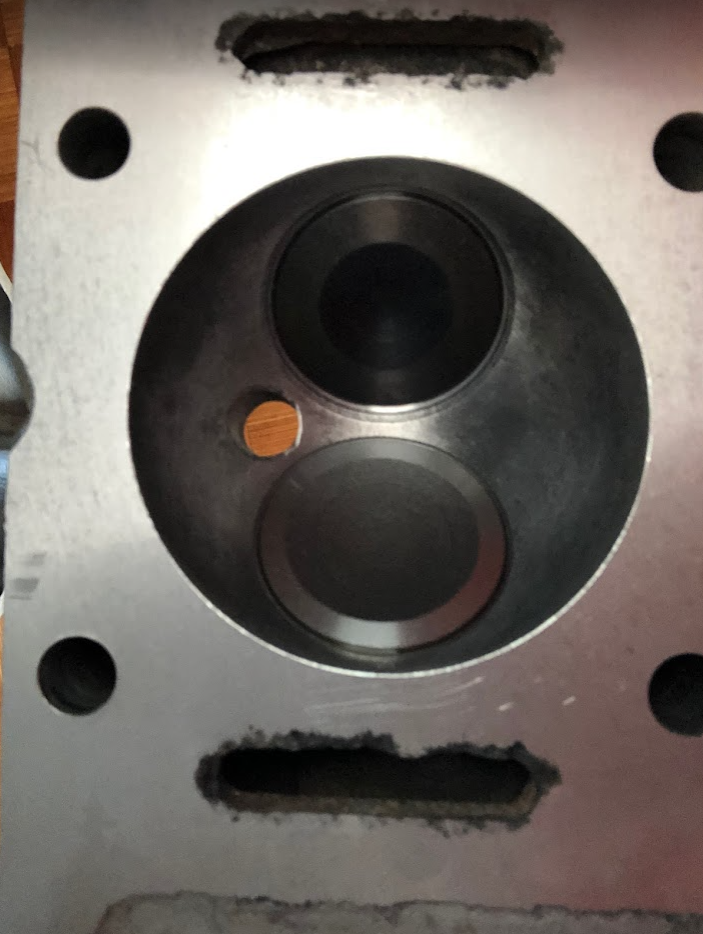

The head needs repair from the pitting around the water jacket, especially with a metal head gasket.

I had about that much pitting of the head water jackets. Had it welded skimmed & refinished ~ looked like new.

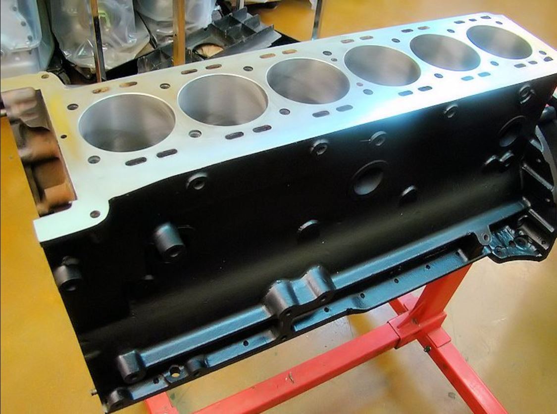

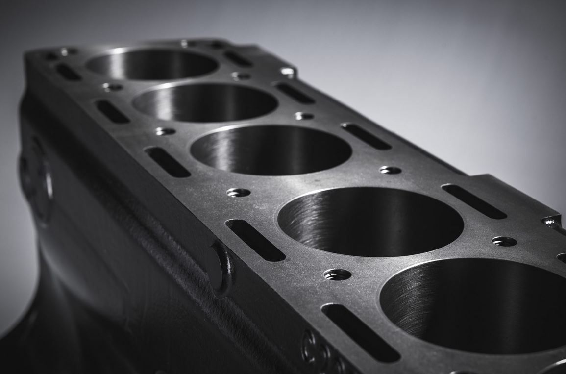

Block examples. 4.2 & 3.8.
Cylinder head welded & finished pre painting. (Excuse dirty paw & cleaner marks) Thank heavens for Dremel.
