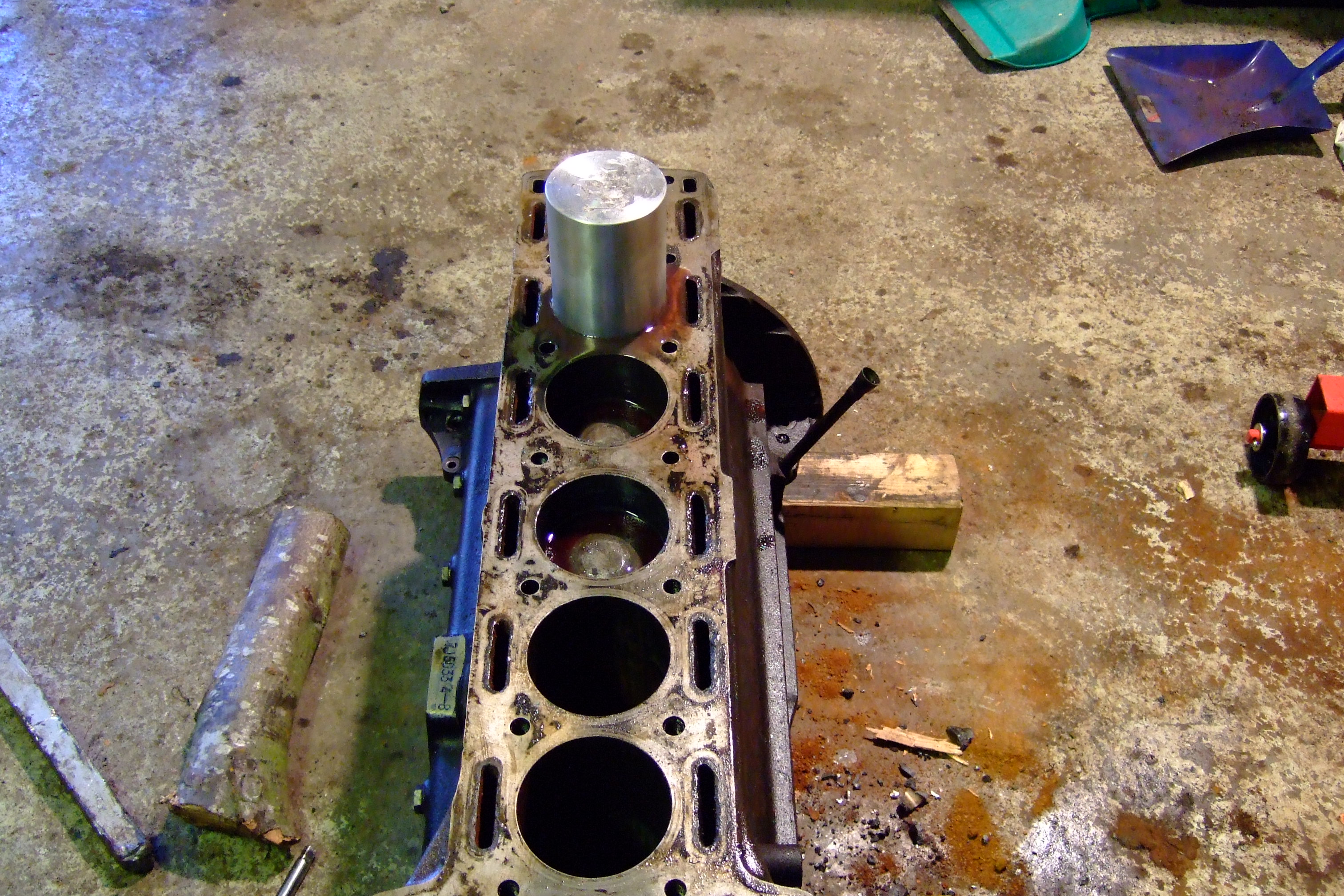

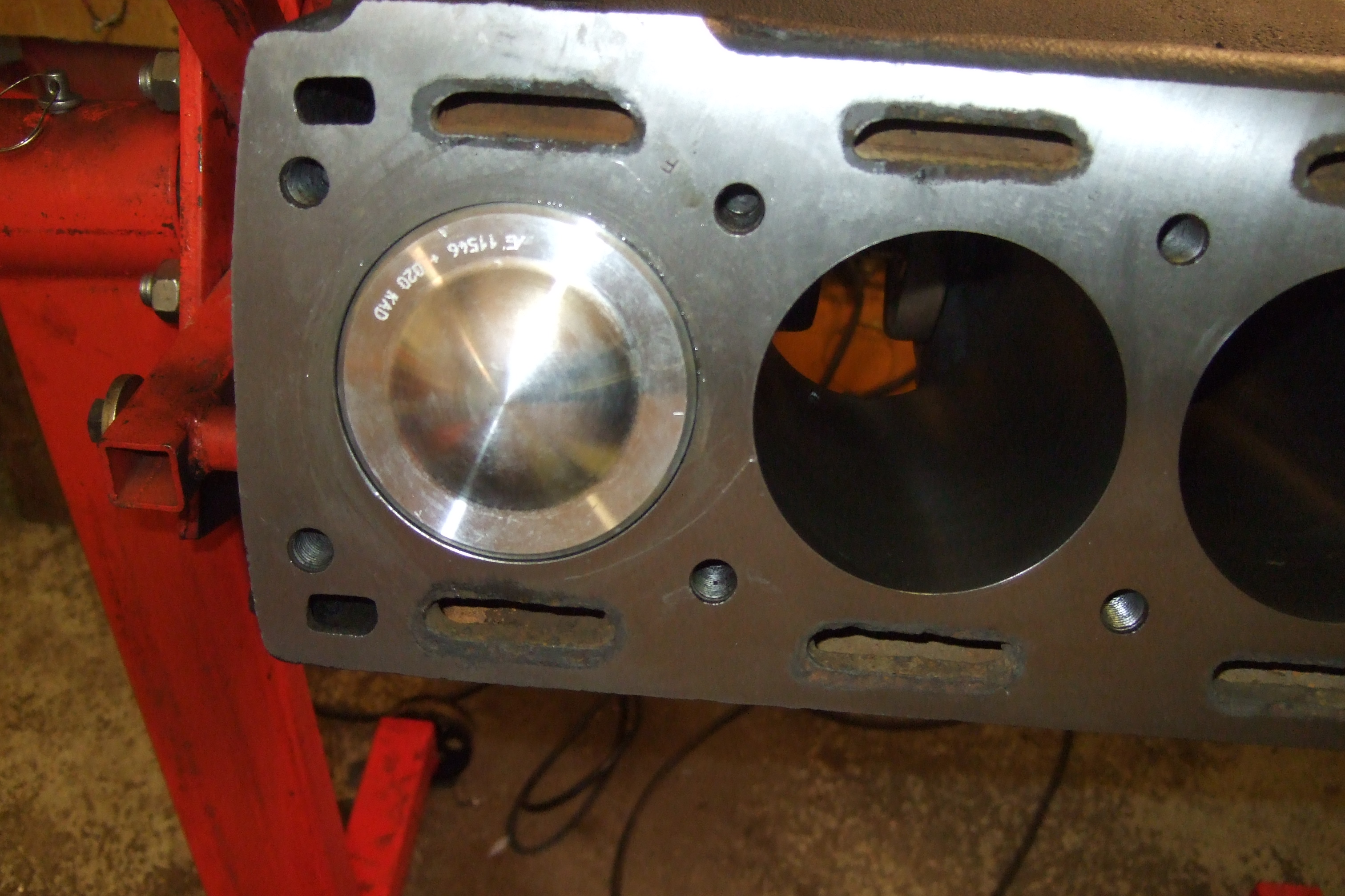

I had exactly the same problem but with three pistons stuck, I therefore made the attached device on the basis that either the piston will move of the housing will crack. If you are thinking of changing your engine as a solution to your problem this may be a cheaper solution. Basically this is a block of Aluminium machined to about 30 thou smaller than the piston with a recess for the top of the piston for the bulge and then hit with various sizes of hammer till pistons eventually gave up the challenge and came out
Once I removed the old pistons I had the head skimmed and all piston bores machined and ended up only 20 thou oversize so well within limits and fitted new pistons
