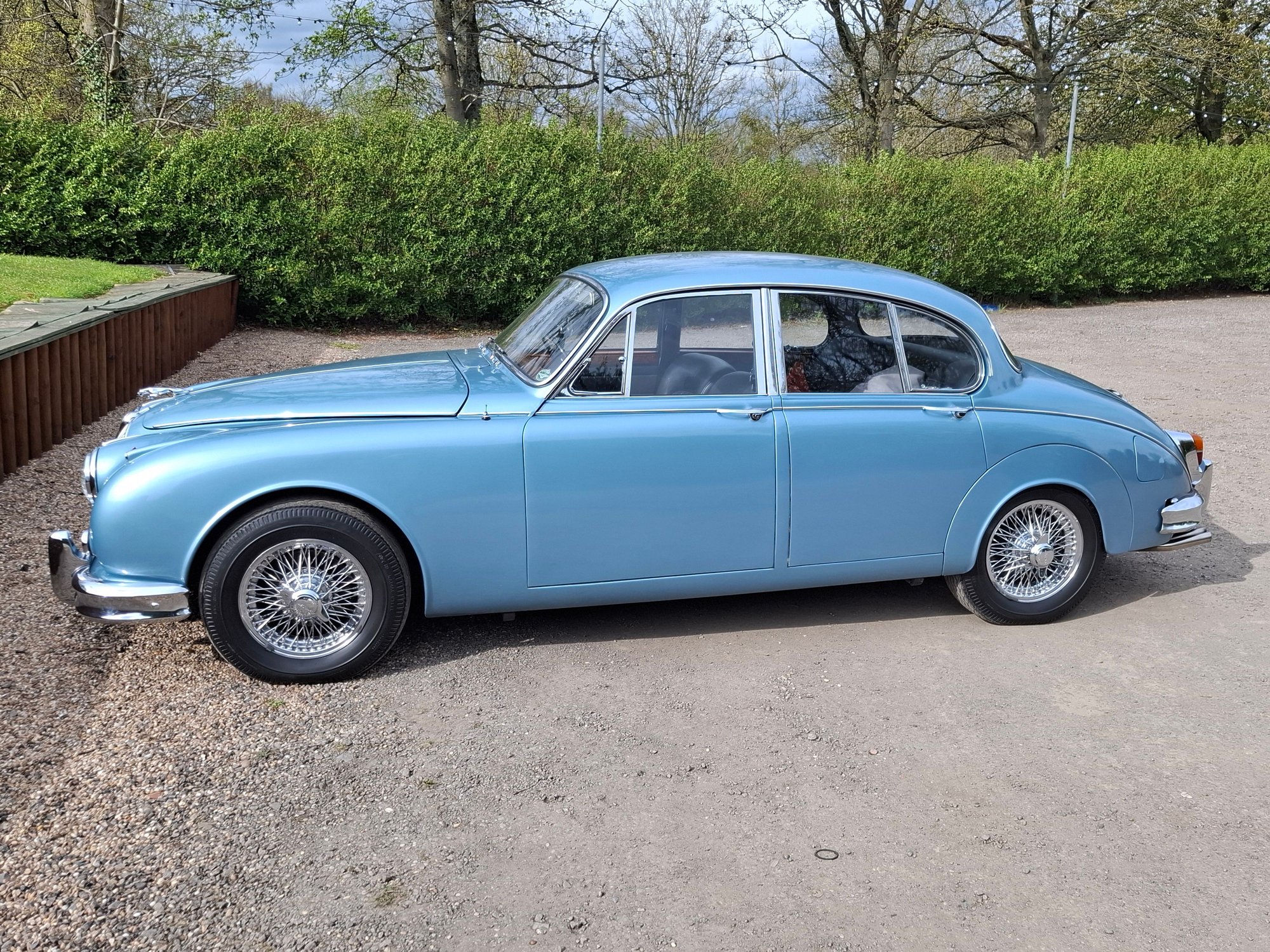

[img alt="There she is Jose.
"]https://cimg5.ibsrv.net/gimg/www.jaguarforums.com-vbulletin/2000x1504/20250414_160649_08f5f54bd566849816371718fcea8df1d2 7633fc.jpg[/img]
There she is Jose.

you got it ! Wonderful MK-2

Congratulations Paul. Looks to be a great Mk2 in what is probably my favourite colour.
