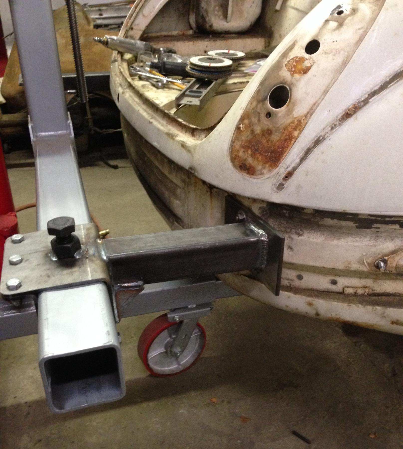

Old Apr 13, 2015 | 06:19 AM
  #53
bendougy's Avatar
Posts: 132
Likes: 8
From: Northern Territory Australia
Oliver
To attach the rotissiory to the rear of your car, have you just used the 4 bumper bolts? They seem too small to hold the weight of the car.
Old Apr 14, 2015 | 05:10 AM
  #54
ollibee's Avatar
Joined: Dec 2012
Posts: 107
Likes: 28
From: Basel-Switzerland
Hi Bendoughy
I made a small mountig bracket which I attached to the 4 bumper bolts. They hold now since two years.
Regards,
Oliver
Old Apr 14, 2015 | 09:54 AM
  #55
lickahotskillet's Avatar
Posts: 795
Likes: 200
From: Ohio
Default Rear Rotisserie bracket at bumber mounting
Bendougy,
Here's the bracket I made. The shell even hung by two bolts each side for a while. Side portion of the bracket was added later for transportation to the blaster. I will have to slice the side portion for removal.
No flex was noted.
Attached Thumbnails Restoration af a MK2 3.8 1960-img_1778.jpg   Restoration af a MK2 3.8 1960-img_2024.jpg
Old Apr 15, 2015 | 04:25 AM
  #56
bendougy's Avatar
Posts: 132
Likes: 8
Thankyou. I have done the same
