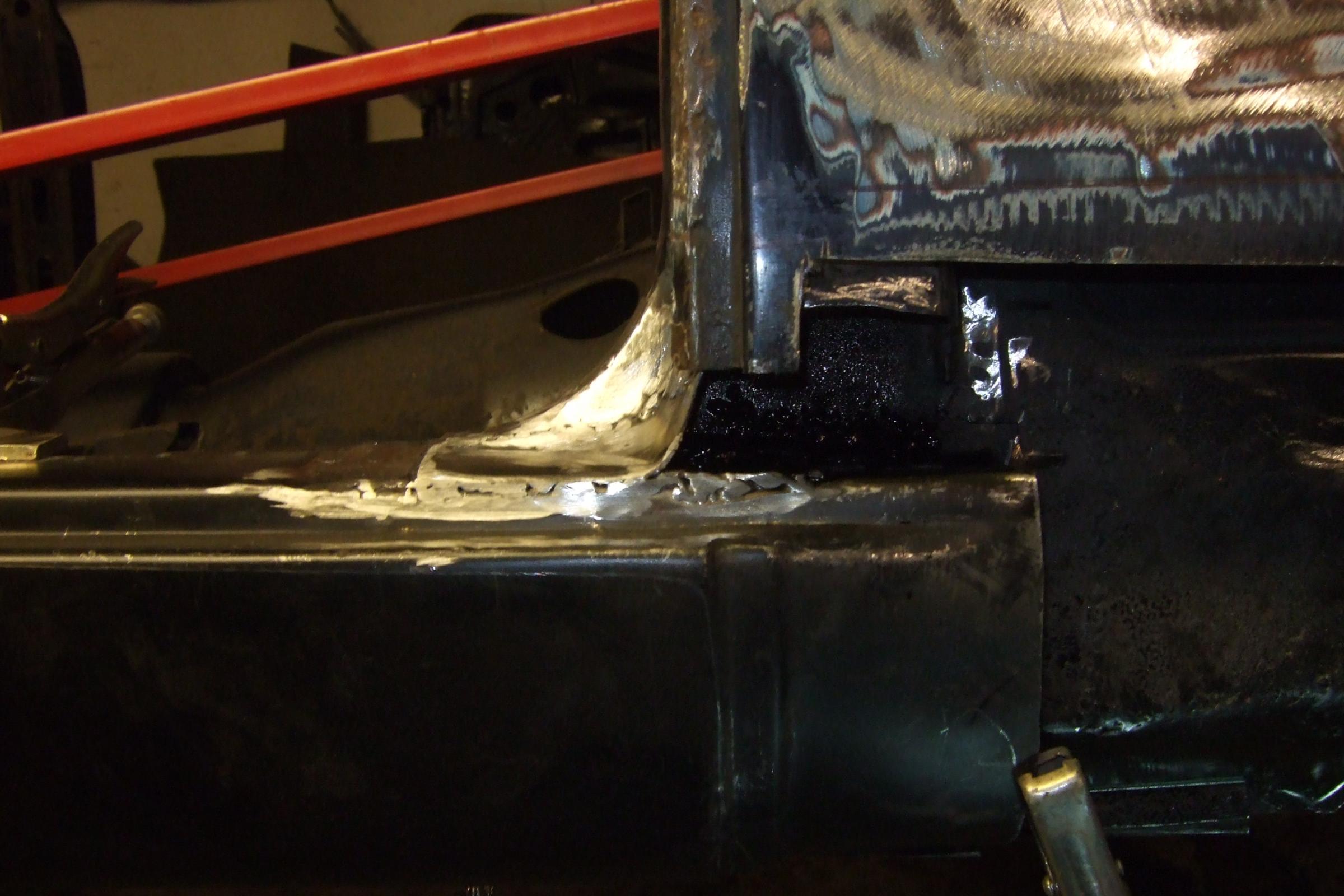

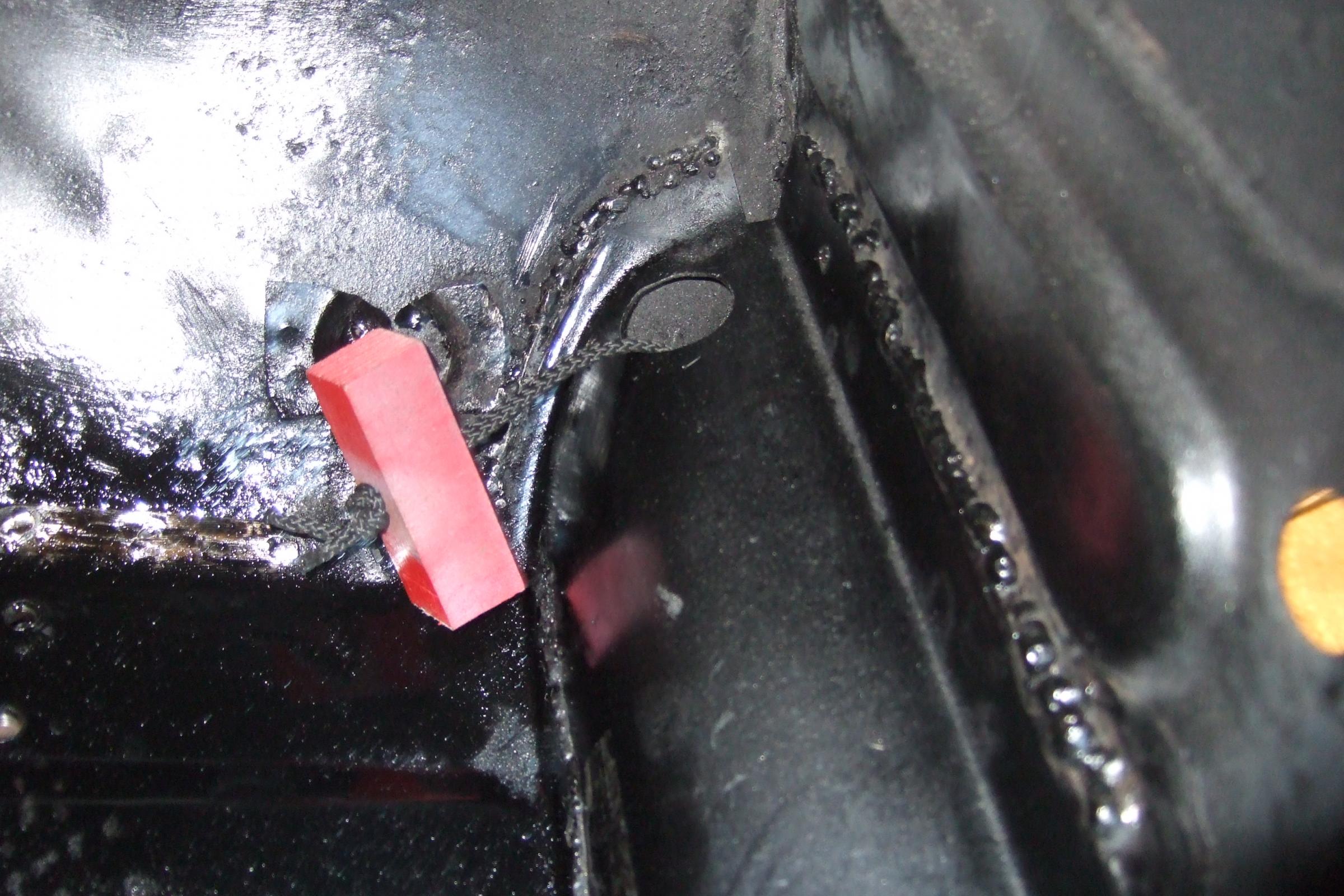

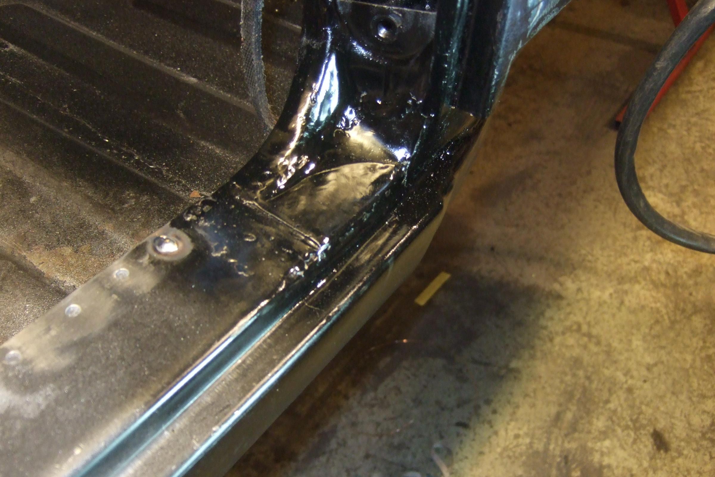

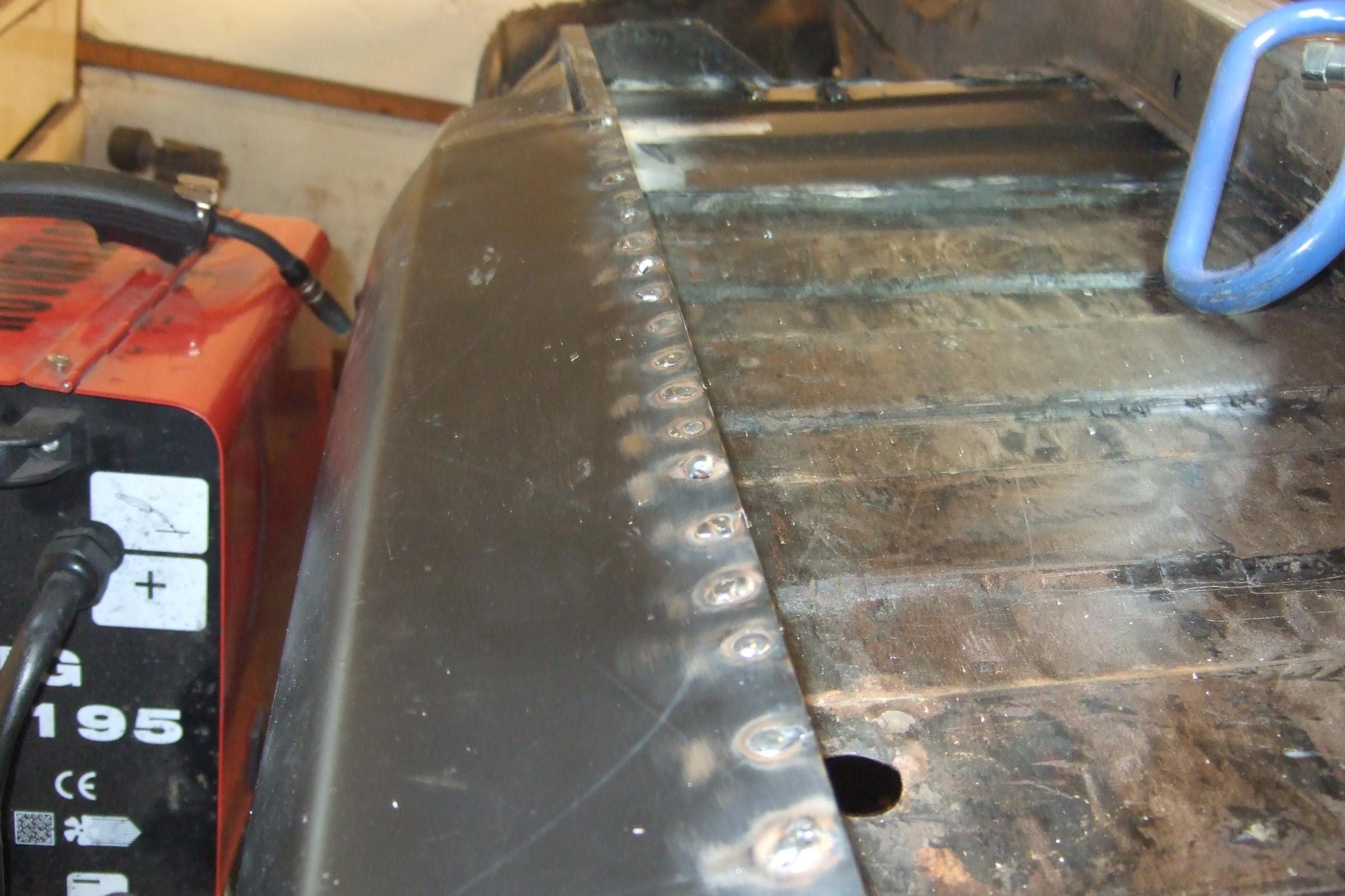

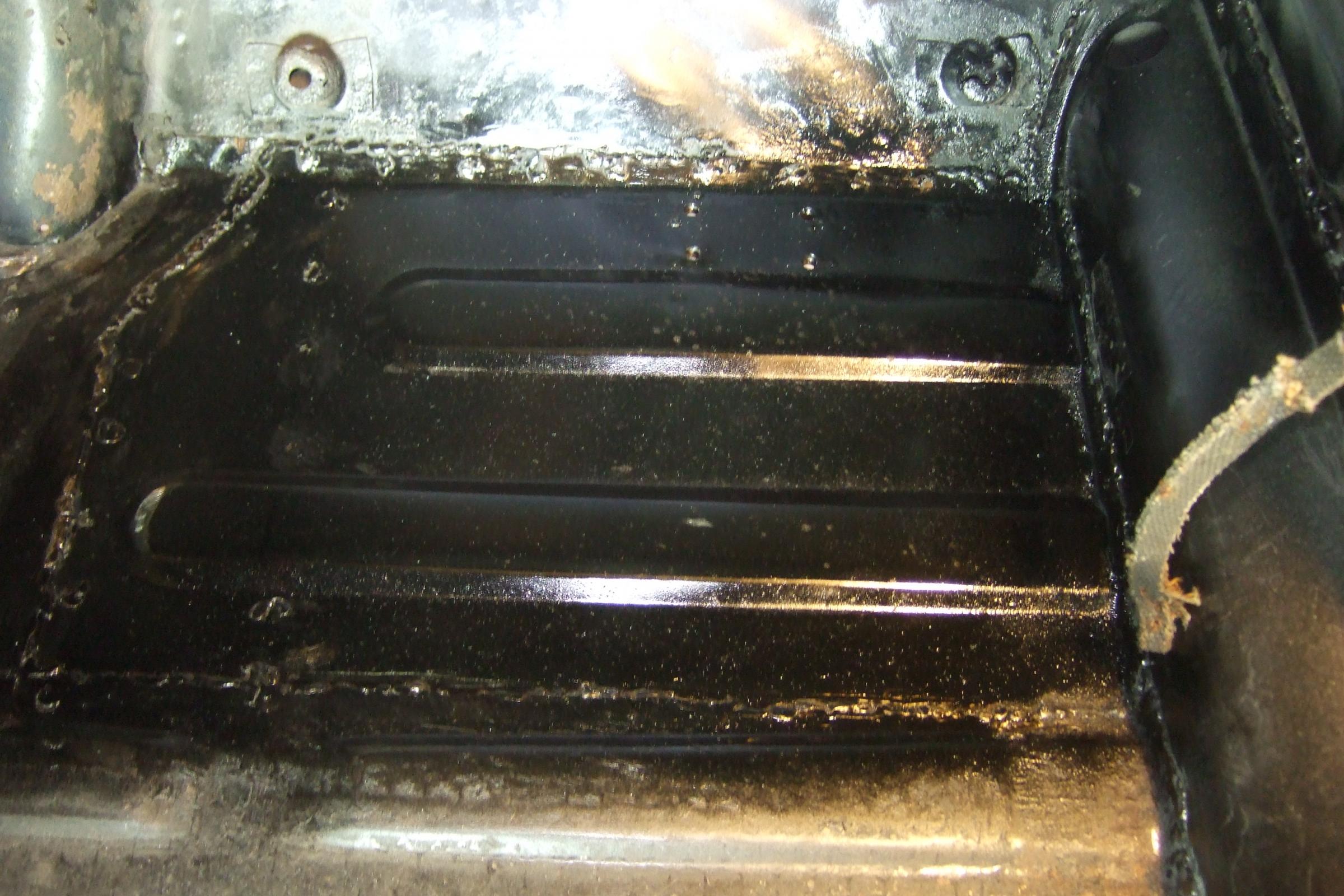

Well some progress on the car this week, garden still not possible to work on so more time in the garage.
Time to take on the complete replacement of the RH sill both inner and outer, plus the junction with the A post and everything else that is down there. Picked up some aviation skin pins from work and there are really useful when needing to clamp the parts together with the normal vice grips.
Hardest part was welding the new floor panel with my left hand, if my right is not good yet that means my left must be worse. Anyway you can see the results in the pictures, this is just the part on replacing the inner sill and a part of the A post and the new floor panel, part two will follow shortly.
I ran a piece of string from front to ack and also to the middle also before I put the outer sill in place to allow easier installation of the wiring harness - when I am ready for thsi is a couple of months hopefully.
Part two outer sill installation will follow in a couple of weeks.

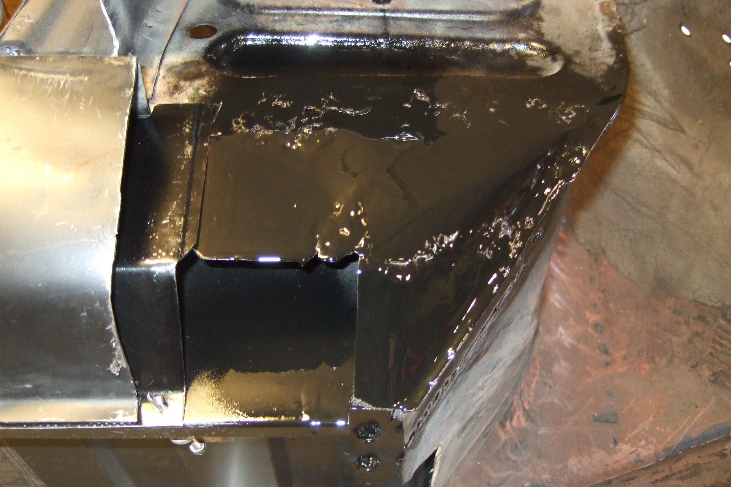

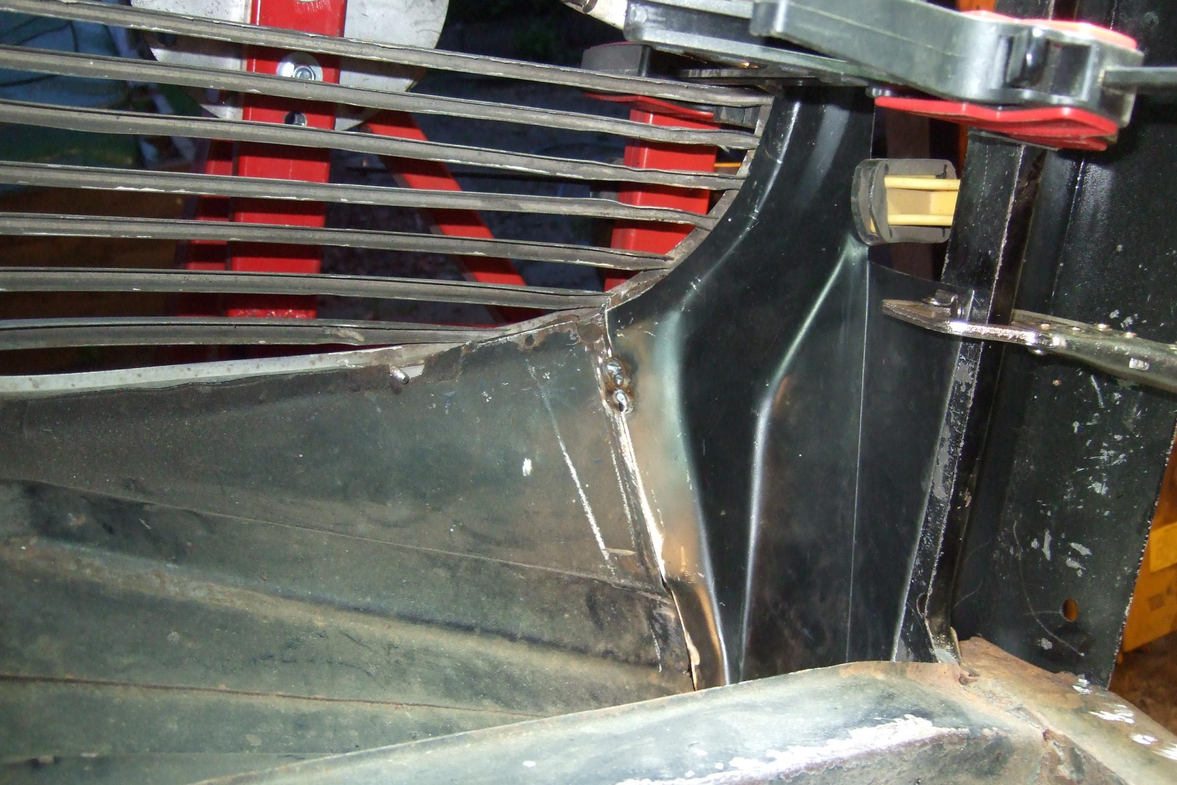

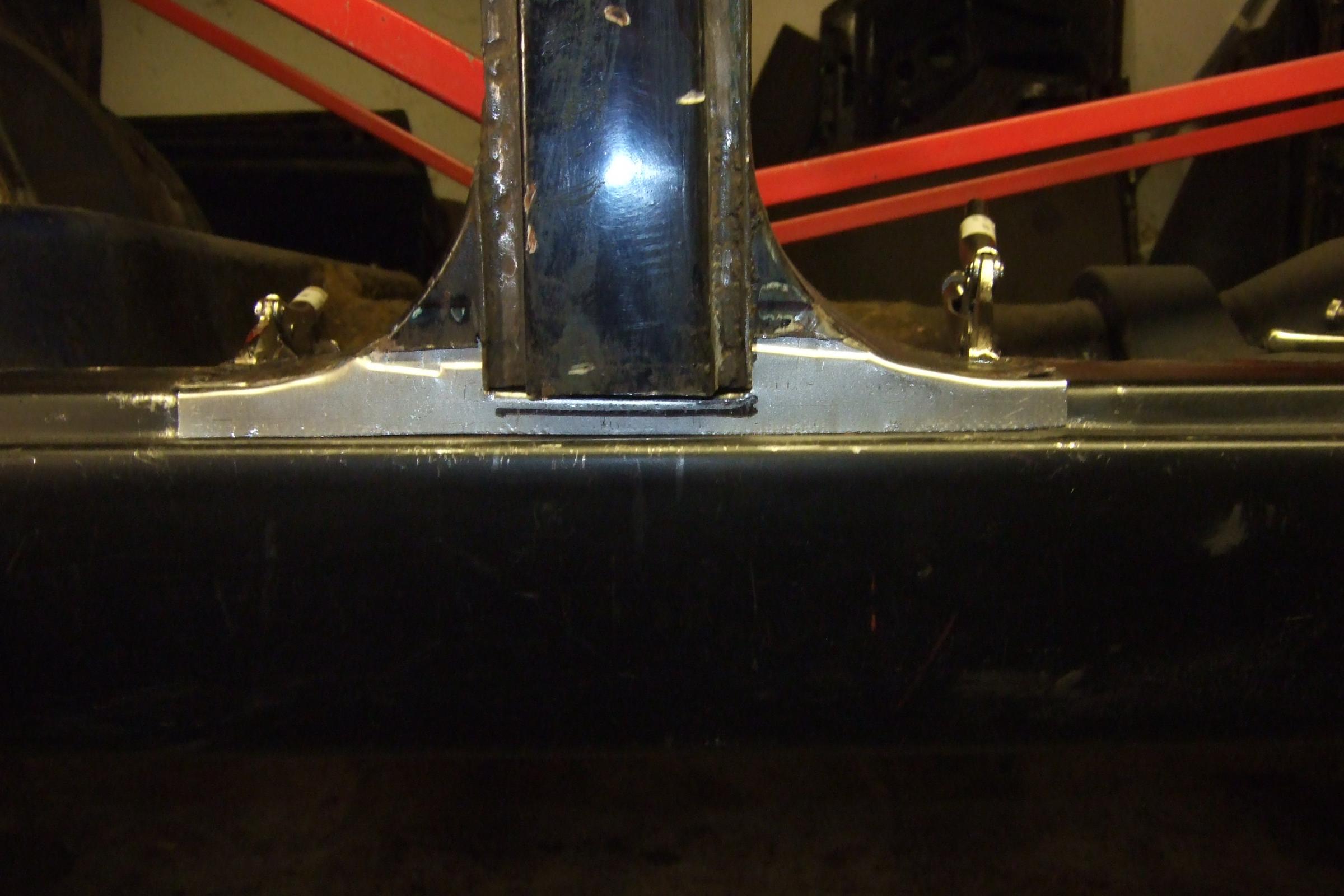

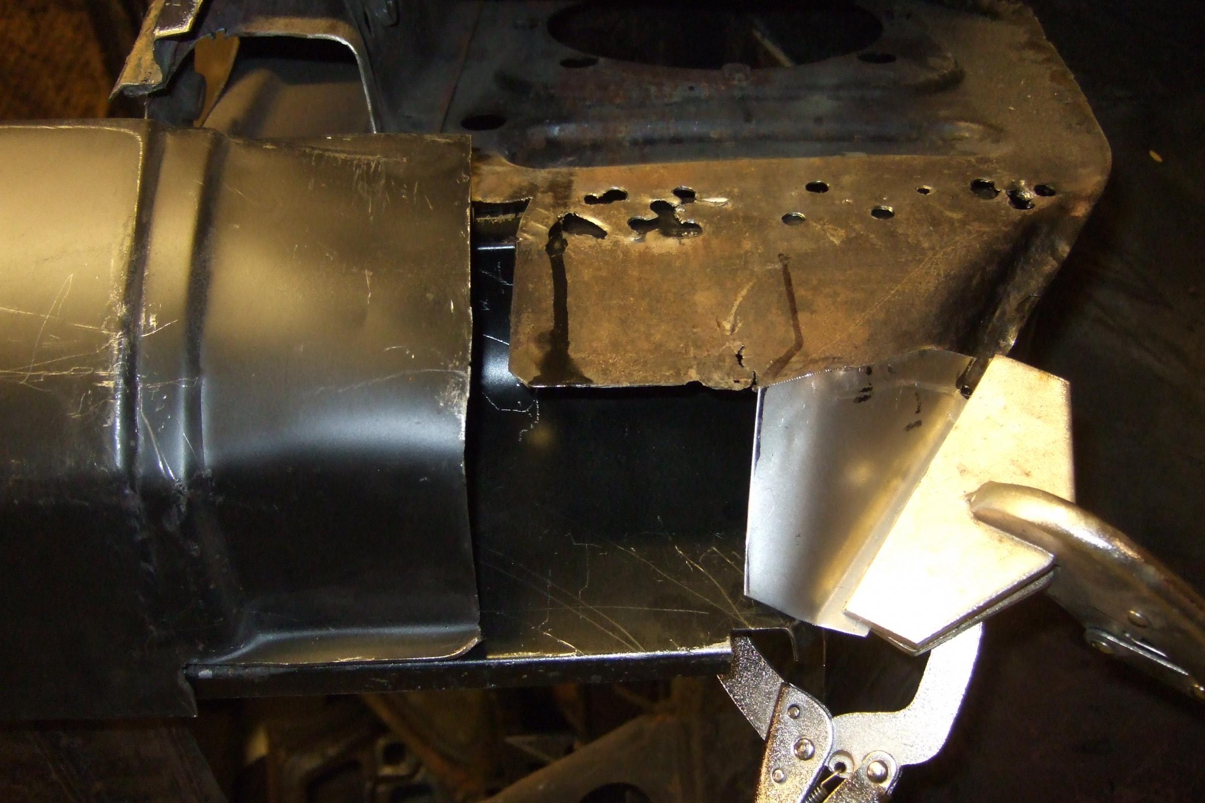

Well with the Easter weekend here a little more time to work on my project. Although you can buy new panels for the inner and outer sills it is the little repair peices at the bottom of the A, B and D posts that are interesting and they dont make pieces for these you have to improvise.
Anyway attached are some photos with regard to the A and B posts I still have the D post to repair, all these made with a small guilotine and a small bender, vice, hammer and various pieces of metal used as formers.
My view is that if I can get a good weld in most places and take care to get this then this will be as good as the production line.
Also changed my weld gas from full Co2 to Argon/Co2 mix and this has made a real difference to the quality of the welding and getting happier now with every weld, maybe I will go over some of my earlier welding just to be sure.

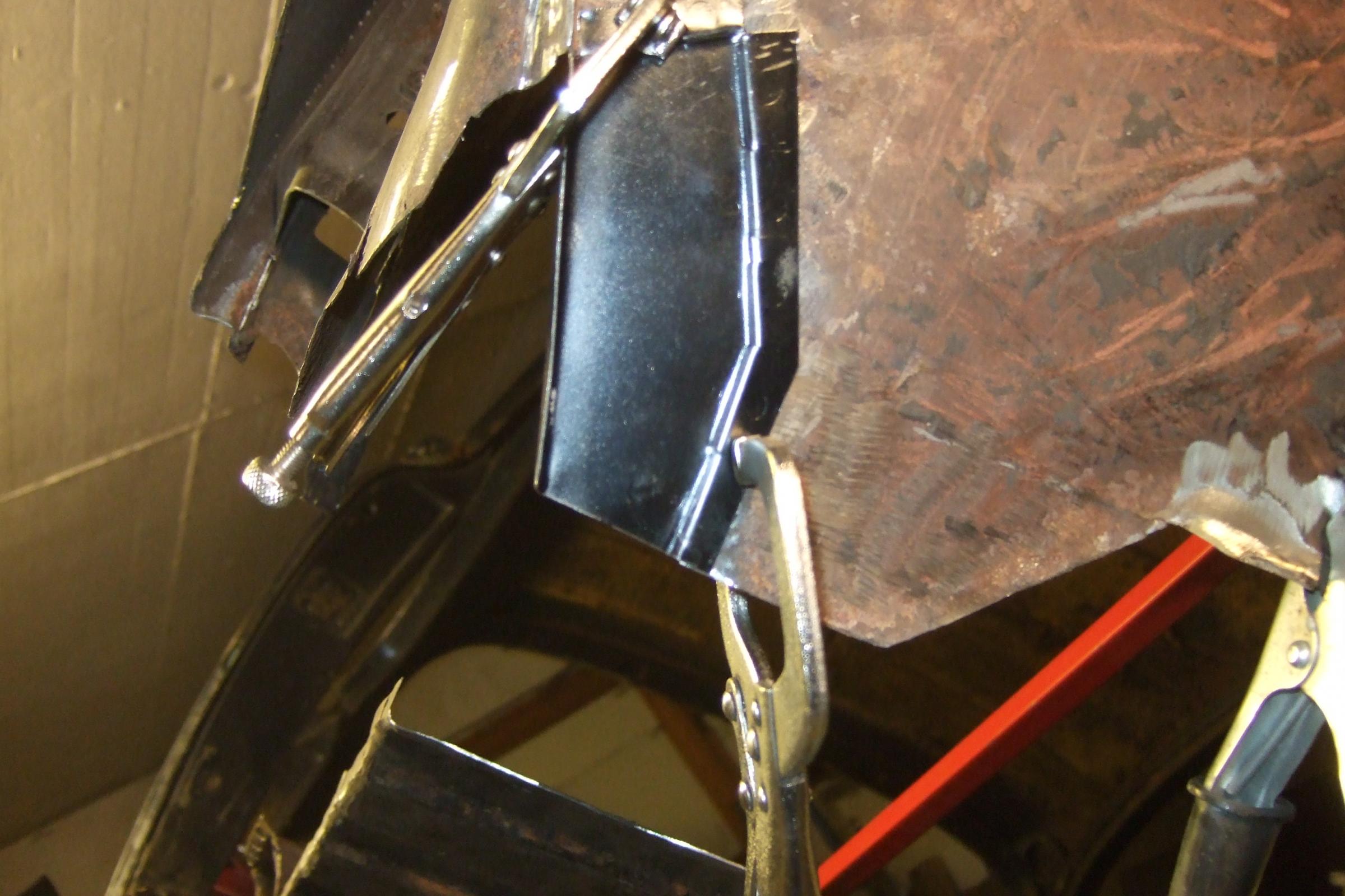

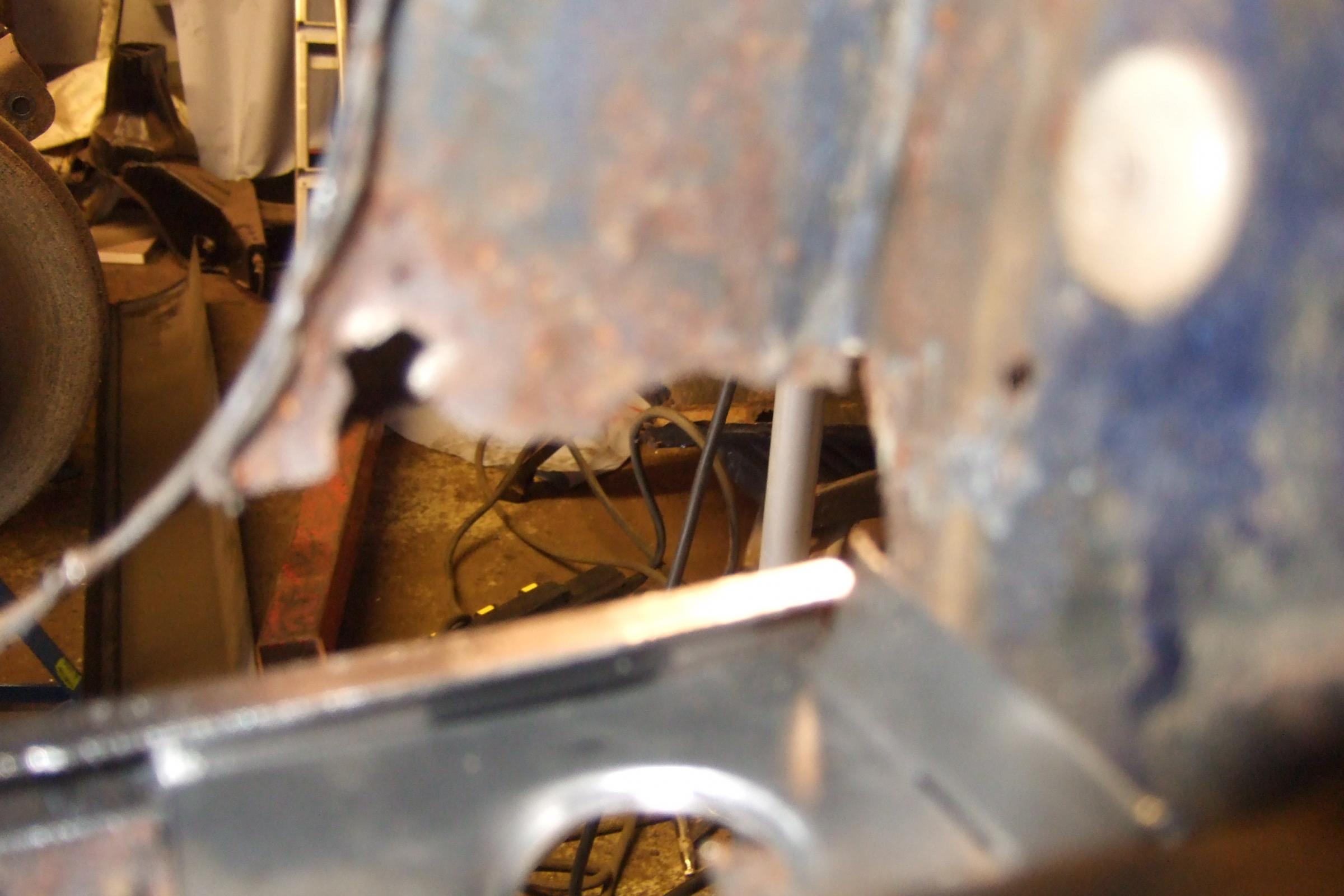

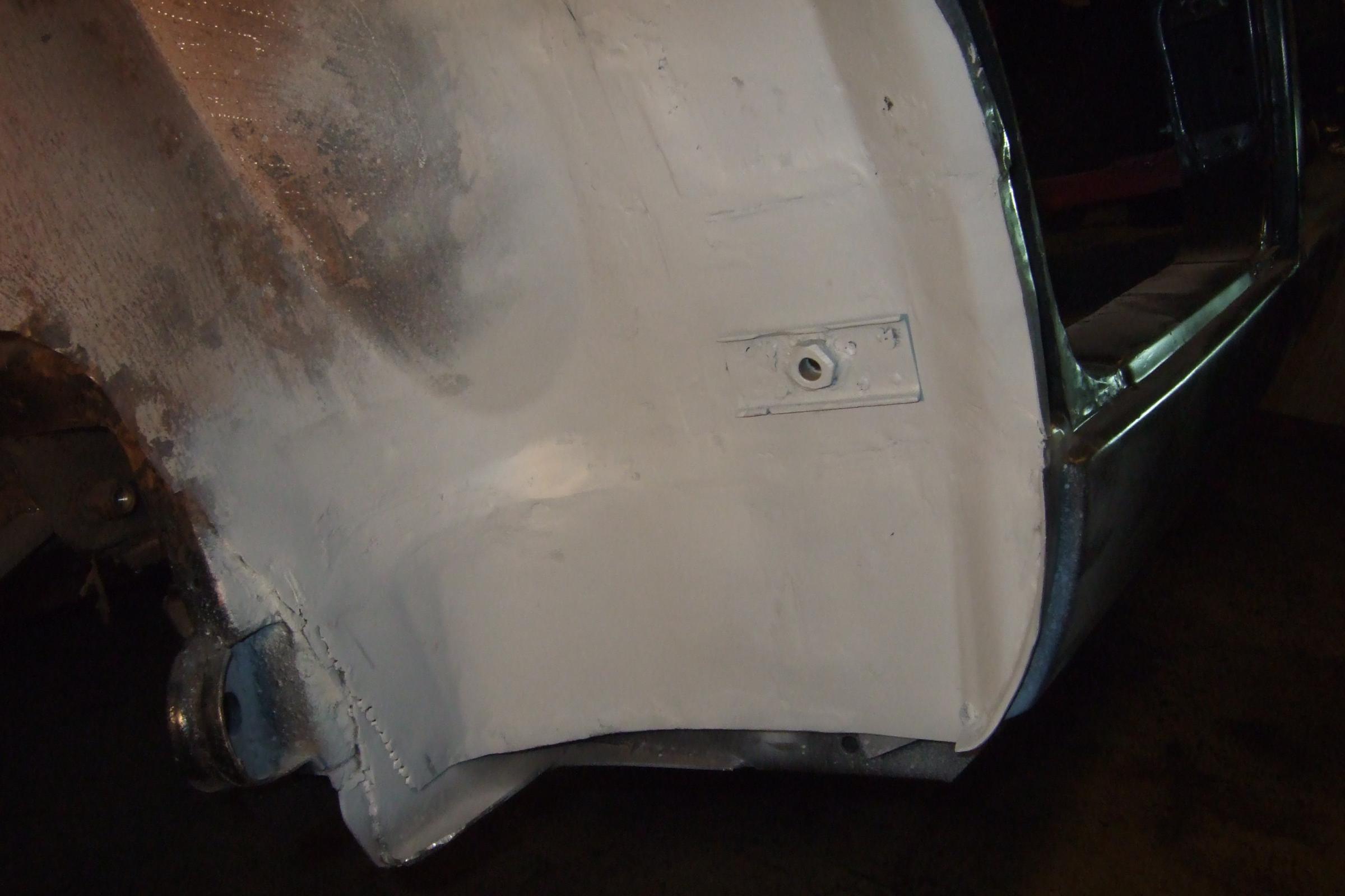

Now that I have finished the front part of the sill it was time to move to the rear. As with all these tasks you start off thinking that you only need to cut a small section out but by the time you have finished you have tripled the size of the original plan.
Anyway some photos of the rear wheel arch repair. For the first time needed to take a piece into work and use a tool from the detail shop, needed to "shrink" a radius around the "D" Post panel.
I then made up four pieces to repair the material I cut out of the wheel arch and get them all welded up and sealed.
Anyway enjoy.

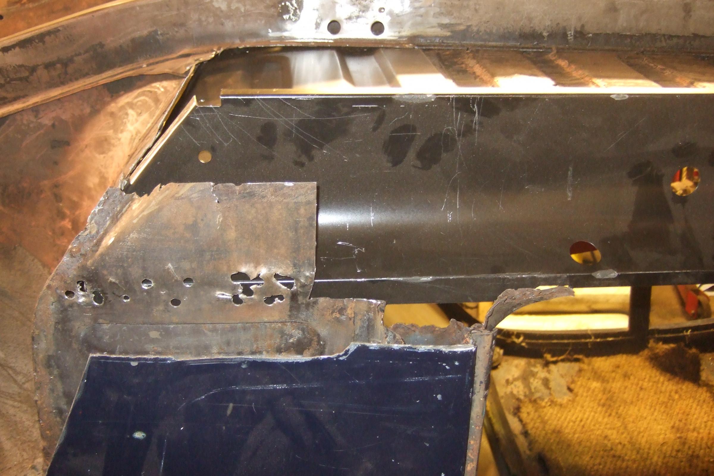

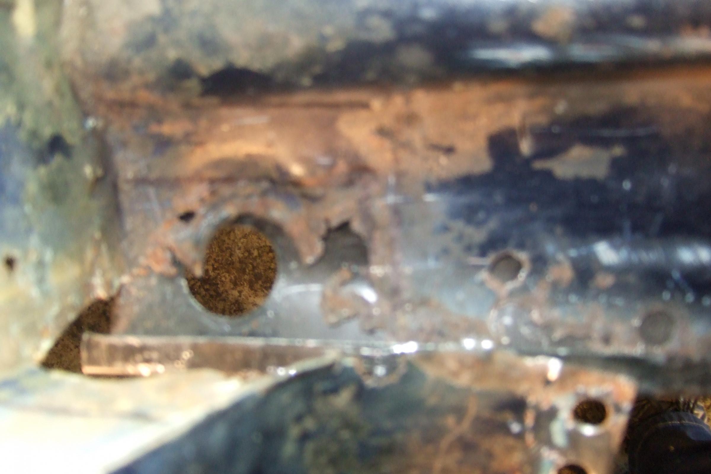

Well its been a few weeks since my last post but i thought i would catch up with some more photos and progress an this major restoration. Anyway the last time i posted I showed you all progress behind the RH rear wheel arch and finishing that off allowed me to move forward to take on the front wheel arch and the repair to the indicator light on the right hand side as well.
my plan is to work round the car from the rear RH side to the middle and then start from the rear LH side to the middle and hopefully everything meets as planned. The only reason for this is that my double garage only allows me to really work on one side at a time so I choose the part nearest my work bench even though I can rotate the car 360 degrees I have not mastered the art of upsidedown welding yet!!!!!!
Any way some pictures of the progress.
still hopeful to have all this complete in 2013 however the clock is going faster now.
