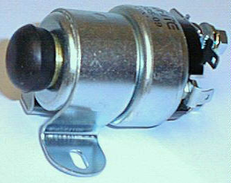

2) there is a Start Solenoid to the right of the battery, at the center of the firewall, that has a pushbutton that lets you start the engine from the engine compartment.
set the ignition key to the START position, Shifter in PARK or NEUTRAL if automatic transmission, or NEUTRAL if manual transmission, then you go to the solenoid and press the button to start the engine. Neat !

I now have the car starting from the start button

Hi here we go
Firstly you need to check that the car will start by pressing the starter solenoid button located on the rear of the solenoid - big rubber button. If nothing happens then the fault is with the solenoid. If the car turns over then the solenoid is not pulling in.
Next you need to check that the voltage arrives at the solenoid connection when the button is pressed on the dash. I did it the other way round and checked from the fuse to the key then to the starter button then to the solenoid. I found the problem was at the fuse - corrosion. I cleaned up the fuse holder and fitted a ne 30A fuse.
The voltage then appeared at the ignition switch and then at the starter button.
I found a broken wire between the button and the solenoid and repaired it.
The spade terminal in the solenoid was loose so I cleaned it all up - replaced the spade and made sure the connection was good. The solenoid was pulling in ok from the button so I re-fitted the main connection wire to the starter motor and it all worked.
hope this helps you. - you will need a test meter set to 20V DC and remember its probably +ve earth.
