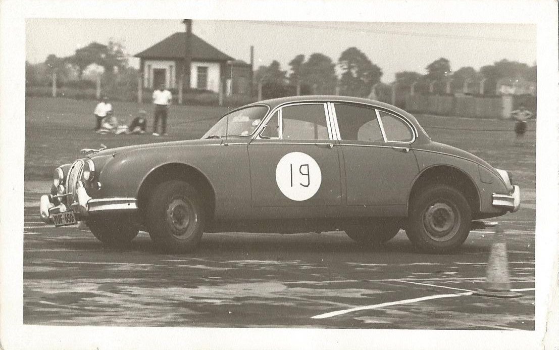

Two very true comments. So much prefer the classic saloon car races from Goodwood to modern jelly mould racing today. Glyn is quite right that the racing Jaguars were very heavily modified. Uprated suspension, lightened and stiffer body shells. The engines were highly tuned and probably not 3.8cc. You look at the Mk2s now going around Goodwood and they are not on standard 185 profile tyres. I had this conversation before when someone suggested that Mk2 Jaguars were great handling cars. Unfortunately they were consistently bad handling cars but better than most of their era. At goodwood the Mk2 Jaguars being lapped by the front running Mk2 Jaguars are the standard cars. The ones at the front have had a fortune spent on them to make them run at the front.
This is a picture of my father racing his standard 3.8 Mk2 Jaguar YUF650 in 1967 in a local sprint on an old airfield. A bit of body roll going on there that you do not find on the cars being thrown around Goodwood today.

Yes, the handling of the Mk2 was generally better than most of its competitors most of the time. But if you passed its/your limits with it, it became totally evil.
