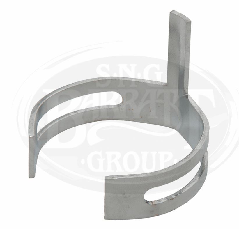

They are not all the same either. Some use the long protrusion cancel clamp/tang like Felix'.
Others use the short variety: Lucas catalogue shows all. Mine uses the short protrusion item like the E Type below.
There are many versions of indicator & headlight flasher unit with different functions & number & colour of wires. Barratts sells a one size fits all. If your car does not have that function just insulate the wire with a push on insulated female connector & ignore.
This one has a broken spring on the lower cancel finger. (sorry ~ marked for another question ~ ignore arrows).

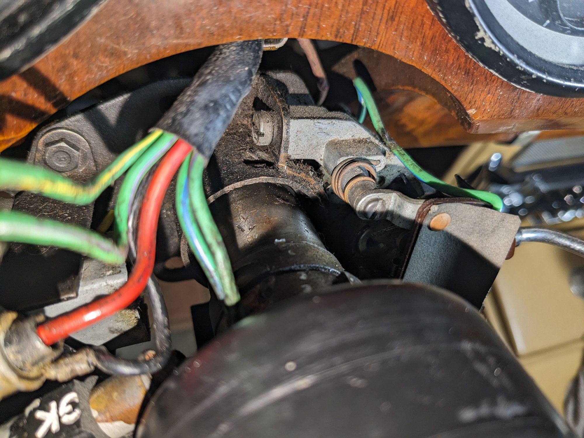

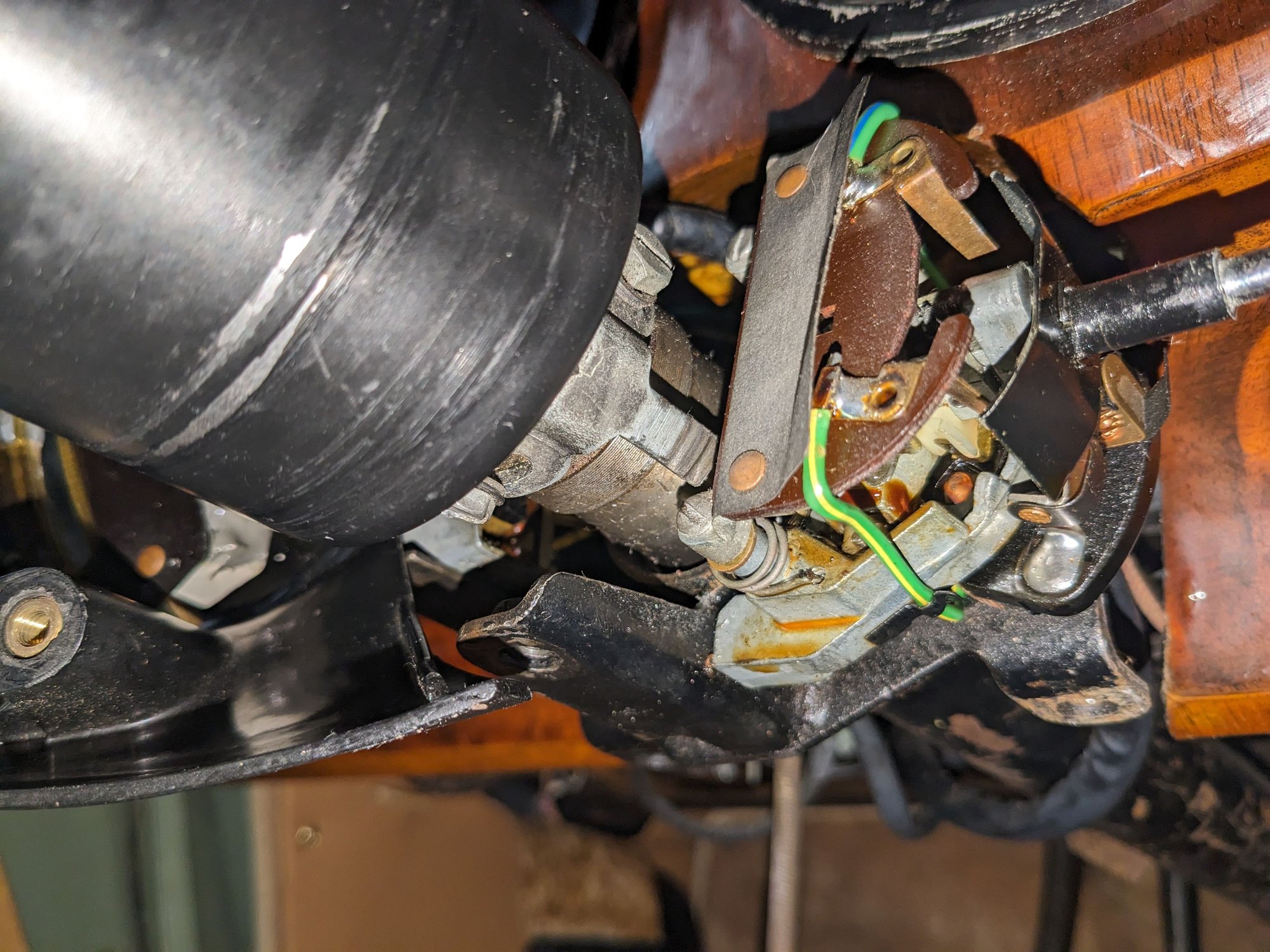

I have an early 1960 MK2 (LHD) with the turn signal on the right hand side of steering column. My turn signals do not cancel and it seems I am totally missing the plastic cancel sleeve referenced in this thread. I suppose it vaporized years ago with prior owners.
I have searched part numbers and on eBay as was suggested in this post, but cannot not find a source.
Also it was posted that people are 3D printing these. I can print but of course would need the file.
Help anyone?

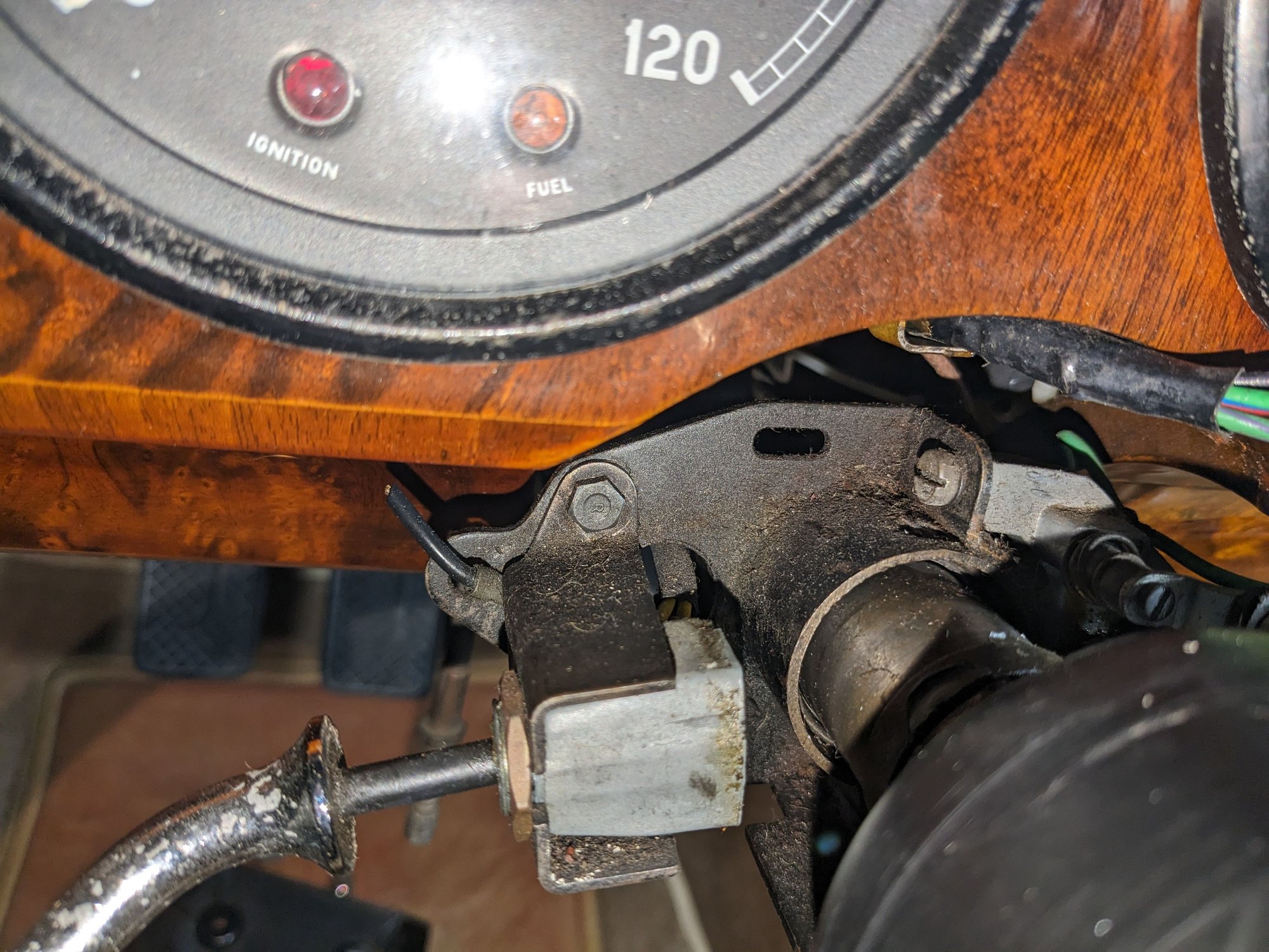

Old Oct 30, 2023 | 06:52 AM
  #32
jjsandsms's Avatar
Joined: Jan 2023
Posts: 235
Likes: 46
From: Sarasota
Here are pics of my steering hub, note my turn signal is on the right side and OD witch on the left on my 1960 LHD MK2
Looks like the plastic cancelling ring is long gone unless I have some sort of other configuration. Anyhow turn signal does not cancel either direction.
Thanks
jjsandsms

Mine it appears does have the cancelling switch with the two tangs that interact with the plastic cancellation ring that is missing. I am fairly sure of this as from my photos it is evident I have the metal piece with the tang that is suppose to fit into the plastic collar.
I did find a source for the missing piece but am not sure it is the right one as is for an E-type, not cheap!

No sure your turn signal switch uses the same plastic canceling ring. On my turn signal mechanism and the other ones that are pictured, the canceling ring snaps into the housing of the the turn signal switch that encircles the entire steering column. From your pictures it doesn't look like your switch has that circular housing.

Exactly ~ The plastic ring shown here is universal to all later mechanisms. I have a whole bunch of the later units from my donor cars & NOS that I bought should I ever have trouble. Shiney un-pitted arms and all.
In May 1960 on MK2's, the steering column stalks swapped sides to suit export market expectations, so that the indicator stalk was now on the left and the overdrive switch on the right. This became the norm for future models.

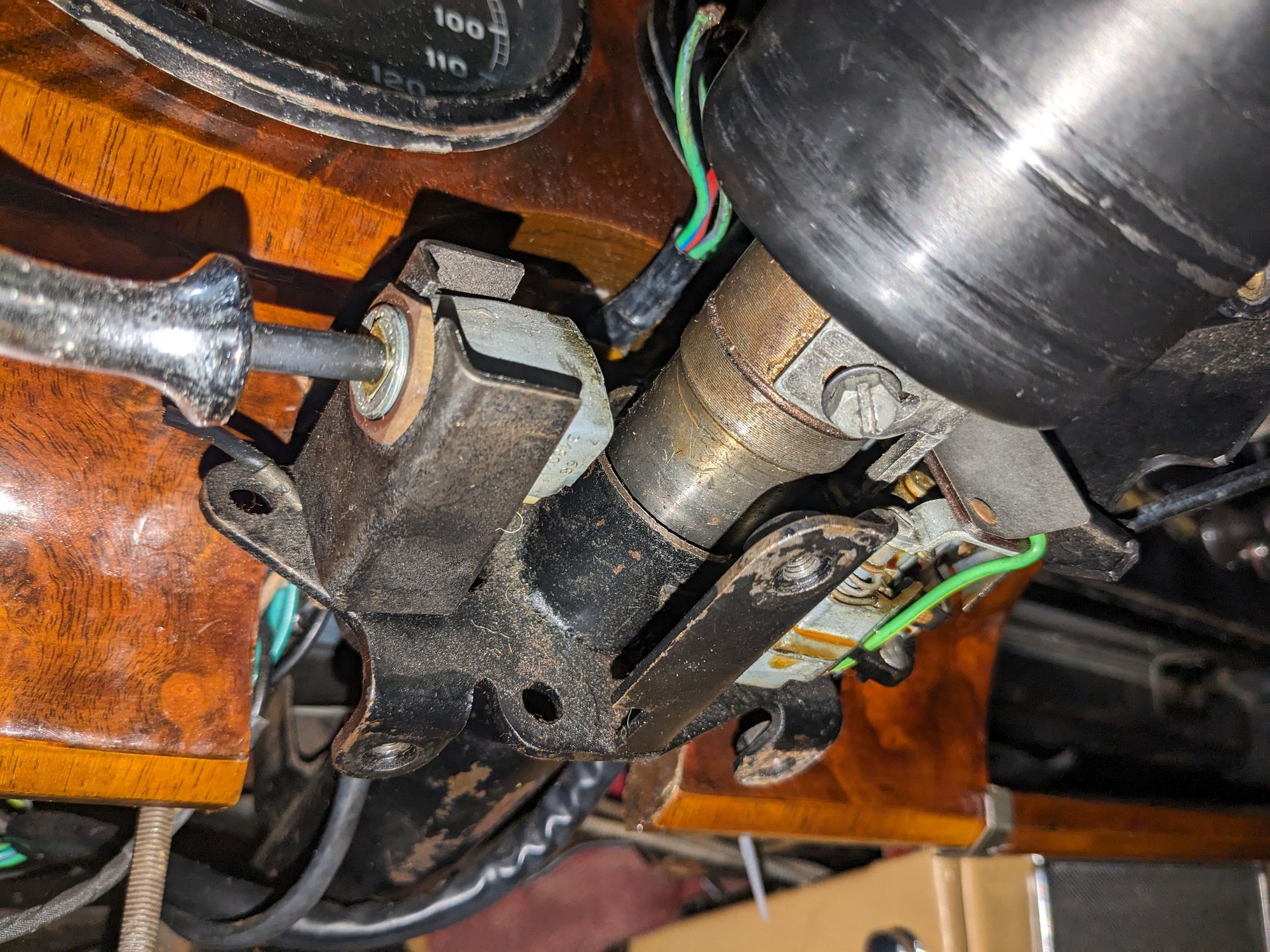

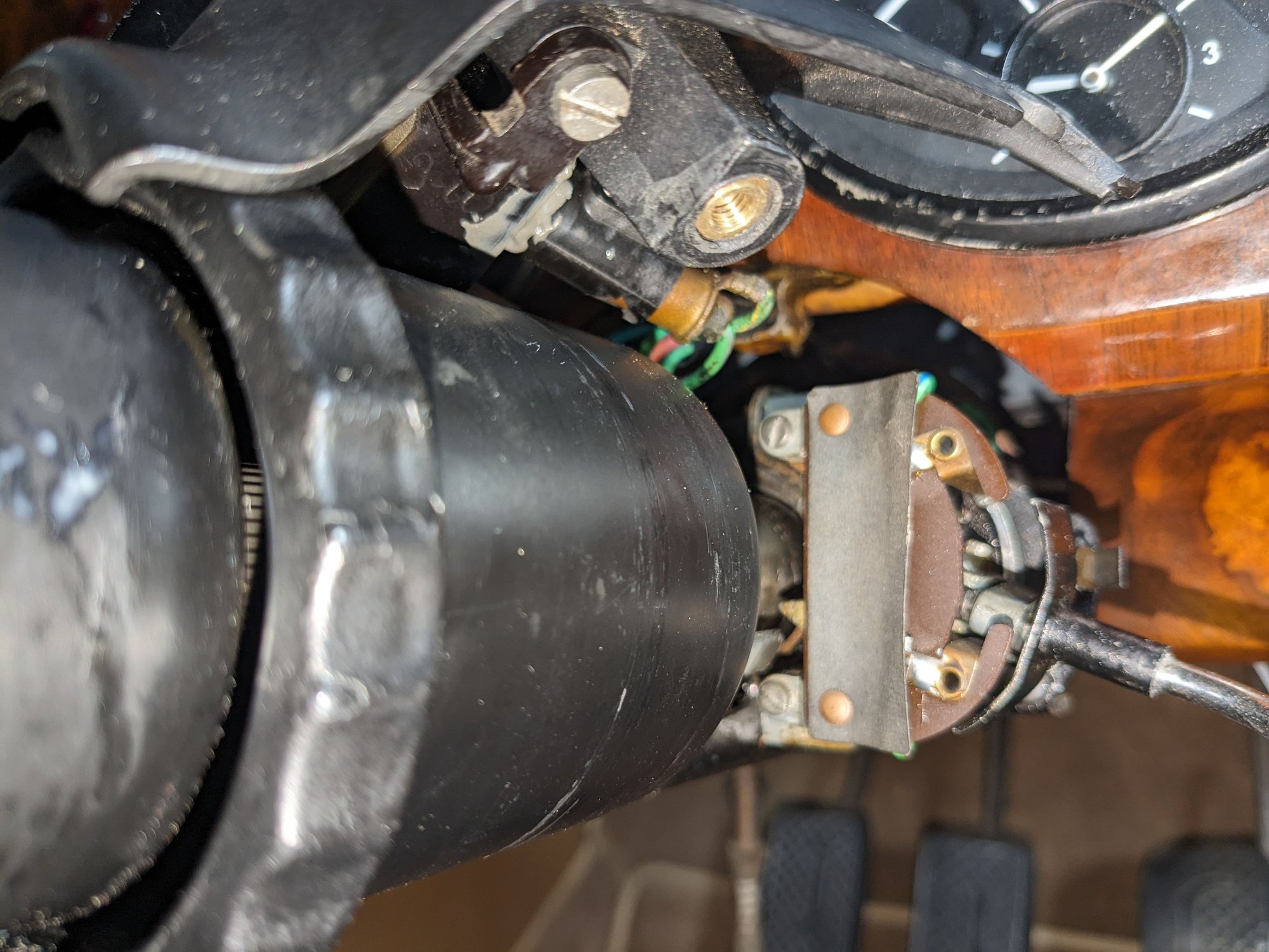

Old Oct 30, 2023 | 02:00 PM
  #38
jjsandsms's Avatar
Joined: Jan 2023
Posts: 235
Likes: 46
From: Sarasota
Here are a few more photos of my configuration. It does appear to me at least the switch has a circular opening for the plastic piece to fit. It also looks like the switch mounting is unique to it being on the right, so I cannot mount it on the left. Not that I want to do that. So the question is will this piece work with my switch?
https://www.ebay.co.uk/itm/275499574...Yv3vgEdQ%3D%3D
I am inclined to think it should as If look at my photo 2, I have the switch engaged for a right hand turn. You can see the tang sticking out and the metal protrusion that is to engage the missing plastic ring. In the eBay listing above there are a few photos of the plastic ring integral to a switch, exactly the configuration that I should have if the ring was in place..
Opinions?
Old Oct 30, 2023 | 02:32 PM
  #39
Jose's Avatar
Posts: 9,145
Likes: 2,665
that switch looks like the one in my '65 S type in the way it attaches to the column via two screws.
Do they all attach the same way?
it somehow looks reversed, i.e. tha part facing the driver should be facing the dash ?? Don't know, just guessing.
Old Oct 30, 2023 | 05:02 PM
  #40
Glyn M Ruck's Avatar
Posts: 5,546
Likes: 1,495
That old switch is pre May 1960 when the steering column stalks swapped sides. I doubt it cancels. The photos don't help. I've looked in the Lucas for Jaguar catalogues going back to 1960 & it's not shown. I don't have older catalogues.
