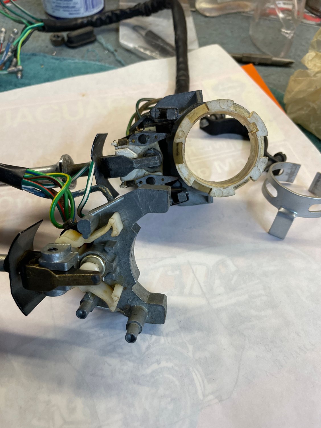

Does the metal tab rotate with the steering column? I can see wear marks on it that look like they are from the the canceling point on the turn signal. Maybe it needs to be adjusted?

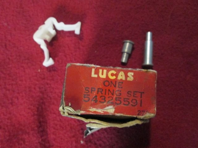

I have stared at that pic for hours. It is prior to switching the unit from RHS to LHS of column. However I think Jose is right. It needs the plastic spring to cancel. It looks odd because it is on the RHS still.
Needs this. Readily available at Barratts. Just the plastic part.

I have a turn signal switch question and thought it might fit here. Best to keep everything together.
My car is a very late 66 Mk2 but II am not sure if the correct steering column is in the car. It was completely disassembled and I received two complete columns with the car. I don't know if I installed the correct column.
The turn signal switch was working but not reliabely canceling. In addition, it is sloppy and looks terrible. I have a NOS unit in my stash but it is not a direct replacement for the switch in the car. The NOS unit box says Lucas 34563 which seems to match up with C20685 which now maps to C25255 on the SNG web page. This is all confusing since below the plastic spring version is referred to as the old switch. In the attached picture, the NOS is on the bottom.
Since I have the new switch and replacemets are very expensive, I would like to use it but I cannot figure out what is supposed to trip the cancel spring. The disk from the current arrangement does not work and the metal clip that holds the disk in place will rip the springs off, anyway, so that can't be right. Is this usable? If so, what do I need for the cancelling cam?
