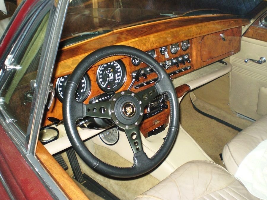

Moss Motors in California and UK sell the Tourist Trophy wheels and proper hubs. Those wheels are high quality and they are available in wood rim or leather rims, as well as thin or thick grip rims. They are all 15" inch diameter steering wheels compared with the 16 and 7/8" diameter of the original factory wheels. (also known as 17" inch diameter).
I have the black leather / black anonized spokes Tourist Trophy in my '65 S type. I ordered the hub kit from Moss with the steering wheel. It comes with the Horn Push assembly and a miserable silly center emblem. Fortunately I had a beautiful MOMO GERMANY emblem which I adapted to the Tourist Trophy horn push.

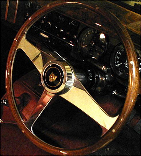

Jose's nice mod to the hornpush
Custom hornpush on a Derrington. Woodwork by British Autowood. (no clattering horn rings on the bottom spoke).
Look a lot better than the standard Moto Lita hornpush.

Yes that is the MOMO emblem, happened to have the same diameter as the MOMO horn push center.
However, the black leather MOMO Olympic (first picture), I have in my XJ has "MOMO GERMANY" engraved / punched in one of the spokes on the rear. I purchased this wheel in 1990 before Ford sent "cease and desist" letters to aftermarket accessory producers prohibiting them from producing Jaguar logos and motiffs of any type. Maybe these wheels were being made in Germany at that time. It came with three horn push emblems., the gold Jaguar growler, a silver Jaguar Leaper, and a yellow "MOMO" logo emblem. ( Ferrari yellow ).

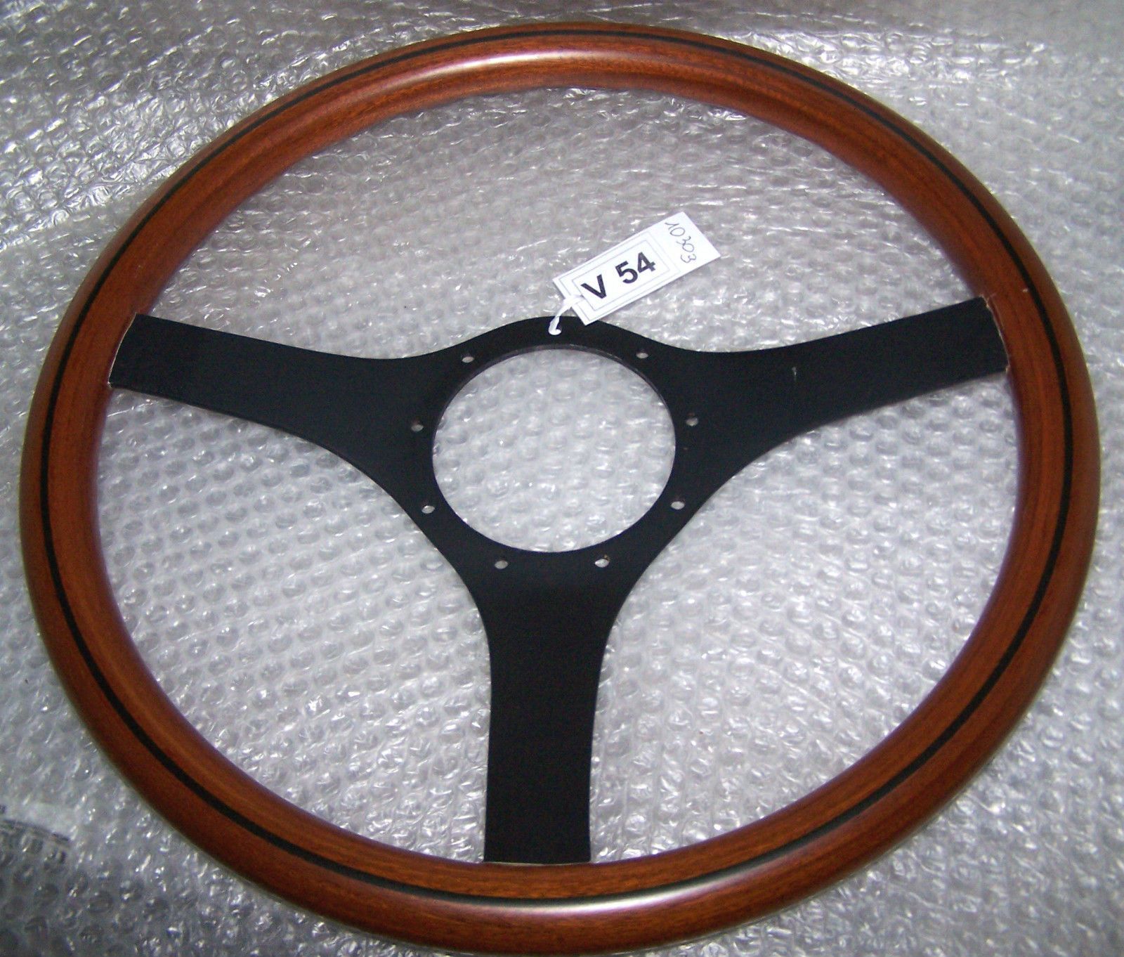

also have another MOMO steering wheel but in wood, that has MOMO ITALY engraved in the rear spoke. (second picture)

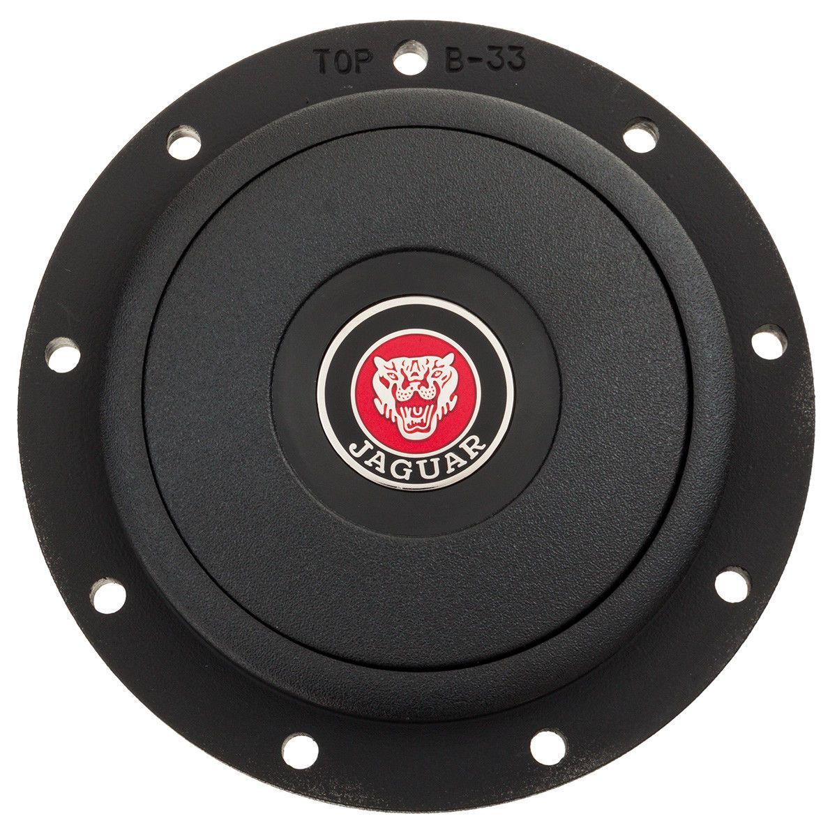

The standard Mota Lita horn push doesn't look right with far too big an area of very plastic looking plastic. My first attempt at hiding it was to stick a larger badge on top. The final form is more likely to be to use a MK1/XK150 horn badge/button.

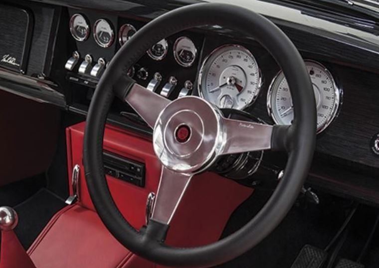

The standard Moto Lita Hornpush is awful. Fortunately they make a metal one too turned from billet but the logo is still too small.
Ian Callum's car

It's OK in Callum's design exercise, but, for me, it's still not 1960s Jaguar enough for my car.
