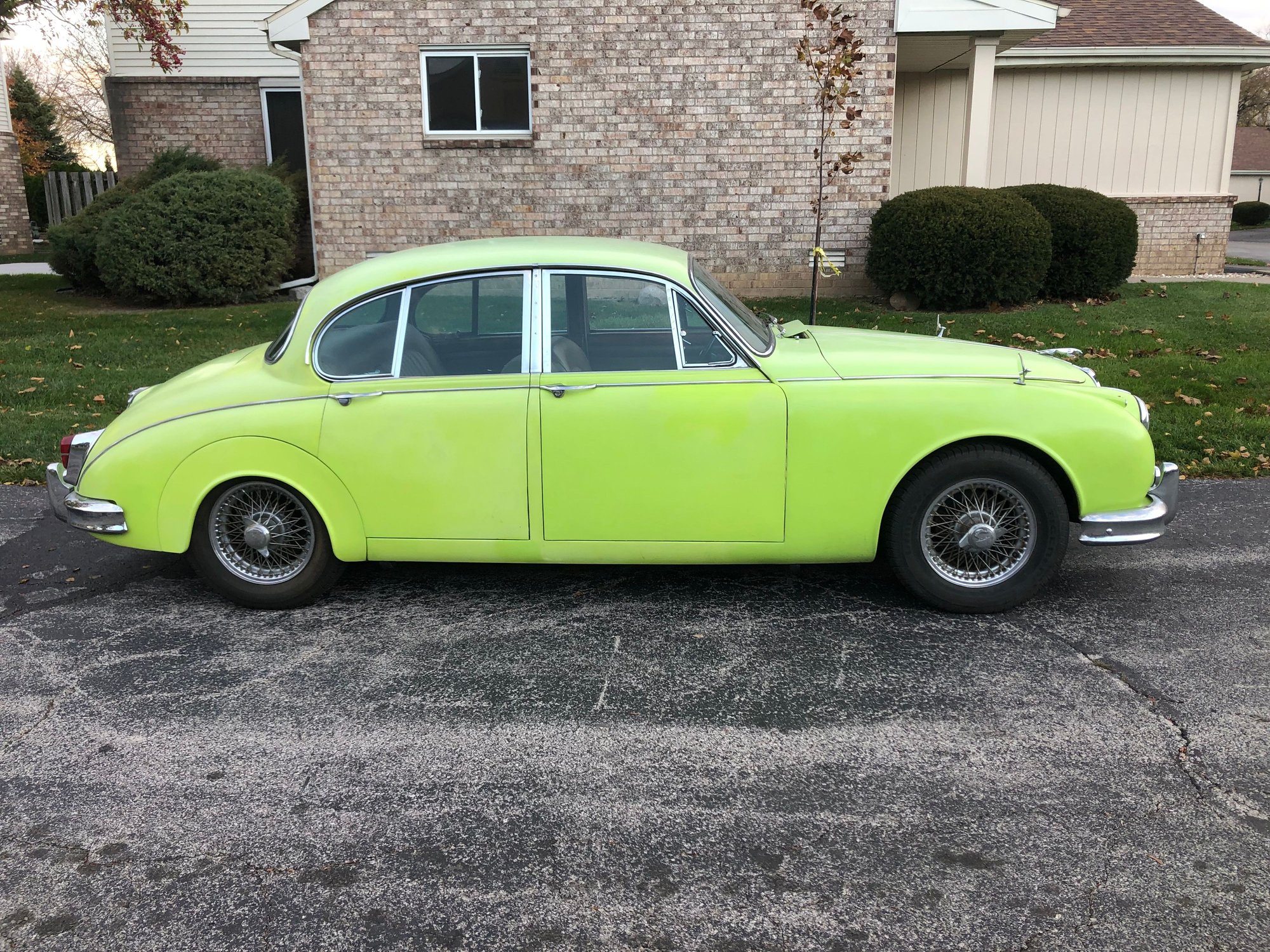

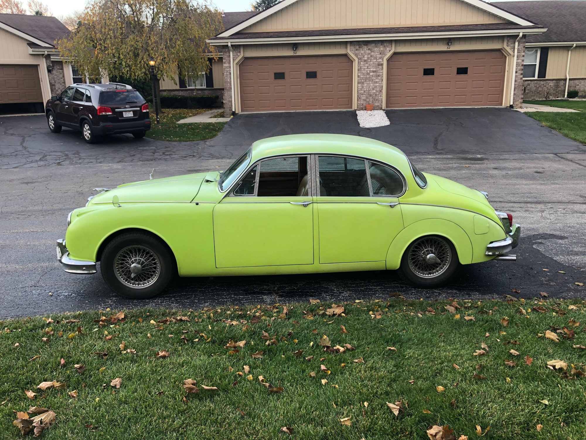

As you can see she’s sitting low and the tires are rubbing.

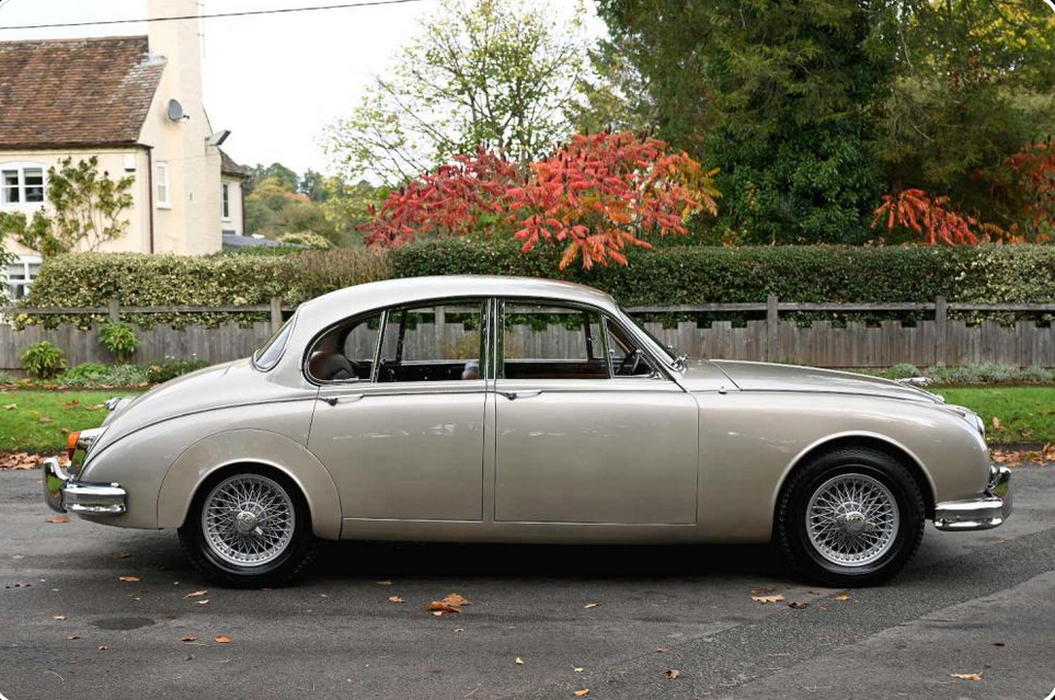

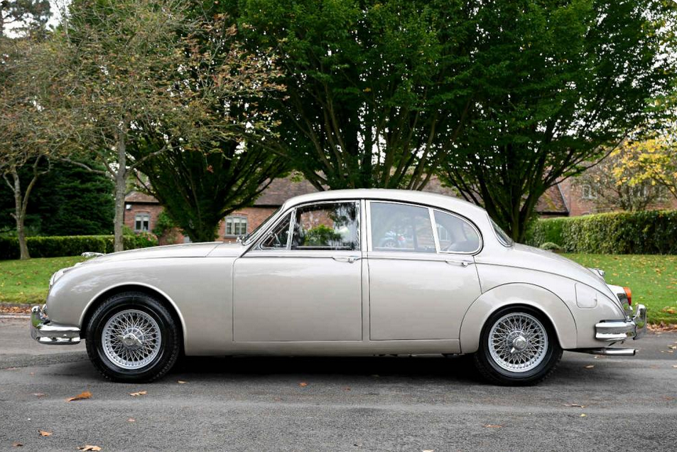

Default Jaguar Mk2 Stance.
This is about the correct stance for a Jaguar Mk2.

Your pictures are taken from higher up which distorts actual ride height. i.e. in your pics you can see more roof.
I noticed that. Also the tires were hitting. So maybe I’ll replace all the bushings when I reinstall the rear axle and see how she sits. I don’t mind saving money on new springs. Thanks. BTW your car is beautiful.
