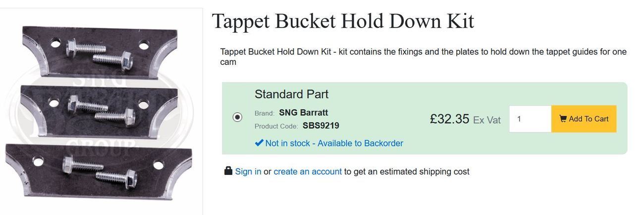

Hi Glyn. Yes I watched someone on YT fitting those. Guessing that's a heads off job. Will investigate. Thanks for this. Have you ever done the shims? Is that a faff or doable?
No ~ you can do it head in place if this is your issue. Homer has covered the shimming of tappets.

Right, just to clarify. Heads have to come off for shims, but stay on for guide fixings? Your talking to a Ford V8 man. Only ever stripped down old mustang engines. Sorry if this puts me over on the dark side. I'm loving working on the Jag engine though. Teach me all you know obiwonkynobbi! (spell check loved that word!)

No wrong the head can stay on for both but you could remove the head for both as well if you wanted to create a lot of work for yourself..
Shims are on top the valves which are under the cam shafts but on top of the head. To change the shims you will need to remove the camshafts which means the cam covers need to come off but the cylinder head remains in place. Shimming the valves requires a lot of measuring with a micrometer, buying the correct shims required, fitting them and then measuring again. I let my local Jaguar specialist do this for me. Cost the same amount as buying a shim kit and doing it myself.
The stakedown kit can be fitted with the head in place no need to remove anything apart from the cam covers. Problem with the stakedown kit is you have to make some holes in the aluminum head to bolt them in place. There are two types of fixings.1. Self tapping bolts which you do not need to drill any holes for you just set the stakedown kit bar in place and then drive these self tapping screws/bolts in to the head. Not my choice.
2. The other kit which is what I went for involves drilling holes in the head. Sounds bad but is not really. The kit comes with the correct drill bit and a thread tap to match the allen screws supplied in the kit. The cams can remain in place. You set the stakedown bars in place mark where you need the holes and drill away. The swarf is aluminium so a small amount is not going to damage the engine but the idea is to drill a little at a time cleaning the swarf out as you go on. The drill will finally break through the head but only in to another oil way, not in to a combustion chamber, waterway or exhaust port. You then have to tap a thread in to the hole using the tap supplied. You have to make sure it is upright and that the tap is greased. Greasing the tap means the swarf you create from drilling and tapping the hole sticks to the drill and tap which you remove constantly to clean as you go deeper. Once the holes are tapped and all the swarf cleaned away the stakedown kit can be fitted. I put lock tight on the threads of the allen screws for piece of mind and did them up as tight as I thought was good by hand.

No, the head stays on for tappet shimming. What can be a real PITA is carefully measuring everything, then fitting the correct shim to correct the clearance, putting back the camshafts only to find some clearances are still wrong. Been there, done that !! What is particularly important is to not rotate the camshafts disconnected to the drive chain, i.e.check clearances by turning the engine over at the crankshaft, and only then remove cams, check shim clearances and insert ones to make the clearance correct. Usually thinner shims are needed than are found in the engine, so must be purchased. A micrometer is also essential as most shims will have lost their identifying letter.
It is my understanding that earlier engines didn't suffer from tappet guide loosening, it was later engines especially those in the XJ salooon starting in the 70s, and probably is related to the dreadful deterioration in quality throughout the whole car. This was at the time when England became basically ungovernable.
Rob ~ I was hoping you would comment as you did the job recently so it's fresh in your mind.
BTW ~ I think that the Allen cap screws supplied with some hold down kits are a more elegant solution than the Barratts bolts.

As mentioned above the head can stay on for both, don't take the head off unless you have to as its a lot of work and really heavy!
