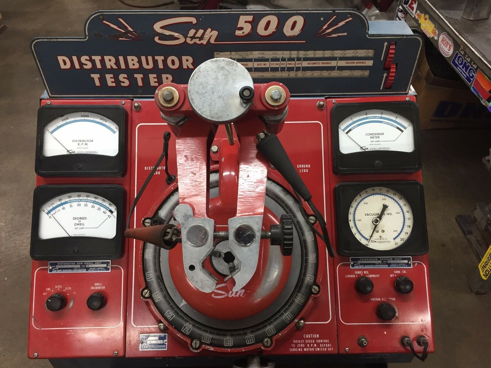

You need one of these to set up mechanical & vacuum advance on Lucas distrubutors. There are a whole host of competent companies in the UK that can do this for you. I have a very large table of specs for different model Lucas distributors & their specs should you ever need it.

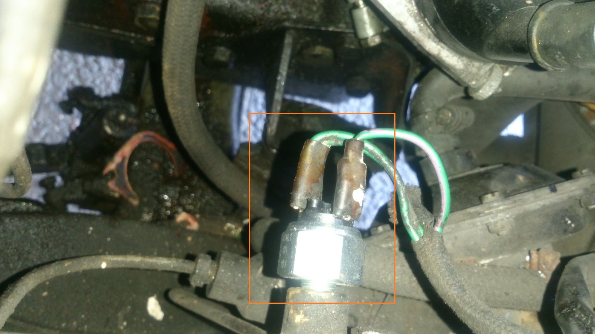

The oil pressure is reading a healthy +/-45 while driving, sinking to 20-25 while idling. Actually both last year and this season the oil pressure gauge has on several occasions suddenly dropped to zero very fast, and just as suddenly raising back to normal readings. So my workshop put in a new oil pressure sender 2 weeks ago (picture), and the gauge has steadily read the reported values since.

What is shown in the photo is the brake light switch, not the oil sender.
The oil sender for the gauge is close to where the oil canister is next to the block.

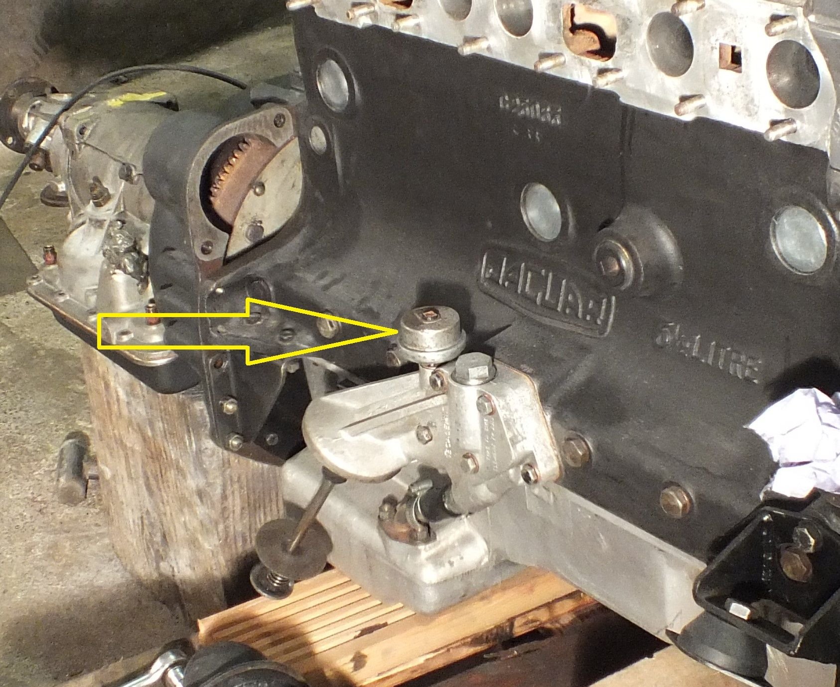

The item you have pointed out in the photo is as Jeff has stated the brake light pressure switch and has nothing to do with the oil pressure. Below is a photo of where the oil pressure sensor is sat on top of the oil filter housing. If your garage has changed the brake light switch and told you it is the oil pressure sensor then I would ask for my money back and not use them again as they are incompetent. It is clear to even a child that the brake pressure switch is at a junction of brake pipes on the right inner wing and nowhere near the engine.
Oil pressure sensor on top of the oil filter housing.

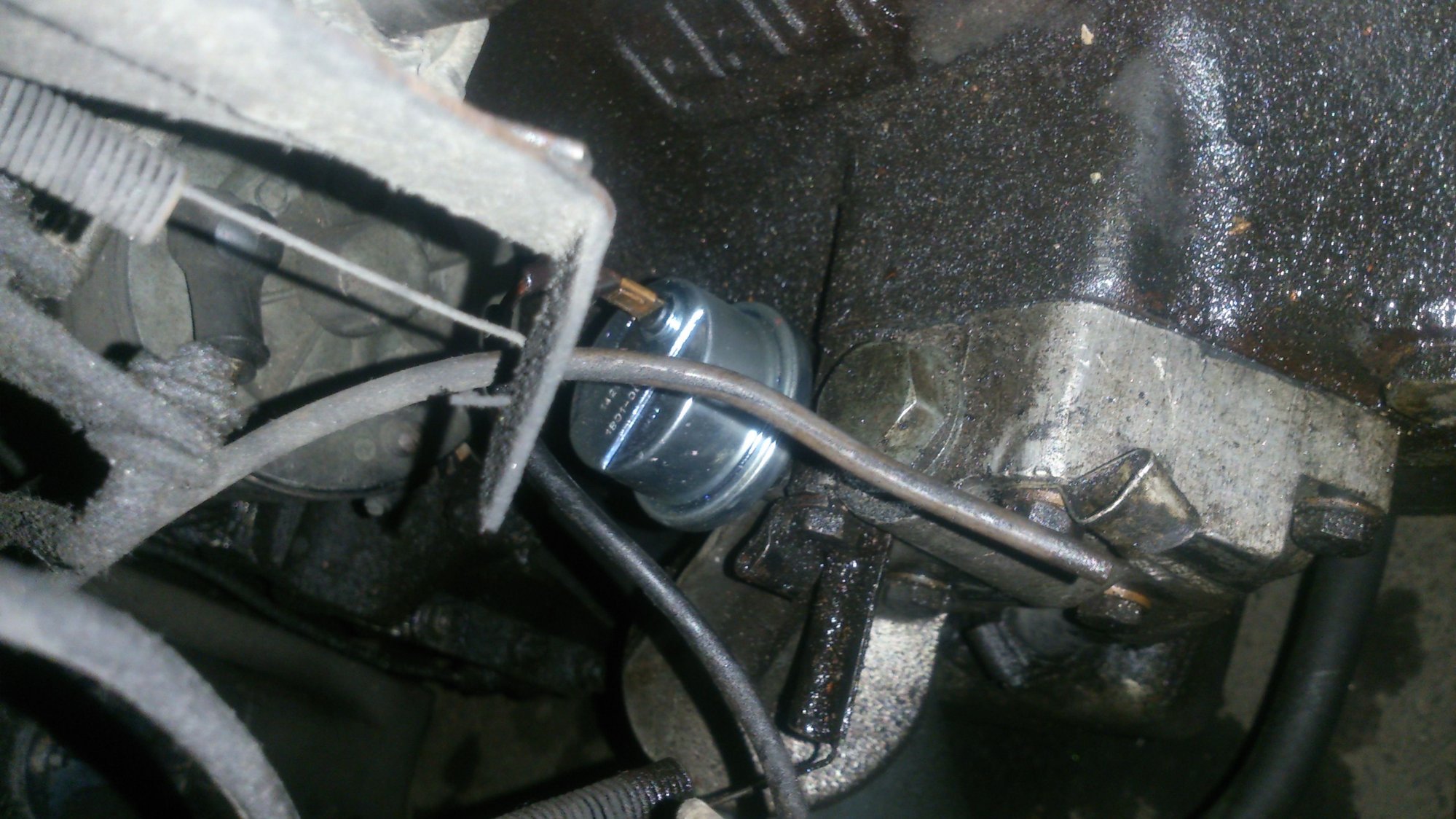

Sorry my bad, it was late and I uploaded the wrong picture, here is the brand new oil pressure sensor.
I guess I also got a new brake light pressure switch at no added cost, kudos to my workshop for that :-)
