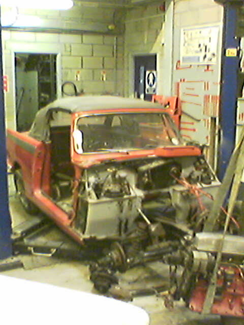

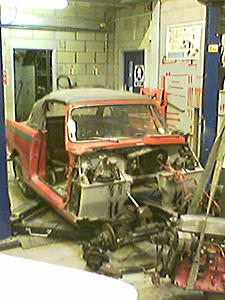

I have undertaken restoration and renovation work in the past, I rebuilt my Triumph Herald from a rough condition into what she is today. I bought that car off my mechanics teacher, and I love her very much. I learnt an awful lot from both my teacher and working on the car. My skills and discipline have both developed significantly over the last 11 years. I feel that this combined with all the work I've done on X308's and other people's cars over the years has given me enough confidence to tackle a MK2.

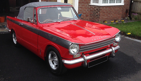

That's all for now, I look forward to your responses. I've added some photos of my Triumph before and after so you can see I've already had some restoration experience.

My Triumph has the Vitesse 2.0 Straight 6 engine fitted, mated to a 4 speed gearbox with O/D on 3rd and 4th. I've recently had to replace the solenoid for the O/D which was a task and a half!
