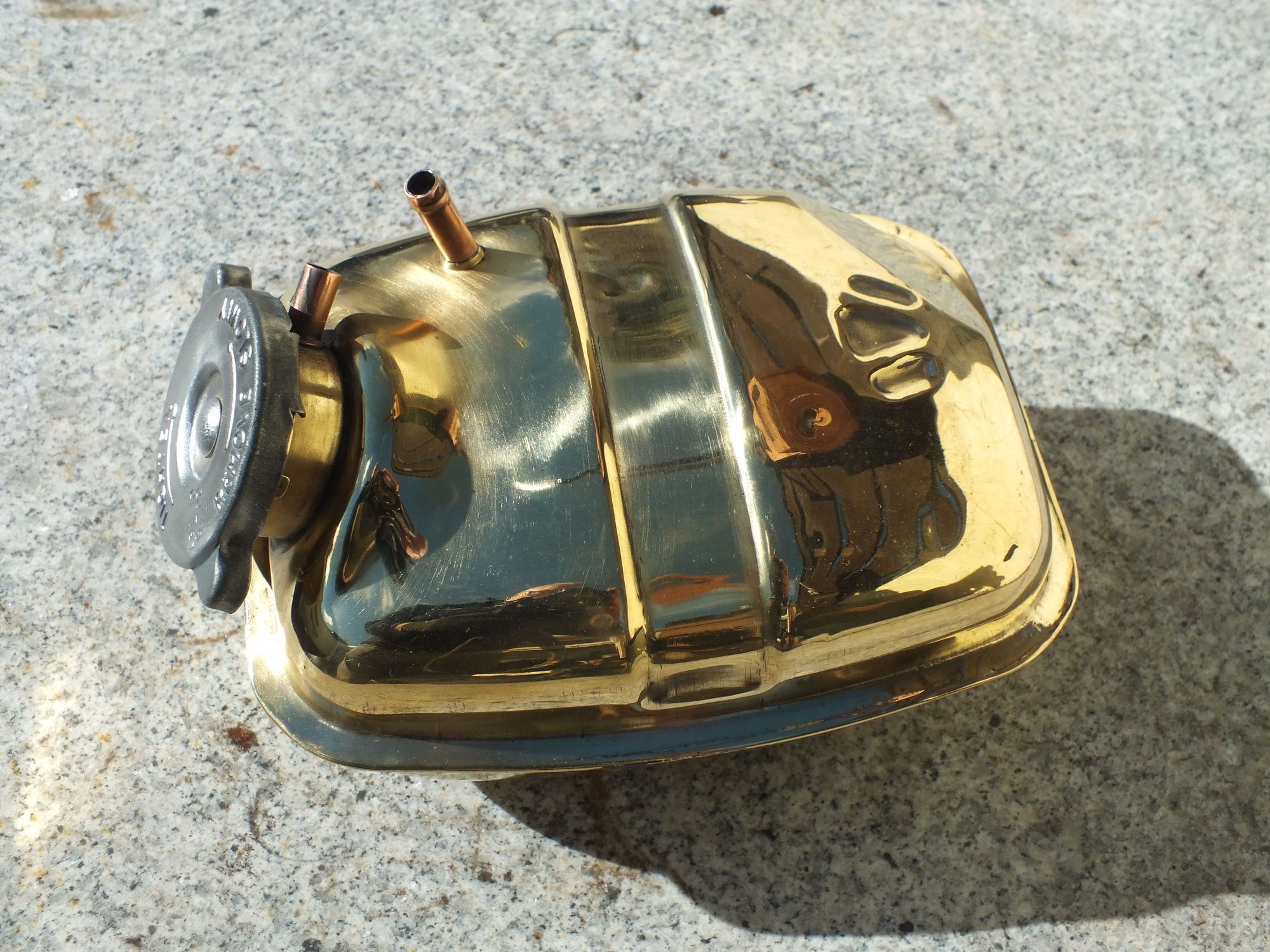

Already have one polished up and ready to fit Glyn. Just waiting for some slightly warmer weather.

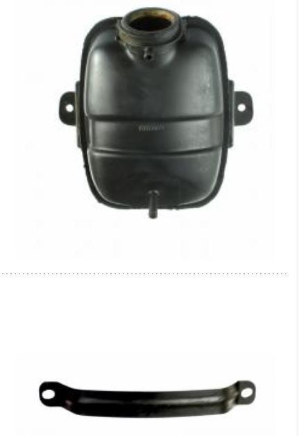

Snap. I think mine was supposed to be for a Leyland Princess 2200. Good old BL!
I looked on ebay for the Volvo 1800 type. It's a nice shape, but oh the price for a plastic bottle!

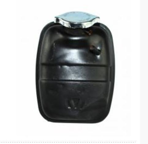

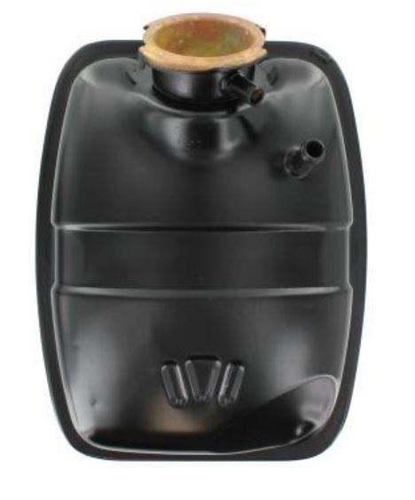

There are a couple you can get hold of. One is about a litre capacity the second is about a litre and a half so a bit thicker in shape. The one I have is an expansion tank so it only has one inlet at the top and this pipe runs to the bottom of the tank so it can suck the water back up into the radiator when it cools. There is a third tank that has an inlet at the top but a short pipe inside. At the bottom it has a second larger outlet. This type of tank is used as a header tank and no good as an expansion tank. The photo you showed is of the third type ie header tank, as it has an outlet at the bottom.

Yes ~ I intend using the one you chose Rob. My first pic.

Yes. These were used on a number of BL cars including some MG's & now cost an eyewatering GBP 104.00 new from Moss Europe without strap or cap. Dents are free!

You can buy them secondhand on Ebay for between £30 and £35. Here is one https://www.ebay.co.uk/itm/Triumph-D...sAAOSwTzlfitrE obviously needs a polish.
I have two one polished and one yet to be if you are interested Glyn. I can polish it up for you and send it over to SA.

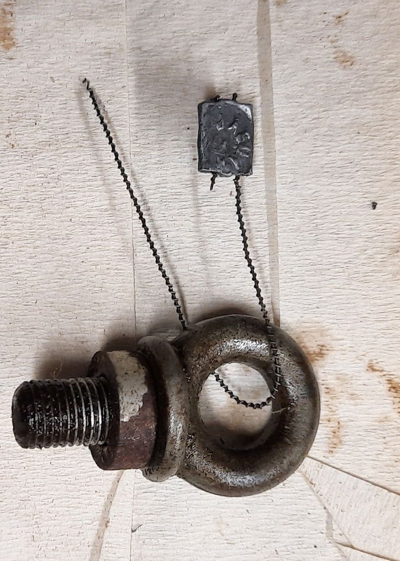

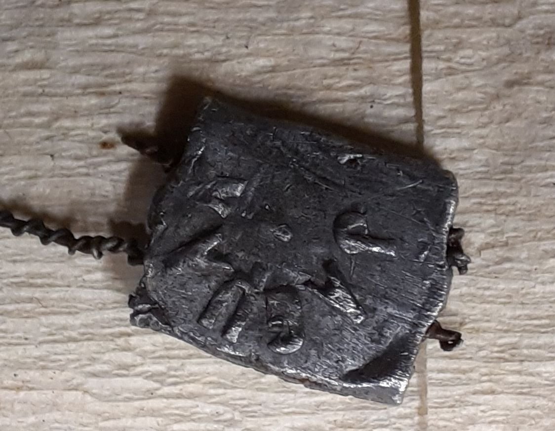

Default lead seal on safety belt eyebolt
Hello guys,
I found in my S type 1965 (exported fo the USA) this lead seal next to the eyebolt for attaching the seat belt. and I'am curious if someone else has ever seen such a lead seal.
Greetings,
Hans

I have seen seals like that in other car parts, back in 1979 my Saab 900 Turbo had one in the Turbo adjustment so nobody would mess with it. It was a mechanic's seal.

Jose,
I know where it was/ used for but I like to know, just out of intrest, if it was common practice for all Jaguars or only for export cars.

Hans, I have never seen any lead seals on seat belt eyebolts. It doesn't make sense unless it was put there as a Warning to prevent the seat belt from being removed from the eyebolt? So whether it is export or domestic practice I do not know.
