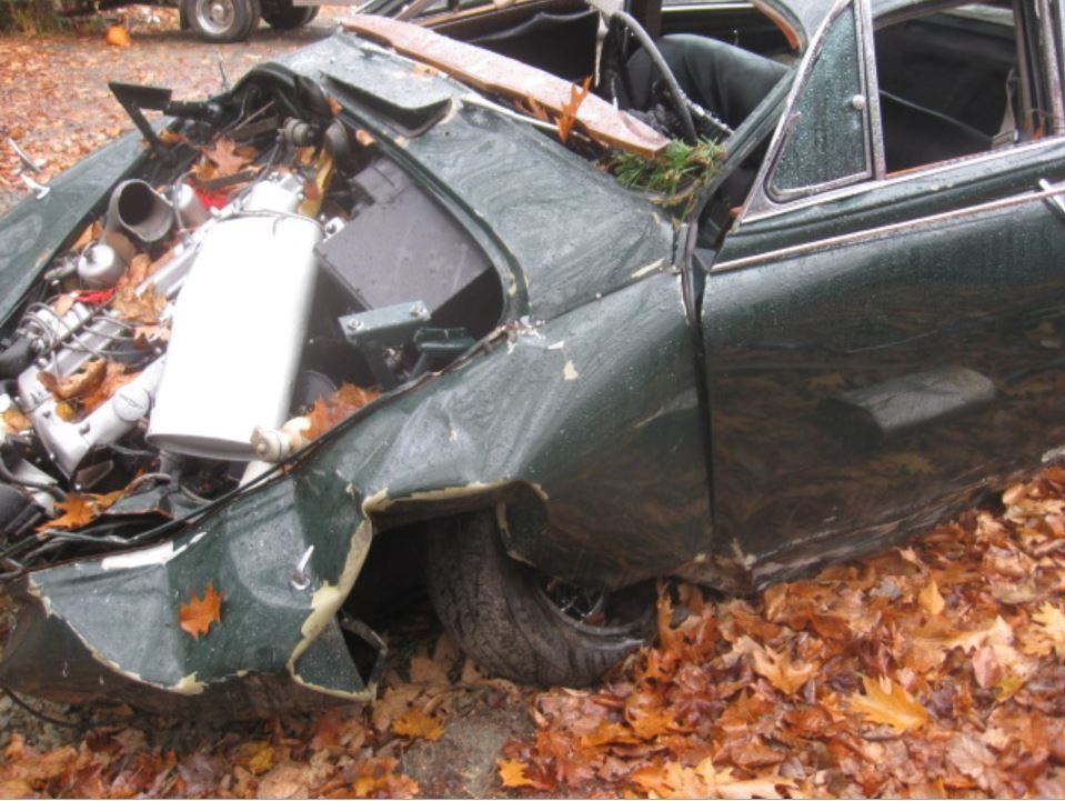

I don't want to ever see this. We don't know if brakes played a part ~ the car left the road & went down a gully & the front subframe tore loose from it's mountings. Driver survived (or I would not show the pics) ~ Many broken bones, feet, legs & spinal damage.

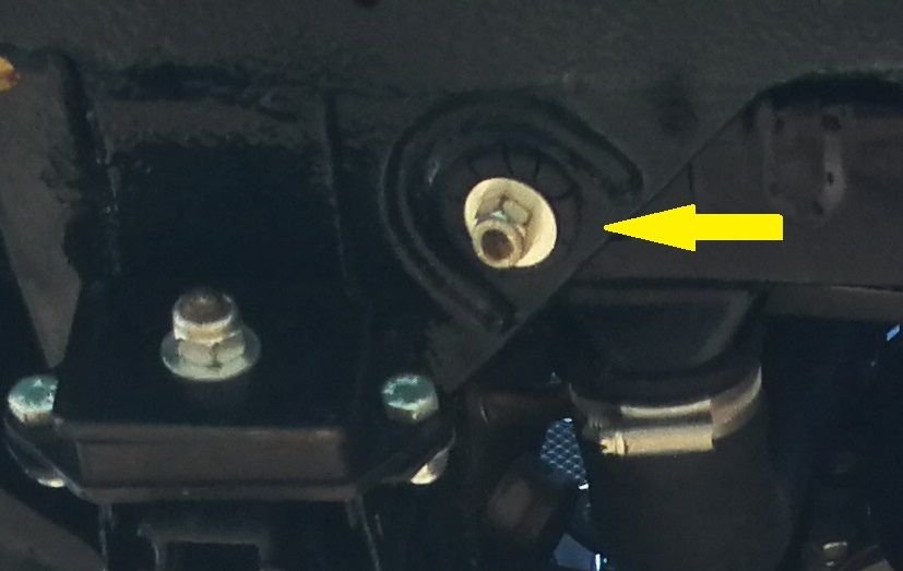

Regarding rubber seals you might well be onto something there. We have seen a number of fluid and temperature exposed seals actually split. A bit of a worry & of course original source unknown. "Rubber" is a bit of a black art. We provide base oil dewaxing extracts to a number of rubber plants. If it is Michelin you know the end product is going to be thoroughly tested. If it's some small operation churning out basic seals, rubber bushings etc. you don't know what you are getting.
The radiator mounting bushes provided by Barratts had split on my car within 3 months of fitting. Had to change them again.
Excuse picture quality. I've blown up a small portion of a much larger pic.
