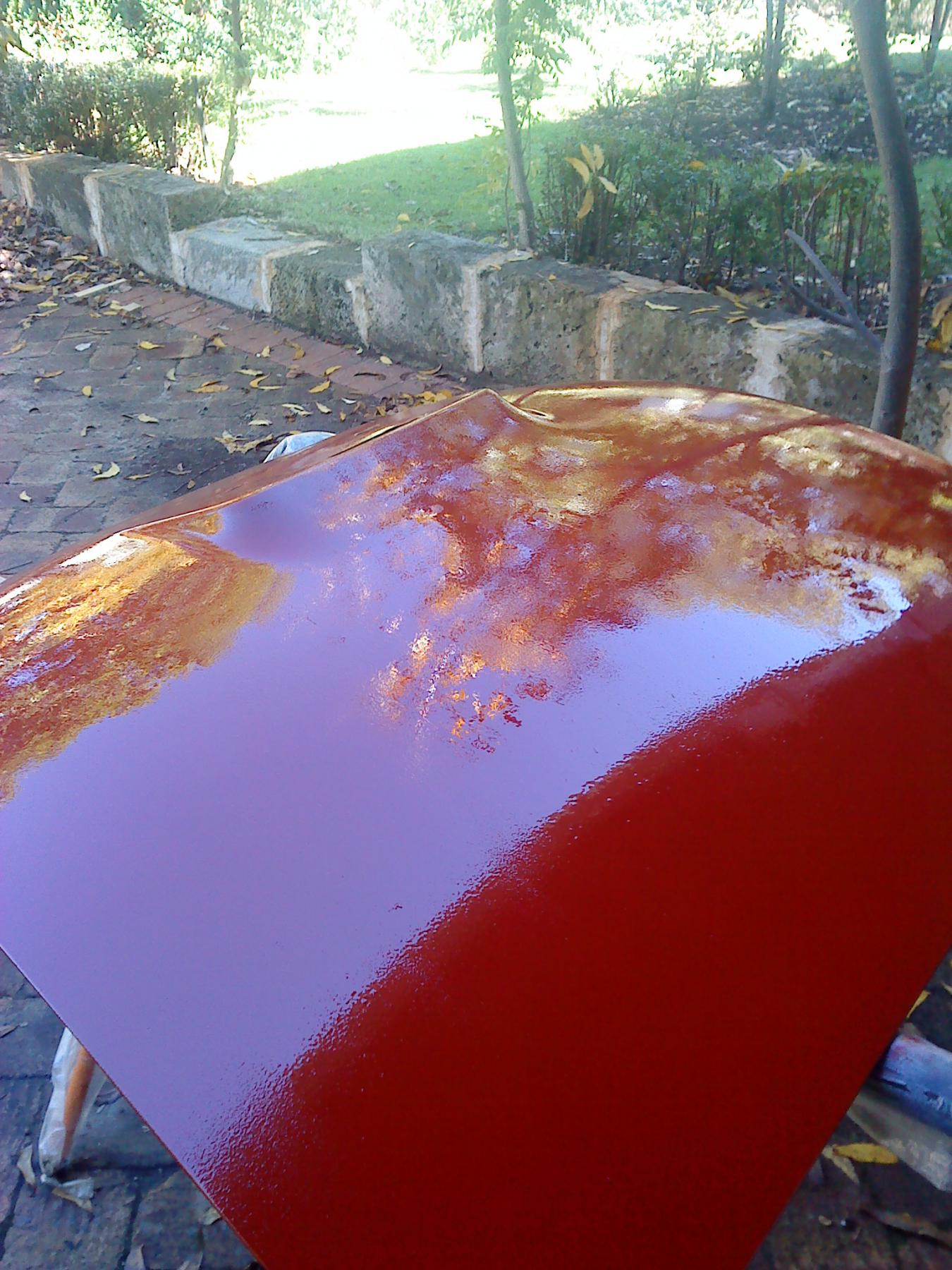

I have used the POR 15 with some success. This is a picture of my boot lid painted with por 15 with a 4" brush. This is with no high build primer or any other filler.
I have thought about painting the car as I have done the rust repairs myself.
I have looked at enrolling at tech college and learning how do it but nothing replaces experience. Then I looked at vinyl wrapping. This may be a good option as costs about a grand for materials , lasts up to 4 years (probably longer) , can easily be taken off and replaced. I have no experience with this but (check out you tube) there are many cars that have been done.
Could be a viable option especially when my car is completely stripped all ready.
Glenn

Great job, just make sure not to get any of the POR15 on your skin as it will NOT come out with gasoline, paint thinner, etc. you will have to wait three months for your skin to peel.
I am not a big fan of wraps for main paint. I like it for highlights like logos, etc. I know it is expensive to paint a car but I think it is worth it. You could go with the clear wraps after you paint in the front to avoid rock chips.

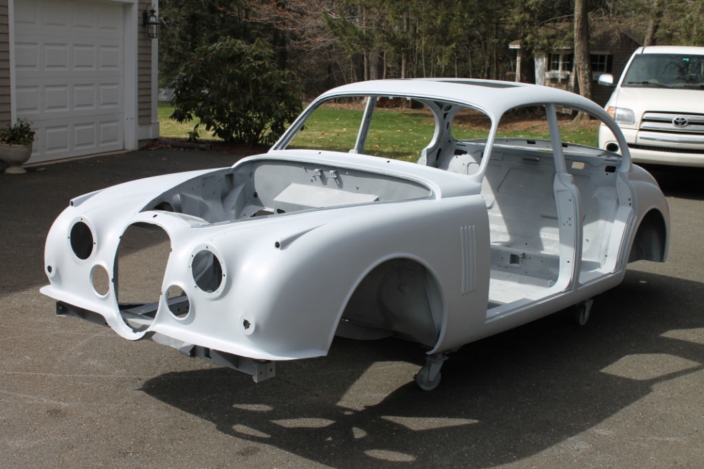

We pushed the tub out into the sun to look for flaws in the bodywork. One final blocking and it's ready for the painter. I picked up the panels and am very please with the results. They'll remain in the basement in an unused room out of harms way until the end of the project. If you've got the time I've learned body work isn't difficult - just very time consuming if you don't know what you're doing. Another week or two at the painter's and we'll start the assembly. I'm relieved to have this part of the project behind me - hopefully it's downhill from here. Yeah, I'm sure...
If anyone knows where to get that adhesive-backed vinyl wrap that new cars are covered with for transport let me know - I'd like to cover the paint and hopefully avoid some of the inevitable scratches during assembly. Thanks.

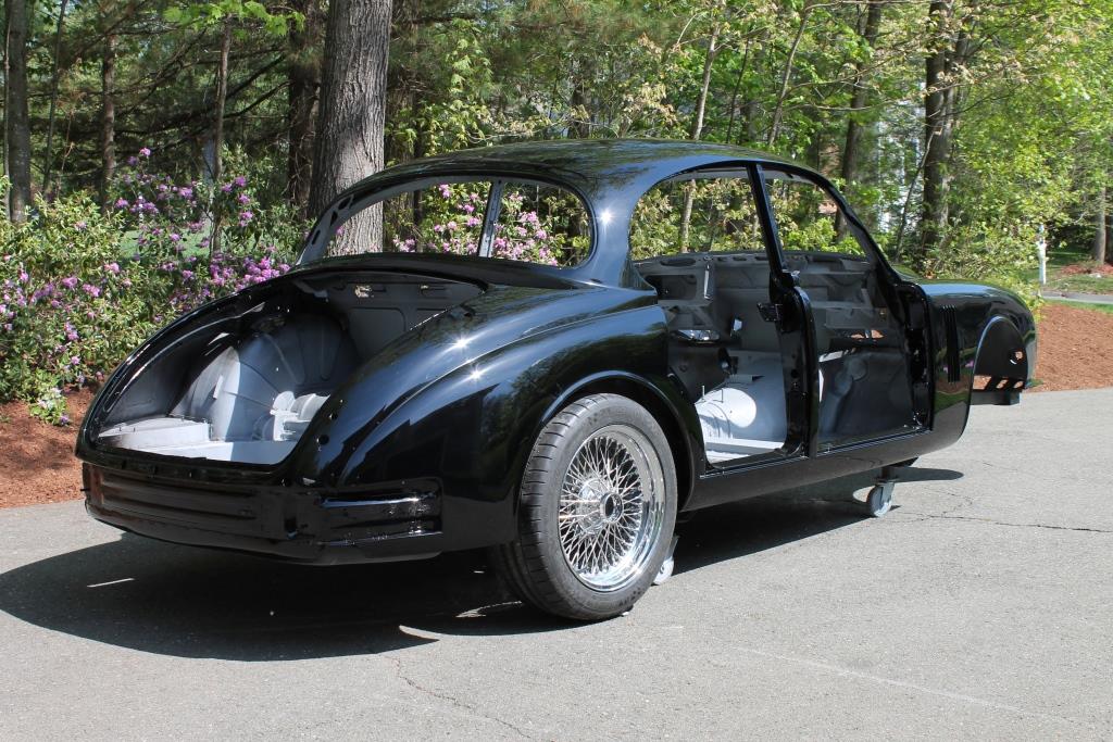

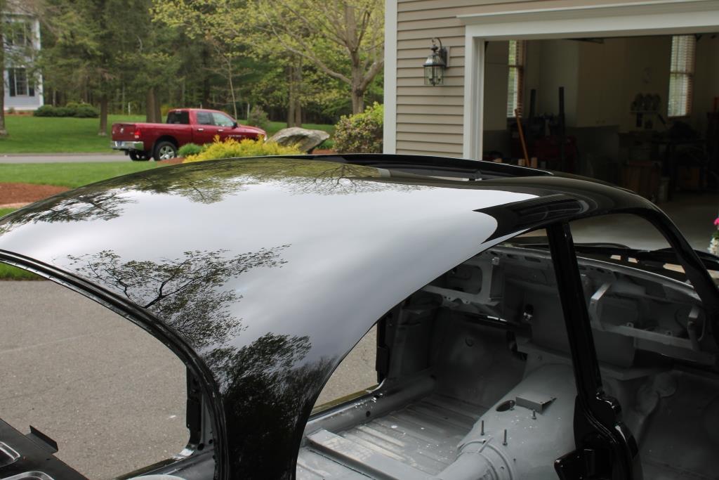

We picked the tub up from paint and I'm really pleased with the outcome. The painter's work was first rate - the do-it-yourselfer's work wasn't bad for a first timer. The roof is dead straight despite cutting that big hole in it, and I really like the look of the shaved gutters - the chrome window frames should set these lines off really nicely, and hopefully we'll have less wind noise at the A pillars. I see a little distortion around the louvers where the panels were welded in - hopefully the painter can shoot a few coats of clear and reblock the fender sides to get them straight. We'll do this when the finished car goes back for the inevitable paint repairs and buff out. The painter advised against applying any protective film during reassembly since even after baking, solvent continues to flash off for months and trapping this can damage the paint.
Primaz, the paint supplier told me not to use Por 15 since this is a bare metal treatment. Since I already applied epoxy primer to the tube bottom the recommendation was to shoot a single stage urethane paint and top this with a 2-part urethane truck bed liner. I had planned to apply undercoat to cut down on road noise so I'll give this a try. The thought of mounting the finished tub on the rotisserie doesn't thrill me. No idea why I didn't think to finish the bottom before sending the thing off to paint. Live and learn...
Dave, I forgot to shoot pics of the front window frames - will do so for next post. In the meantime I hope you enjoy these - making progress!

Actually they are incorrect about it being a bare metal paint. POR-15 undercoating goes after the car is at bare metal and after the POR-15 nickel oxide metal prep paint coating is applied, then the POR-15 is applied. It is up to you but a nice thing with the POR-15 is it can be applied without fancy paint guns, etc. and being right on the Pacific Ocean I can attest that it works. To me painting it twice is a just as much work if not more as that needs to be via a shop. If you go their route you might consider the Rhino liner.
