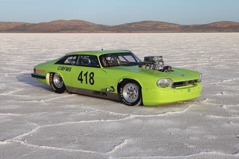

I am new to this forum and just wanted to let you all know about my land speed Jaguar that I race on Lake Gairdner, a salt lake in South Australia.
It is now the fastest Jaguar in the world with a average speed of 237mph over a flying mile. It is a 1984 model XJS with extensive modifications.
I will try to post some photo's but the build can be viewed on the build forum on the Dry Lakes Racers Australia (DLRA) website.

That is a spectacular effort! I can only imagine how fast your heart must have been racing. I get a little lightheaded from adrenaline just hitting speeds that are a fraction of what you have achieved.

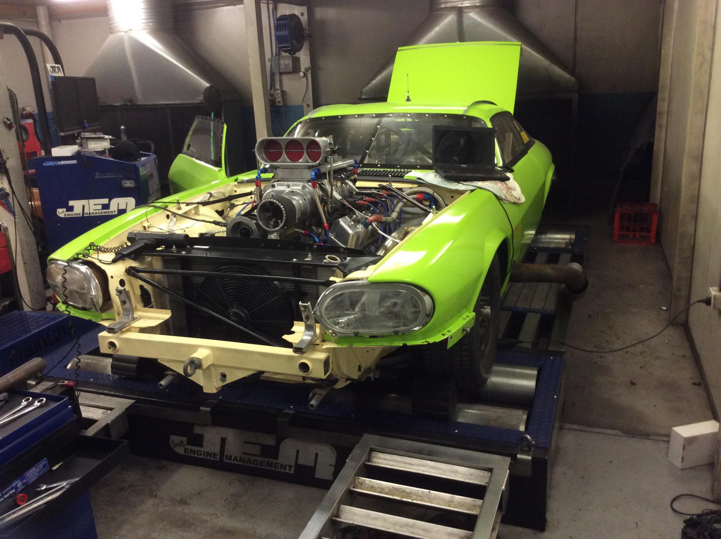

The car is extensively modified and with each modification safety was my main concern. 240mph is very fast and the problem with salt lake racing is that if something goes wrong I can't jump on the brakes and get out. Without the 'chute it takes a long time to stop so if there is a fire it can be like a blow torch with the force of the air pressure. I made the cage super strong, I have two completely separate fire systems with two large bottles each with two sets of nozzles. One actuated by cable and the other pneumatically.
Anyway, yes I have a lot on my mind at that speed but it is a buzz.
I want to build a v12 so I can keep it all Jaguar. The Ford engine in it now is an engine I had already so to keep the cost of racing down I decided, reluctantly to use the V8. Hopefully all that will change so I can keep my Jag all Jag.
Cambo,
The engine is a Ford Cleveland Arrow block. SRP Pistons, Oliver rods, Crower crank. Still 351 with 6 inch rods. Little field 671 blower with Enderle bug catcher. I am using a MoTec M800 ECU running 12 trick flow 1600cc injectors above the hat. It runs 10% overdrive so about 15psi boost which gets to 17psi at speed. I cut down a Windsor Dizzy for the synch signal and modified a Windsor MSD crank trigger for the Ref signal.
I use a Doug Nash 4+1 box which has no synchro's and is 1:1 in 5th gear. 3.5 inch tail shaft to a 9 inch, Romac fully floating axles with Strange spool, modular centre with reinforced housing. McDonald Bros 4 link with coil overs.
The roof is chopped 3 inches.
The front has new hubs made with Ford stud pattern and cr moly stub axles. Jag brakes front and rear. Brakes are not a big deal on the salt!

What sort of power is the Clevo making?
If your goal is 1200hp & 8000rpm, i'm not sure anyone has built a Jag V12 to that level yet...
There are a few twin-turbo V12's out there, and a quad-turbo currently in the build.
Bruce @ Jagworks in Sydney has a V12 TT XJS, although it's in a bad way after the battery caught fire. Was making ~600hp at the wheels.
There were some twin-supercharged Lister V12's too.
I think 1200hp is a hell of a goal. I can only imagine it'll be >7L with custom forged everything. And you might have to make your own heads.
Most of the V12 discussion is in the XJS section of this forum XJS ( X27 ) - Jaguar Forums - Jaguar Enthusiasts Forum
There is a guy here in Australia who built a quad-cam V12, using the AJ6 4-valve inline-6 heads on a V12 block. http://jenkinseng.com/
Might be worth talking to Mr Jenkins if you haven't already.
