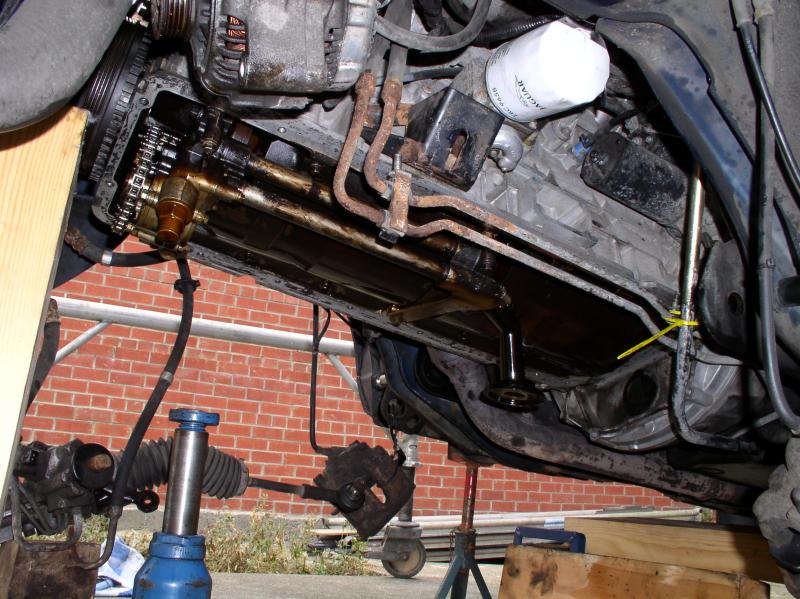

Dropping the pan is a major job as the engine has to be supported from above and the front suspension removed:
Hi everyone, new to jaguar, need help please.-10-x300-sump-replacement-sump-removed.jpg
I did this to replace a cracked pan. It can be done single handed but it took me two days.
