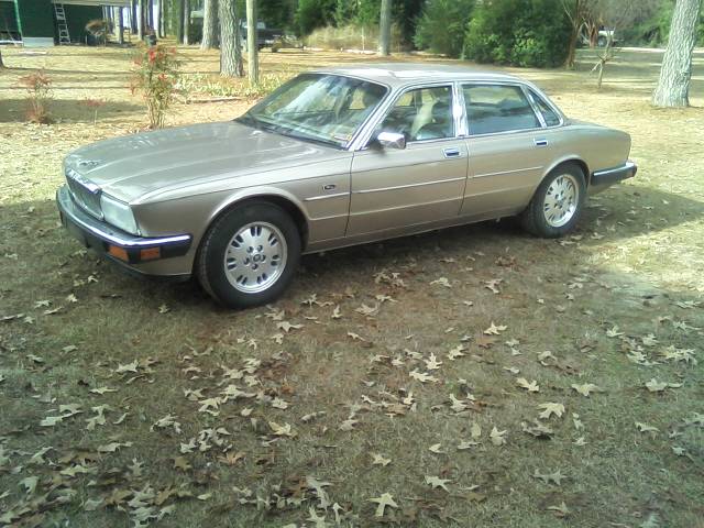

Hi everyone,
My 72yr old neighbor has a 1993 xj6 thats been sitting for a few yrs....im an aircradft mech. by trade(nothing special) but I have volunteered to get her car back on the road. He recently deceased husband was a retired submariner...he loved to take things apart and play easter egg hunt...i got a battery yesterday for this xj6.
I was doing some searches for 'batt. light not going out...and i found this member here I really want advice from but being new, i cannot find where to go to send a private message.....any help please?
its a beautiful car that needs a good clean up....

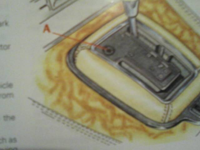

I have downloaded the Haynes manual now and went thumbed through it....great stuff!
I am still baffled by this "Gear-shift Interlock Manual Override" on this 1993 XJ40
I was able to find the screw in cap for but I have no idea where to find its inner workings. I was told by the owner that you have to stick something in there to make it come out of park, which it does, then you can shift gears, no problem...I/they have no idea as to why the owner took this cap off....
I'll move this question to another spot on the site BUT since i got such a Great Welcoming from the you guys, you may lead me in the right path...
Beautiful car for 138k..but has been neglected for some time and needs TLC before it becomes a bigger mess...

Originally Posted by t.rhodes64
........... I am still baffled by this "Gear-shift Interlock Manual Override" on this 1993 XJ40
I was able to find the screw in cap for but I have no idea where to find its inner workings. I was told by the owner that you have to stick something in there to make it come out of park, which it does, then you can shift gears, no problem...I/they have no idea as to why the owner took this cap off.......
The 'Gear Shift Interlock' is a solenoid which releases when the brake pedal is pressed allowing the shift lever to be moved.
If the solenoid fails, the screw in cap can be removed and a rod of similar diameter to the ignition key inserted through the hole to manually release the Interlock.
This is supposed to be for emergency use only but it sounds as if the solenoid has failed and the owner never bothered to replace it.
