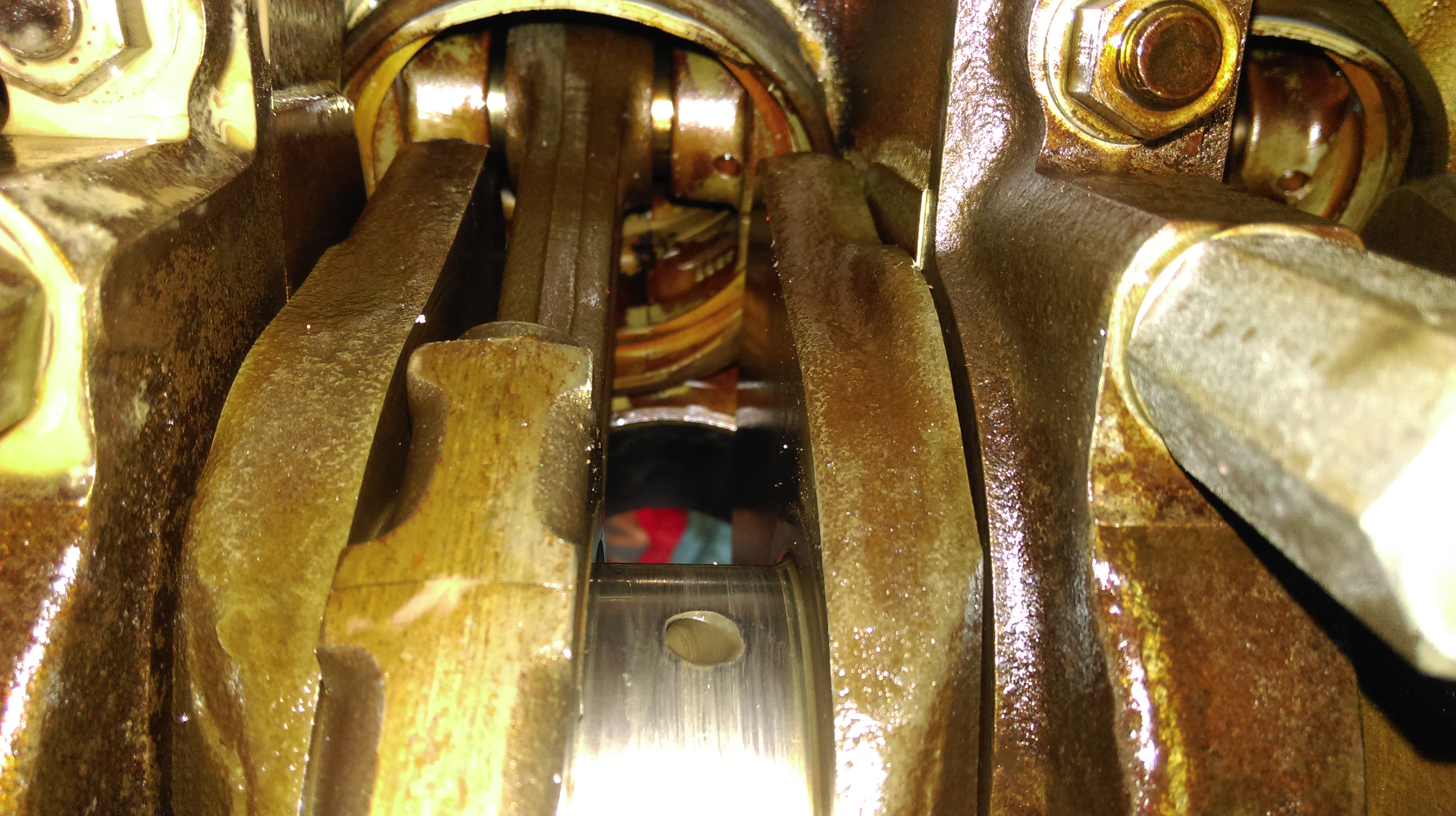

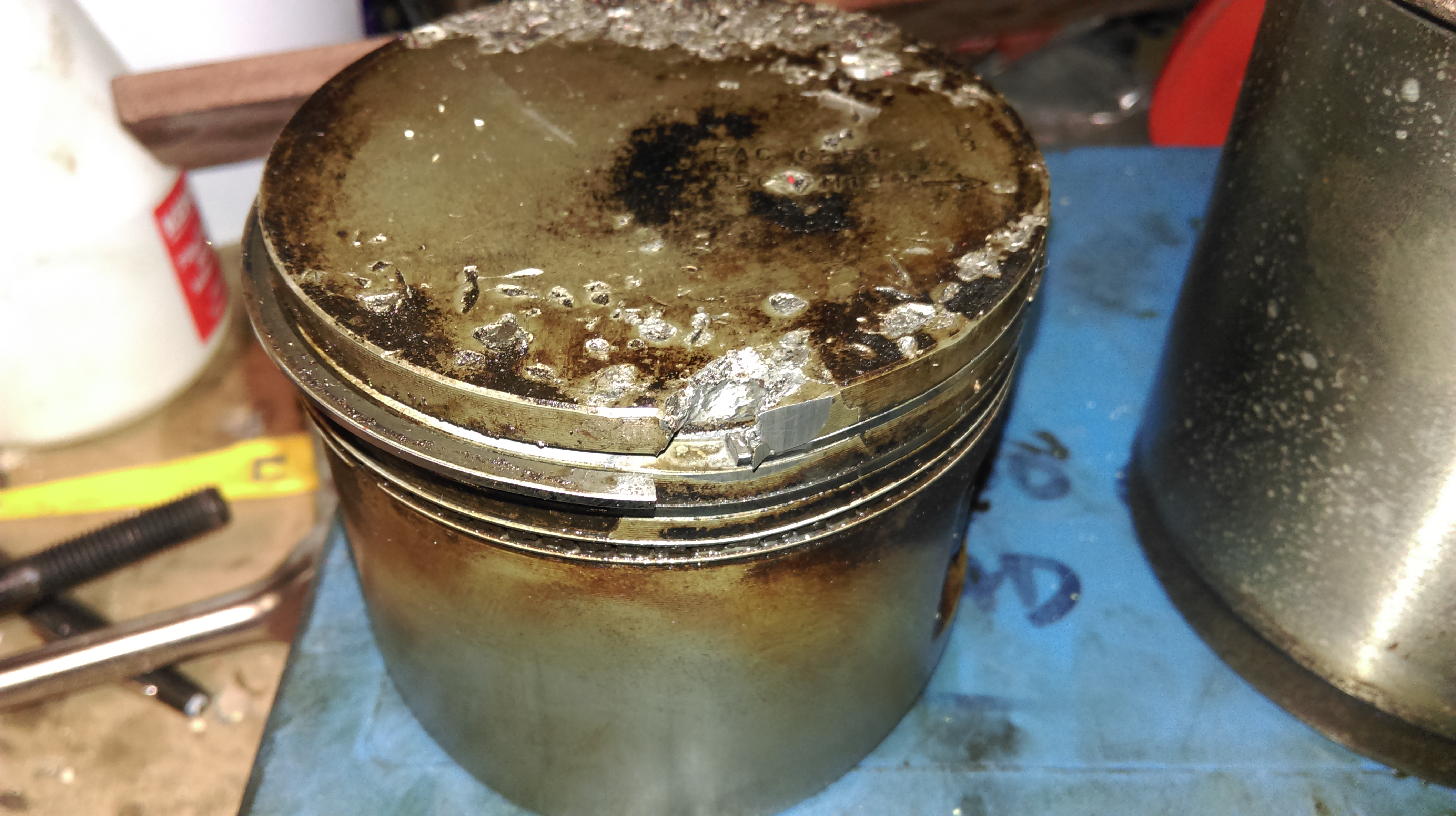

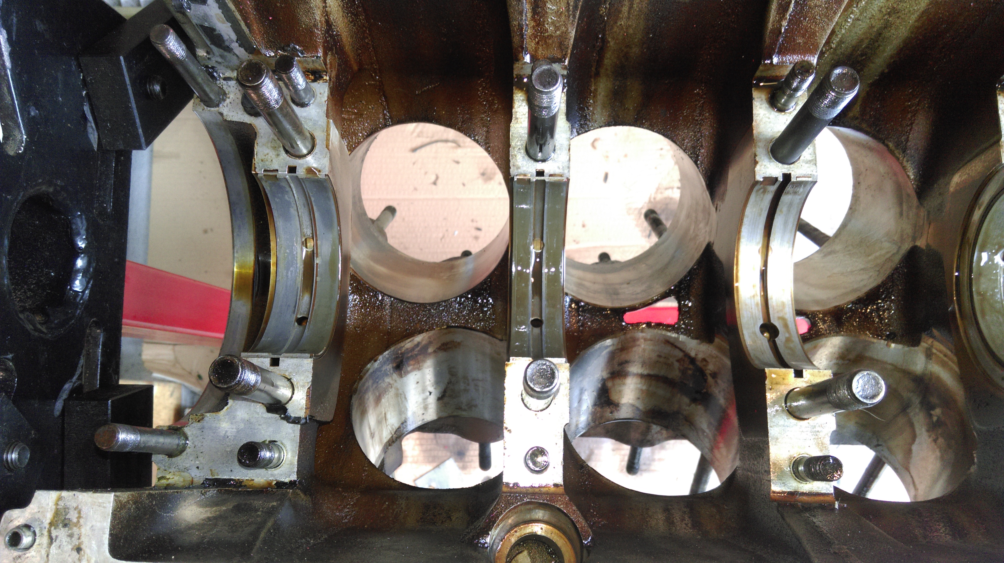

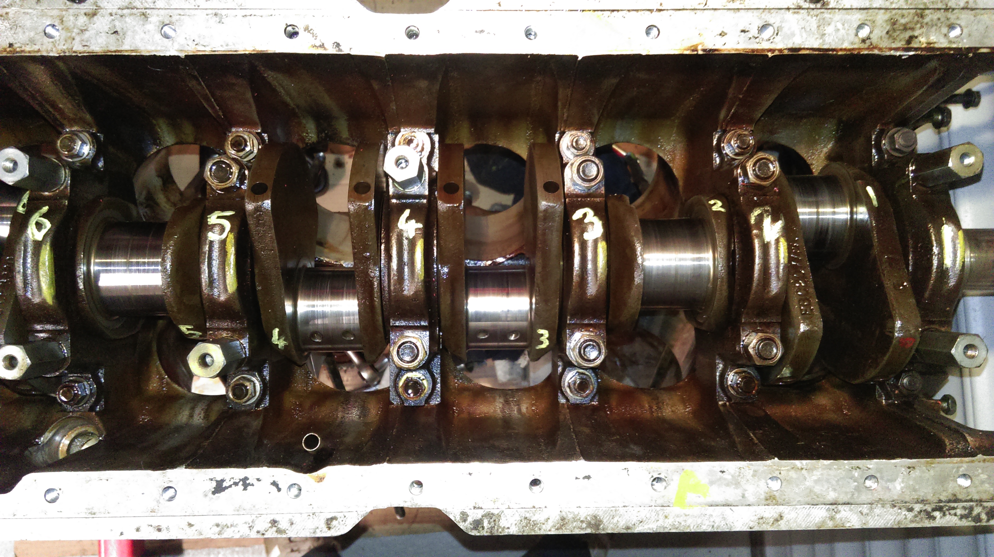

Its been many moons since my last post, just though Id put an update on my post and say a couple of big thank you's. I have been unable to source a decent replacement lump so, for better or worse, I have decided to rebuild my engine. The heads came off without too much trauma, revealing the true horror beneath, pot four on bank B very poorly; piston totaled, liner cracked and head and valves decimated. I found bits of seat floating about in both intake manifolds, fortunately all is well in bank A, luckily no damage to the pistons. It was highly recommended to me to pull both heads, I would say it is essential, I have found particals of seat everywhere! stripping the bottom end, pot four con rod is still straight! crank has suffered, minor scoring on big end journals due to what looks like tiny bits of seat embedded in the bearing material, this will be re ground. Apart from the above the rest of the engine seems to be in fair nick, little wear, if any. Engine is now stripped to its bare bones and cleaning has begun in earnest! I have sourced two new heads(complete), piston and liner, making the rest up as I go, secondary water pump is a certainty. I would like to thank Chris (up the cov!) at CFS for finding my piston, Rodger bywater at AJ6 and Nigel Boycott for taking time to help a lowly amateur! their knowledge is astounding!! cheers lads. To everyone else, KEEP YOUR CAT COOL OR ELSE!!!
