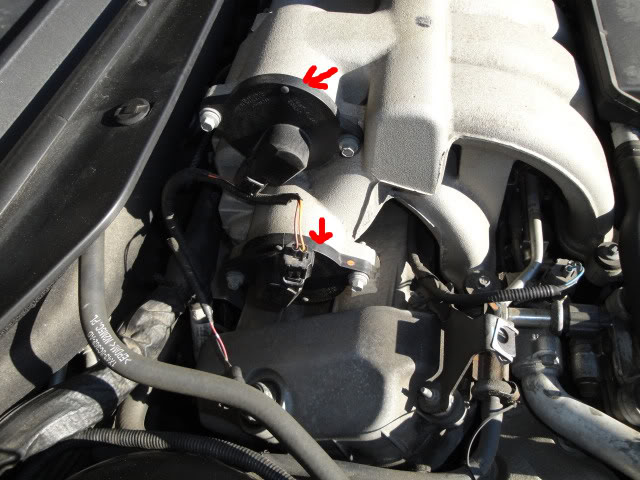

have you checked all these areas
you replaced the o rings below..what about the others

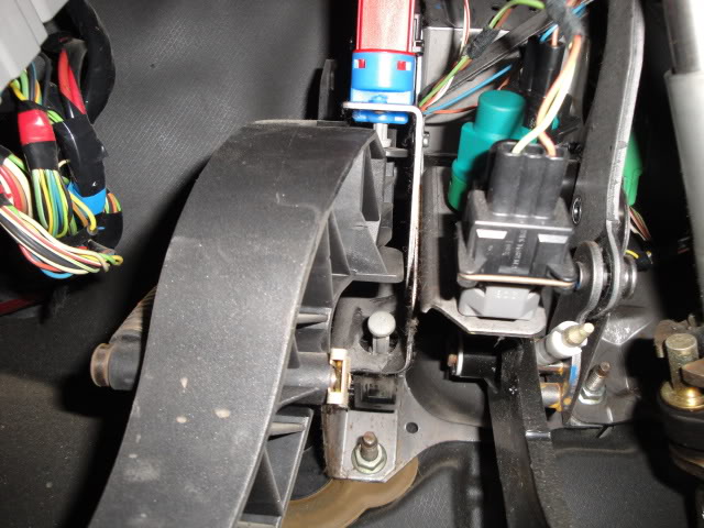

for the brake booster

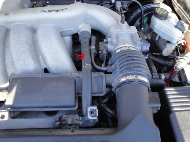

one of theses plugs maybe disconected
if you have checked all these for vac leak

If anyone could help I would greatly appricate it. I pulled the info above from another forum. I am planning to spray carb cleaner on the part in the first pic to see any change in idle. Any other ideas to please let me knnow asap.
