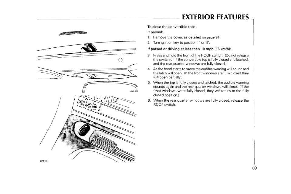

I just bought my first Jaguar XK8 convertible. I'ts a 1997 and I love it. The car did not come with an owners manual and it's making me feel like a dummy.... Can anyone tell me how to roll the quarter windows up? Also I can't get the tail lights to work. I grounded them like i saw in a post and it didn't work. Both fuses have power but no power to tail lights. I have brake lights, turn signals and tag lights.

The rear quarters should close as part of the top closure sequence. Here are the pages from the Driver's Handbook on opening and closing the top:
(click on the images to enlarge them)
