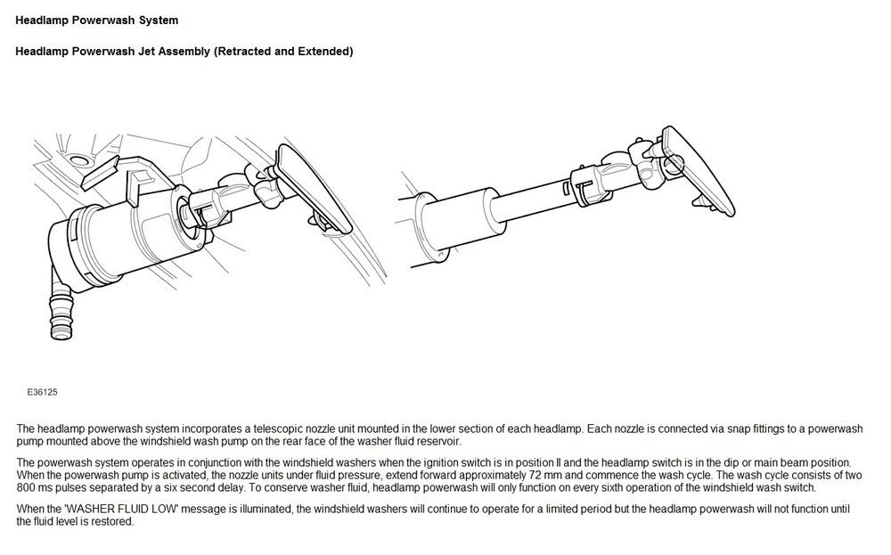

The Jaguar name for this part is the HEADLAMP POWERWASH and the chrome half moon shaped cover is a push fit on the end. This extract from JTIS (the Workshop Manual) shows the assembly:
It is secured to the headlamp with two plastic 'tangs' arrowed in this second diagram:
It's possible one or both of the tangs have been broken in the car wash incident .......
