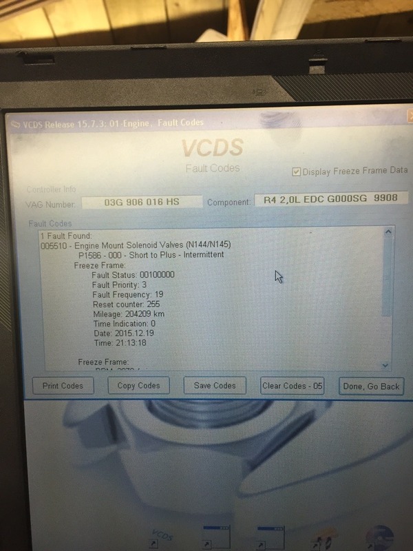

Had some word back as follows.......

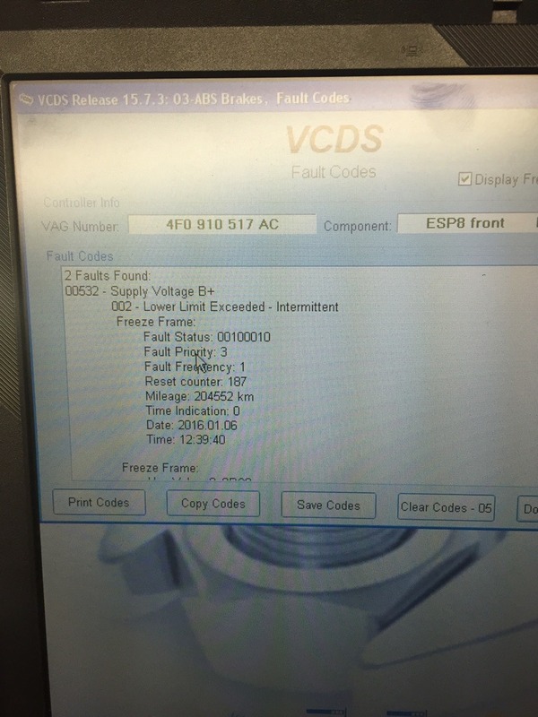

Some codes found as below, will need to check into, but for now......

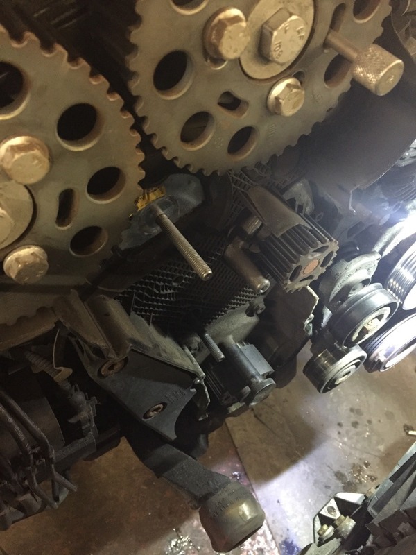

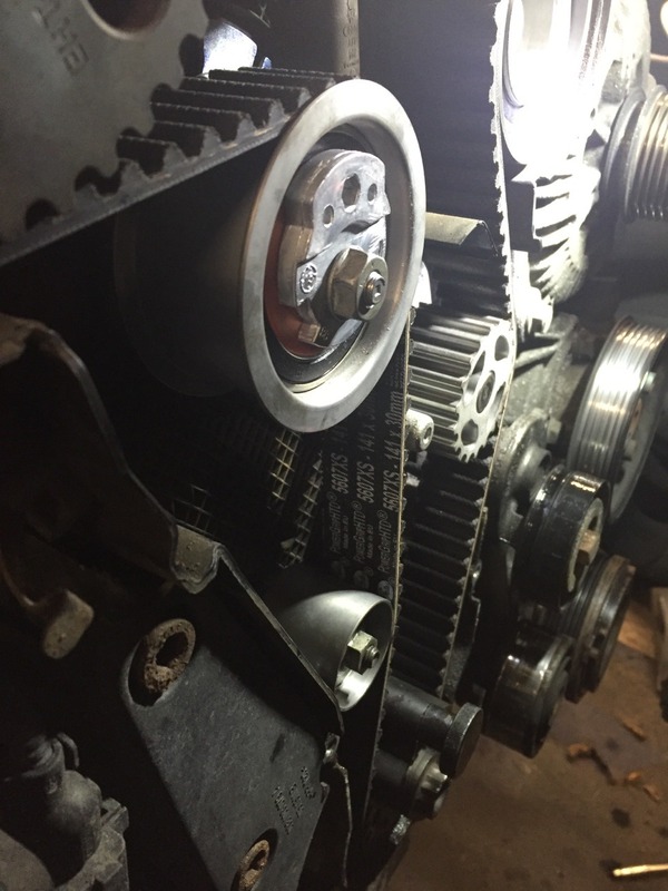

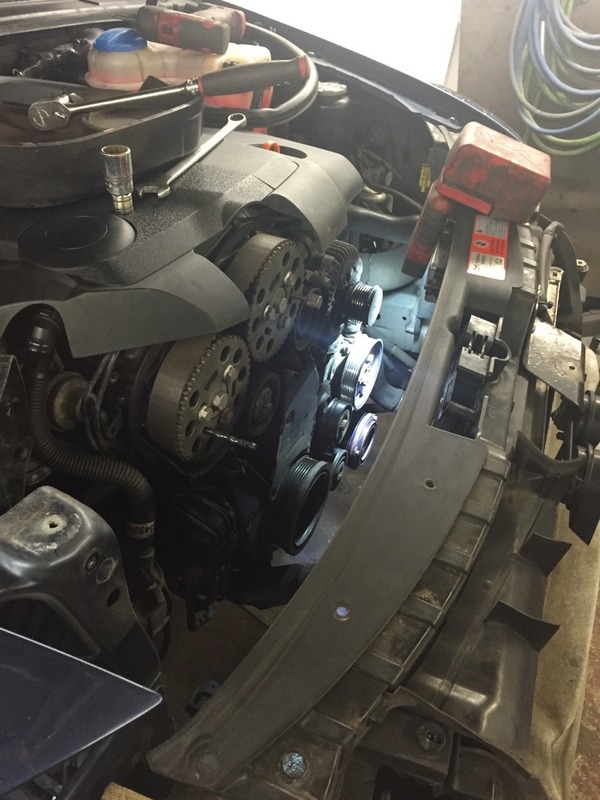

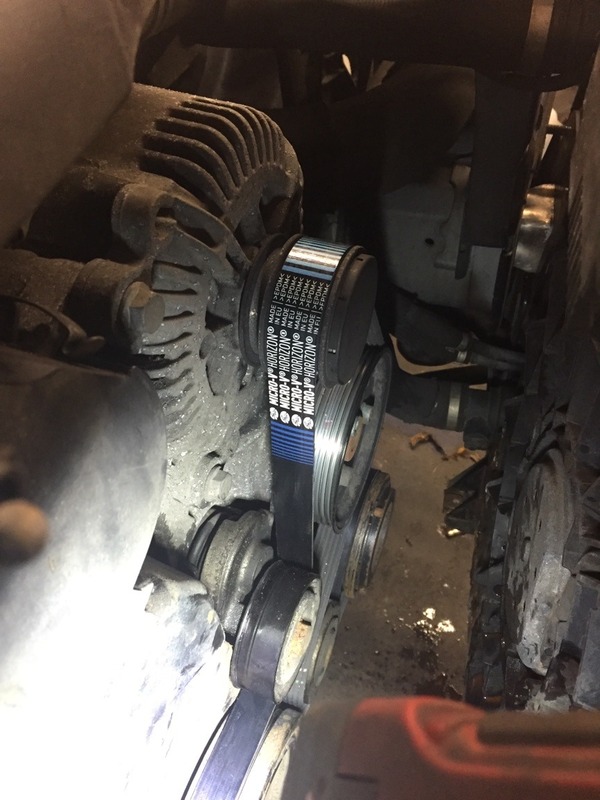

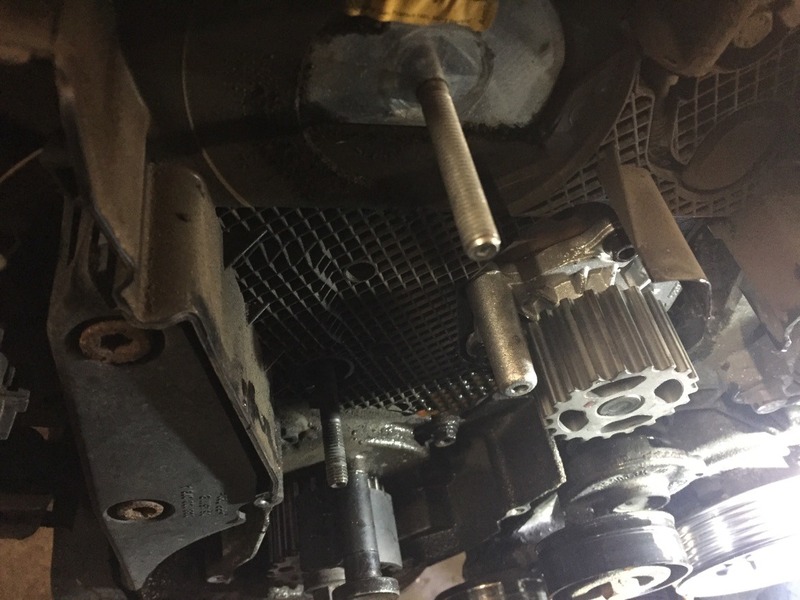

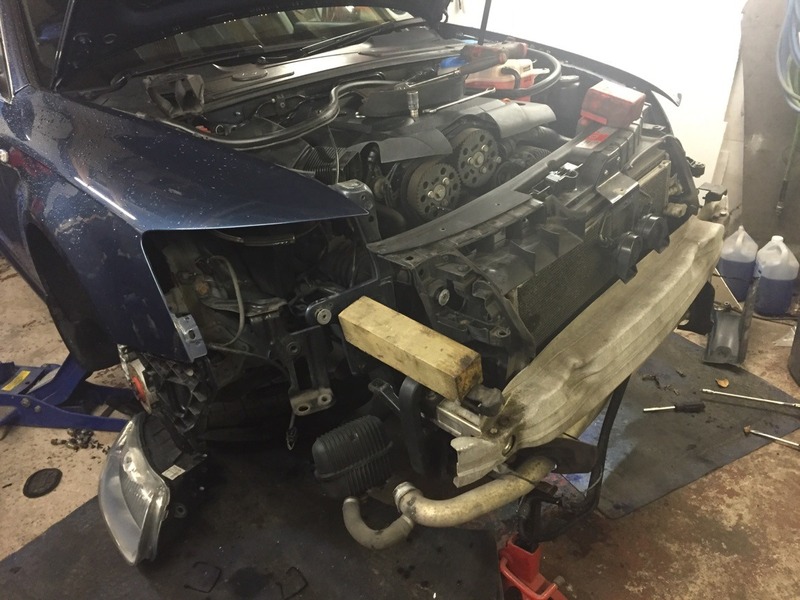

Timing belt, water pump and aux belt all done A ok......

Bear in mind, I've went through around 3 batteries from new on this car, they eat them up, or at least mine does....lol
I advised my wife ( why bother?? ) around 3 months or so ago as we approached winter that it may be prudent to check / replace the battery, I distinctly remember one day she was leaving and I heard her struggle more than usual to start and we had that discussion!
Well, we all know that these cars ( The Jag seems to be the same ) do not do well with weak or failing batteries..........they can and do cause many spurious / silly / intermittent faults / issues.
Tech advised that the battery was only holding up to around 55% of charge and this may be the issue with the epb, very possible
Now looking at a replacement battery
Will also look into the engine mounts too.....
Job done in good time too and all for £275...........nice one, coulda been a lot worse

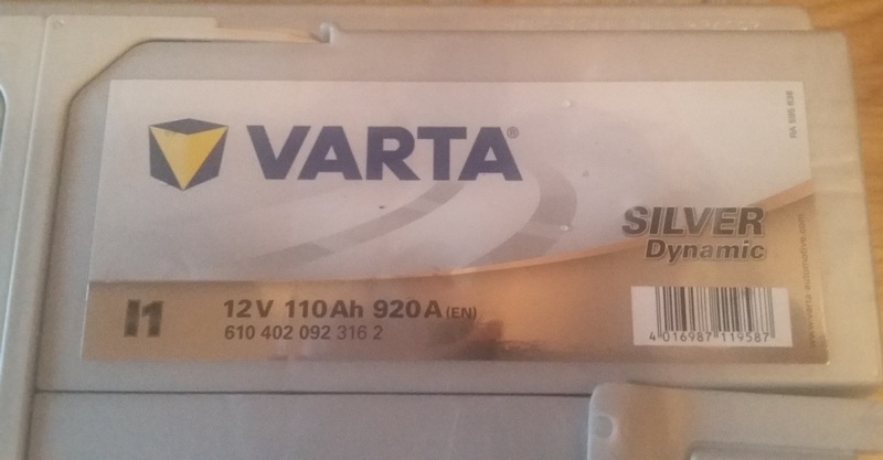

Old Jan 12, 2016 | 07:33 AM

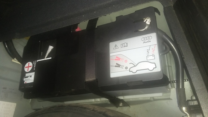

Ok so here's whats in my boot currently, genuine Audi battery ( Varta can be seen on it )
110AH 850 CCA
Its a big bugger at I'm sure 393mm x 190mm x 175mm

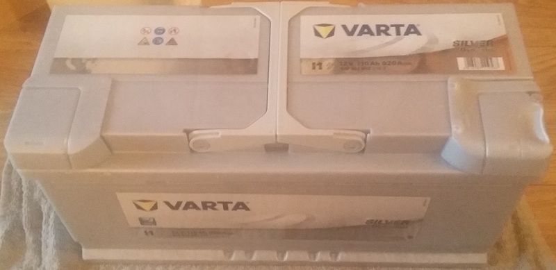

Here's what I'm replacing it with......
Its made by Varta and has the same dimensions
It's specifically for Audi, BMW, Range Rover, Jaguar and other high end premium cars
I've opted for 110AH but a slightly increased CCA ( Cold Cranking Amps ) at 920
Having checked extensively I came across pricing from £140 up to around £190 from Audi but found this one on Ebay through a company called Batterybay
It has a 5 year warranty with it and cost £98.50
Should be fitted tomorrow
