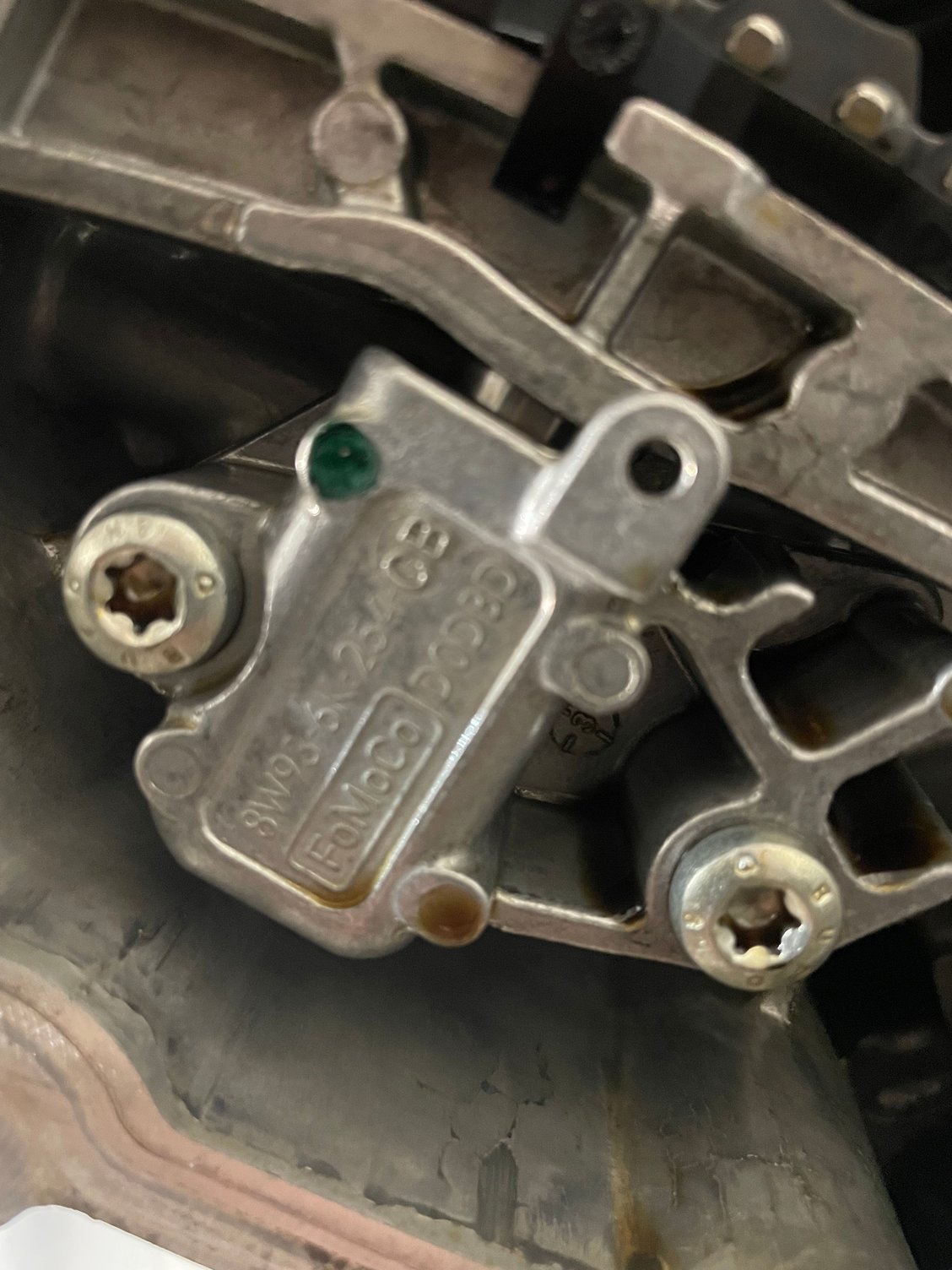

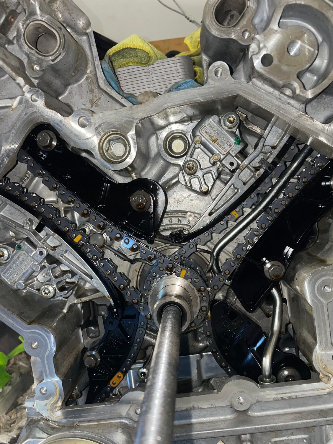

Since the engine is already out, should the timing chains, guides, and tensioners be replaced as preventive maintenance? Is it possible to judge their condition from visual inspection or pictures, and does this year use the updated timing components?
I’ll attach pictures. Any recommendations are appreciated.
The history of the engine is unknown, and it is possible the timing components has been already replaced.

The engine from a MY2014 should already have the updated timing chains and tensioners. Inspect the area at the point of contact between the hydraulic tensioner and the tensioner blade for wear or deformed surface.

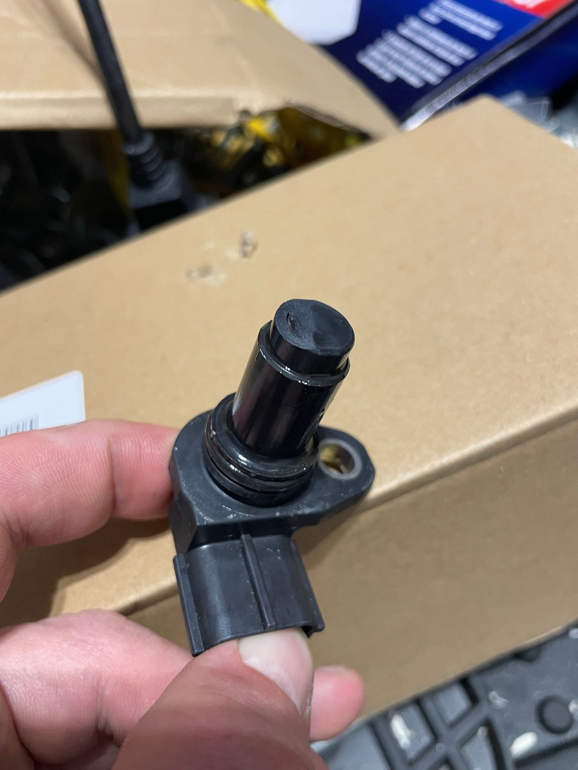

Here is another interesting finding.. was swapping sensors and found a cam position sensor with a slightly deformed tip (photo attached). Timing and chains look OK.
Could a front-end collision realistically cause cam/phaser movement enough to touch the sensor? Any ideas what that could be?
