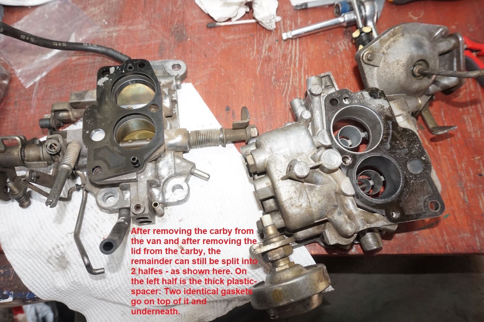

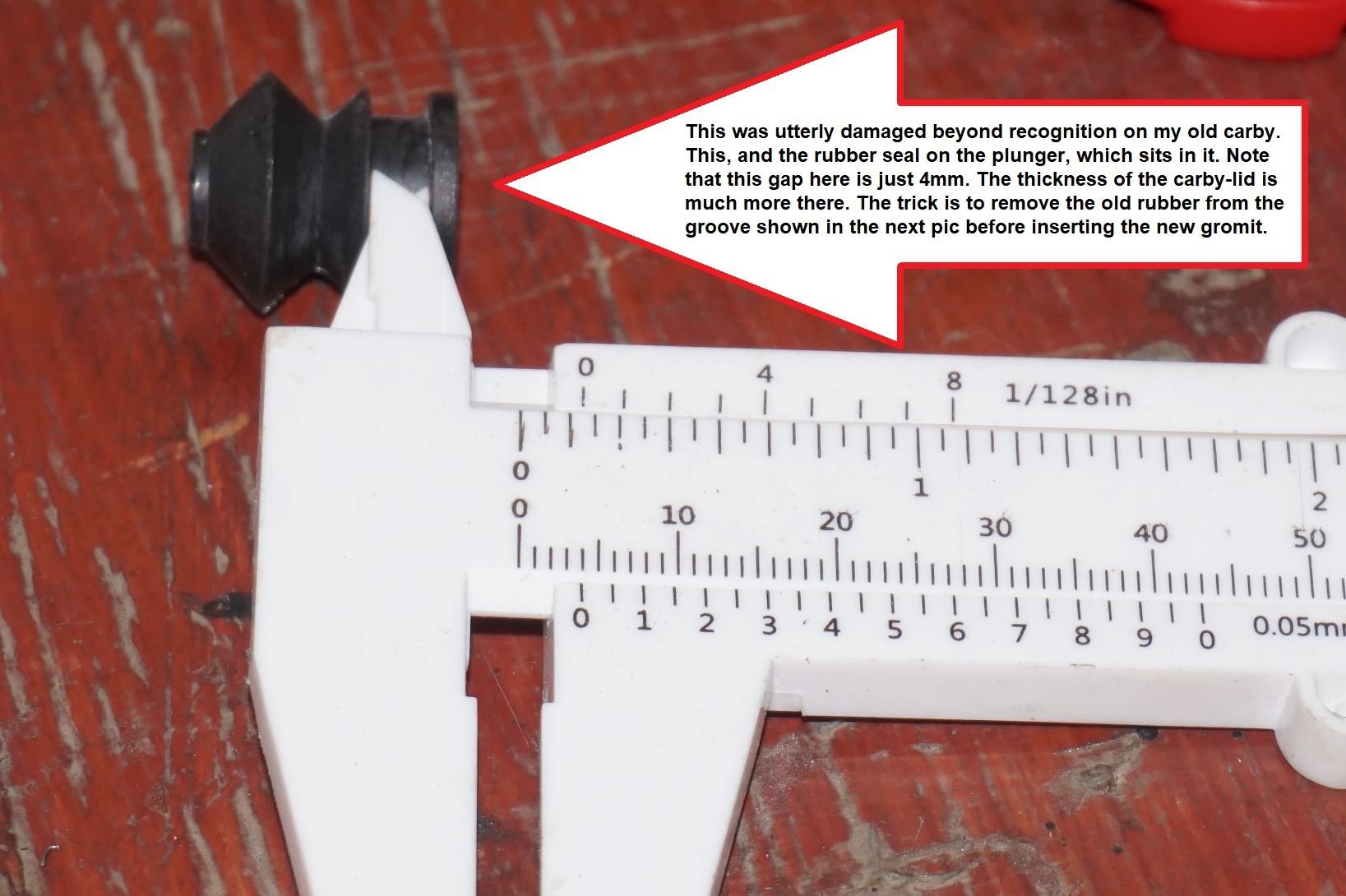

I ordered a gasket kit - the culprit were the rubber seals of that pin coming out of the fuel reservoir in the carby.
I put the carby back together again.
Btw.: Like always it helped A LOT to take a lot of pictures while taking the carby apart - I looked a lot at those pics, where putting the carby back together again...
I tried, if the car runs again with the connection to the air-filter not back in place.
Petrol was leaking big time - just coming out of the top of the carby - BUT: I realized that this was not the old leak - I fixed the old leak with those 2 rubber seals.
I quickly realized that the new cause of the petrol leak is now that the spring, which sits in the hinge of the swimmer (in the fuel reservoir) is somehow suddenly too strong and it stops the swimmer from coming up and closing the needle-valve... I tried to insert the conical shaped spring both ways. Still overflowing petrol. I then opened the carby for the third time and removed that spring. That solved the issue. All good now....

That's the needle valve. I swapped that, too. As you can see the mini-filter on the old one had dissolved already.
That rubber part (grommet), and the one attached to the plunger going thru this grommet were the reason for the initial petrol leak.
This is the groove in which the lower part of the grommet sits.
That the nasty spring, which caused the fixed carby to overflow..., as it pressed down the swimmer despite the fact that the fuel reservoir was full, so that the needle valve did not close....
