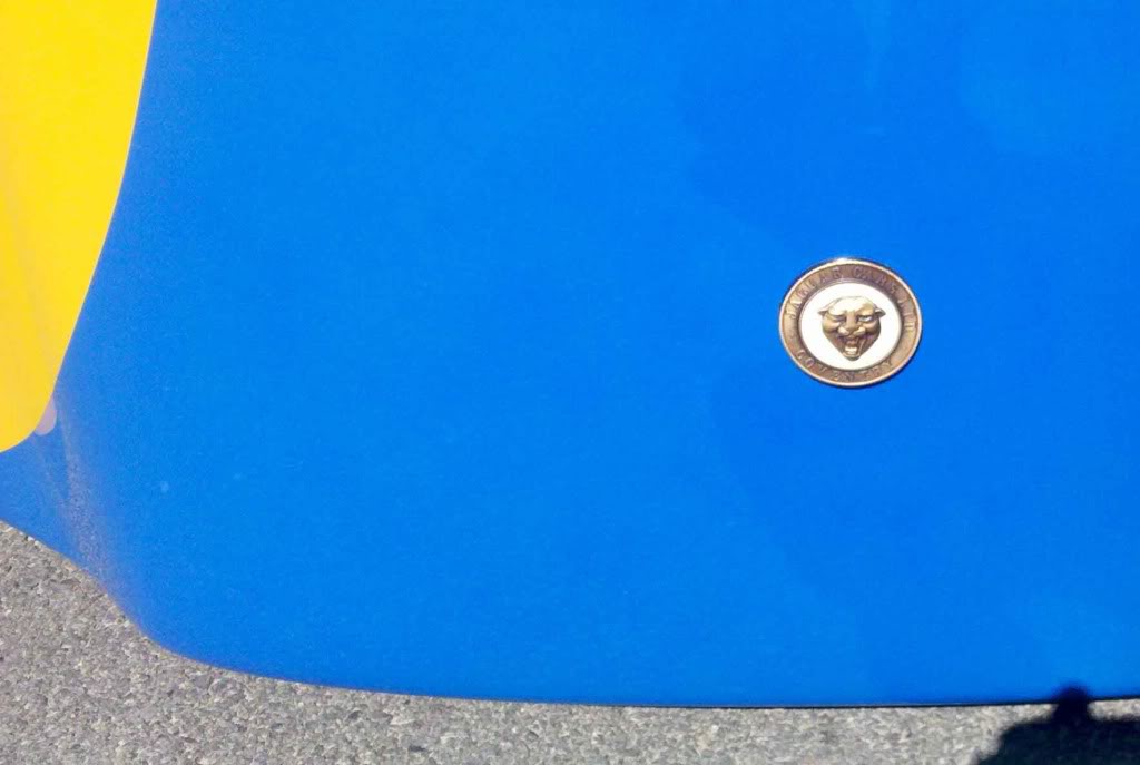

Yup, that was a stunning car. Even the exhaust wrap was incredible. However, the Jaguar badge on the hood ruins the aerodynamics.

Beautiful car - incredible workmanship. Not to be a wet-blanket, but this is not a replica Jaguar Lister - it's a replica Lister Chevrolet. Jaguar did not either design or manufacture the Lister - the Lister sports racers were totally the product of Brian Lister, proprietor of George Lister & Sons, a British engineering company. The subject car here looks like a replica of the "pre-Knobbly(?)" Lister (which ran various Jaguar and Chevrolet engines), in this case running a Corvette engine. Ergo Lister Chevrolet. It is of course the right of the creator to badge/identify the car whatever way he chooses, but I do not see an ounce of Jaguar in the car (except for the badging). That is not to detract in any way from the quality of the replica - it just does not replicate what it seems to claim to do so. It REALLY needs a Lister badge on the bonnet:

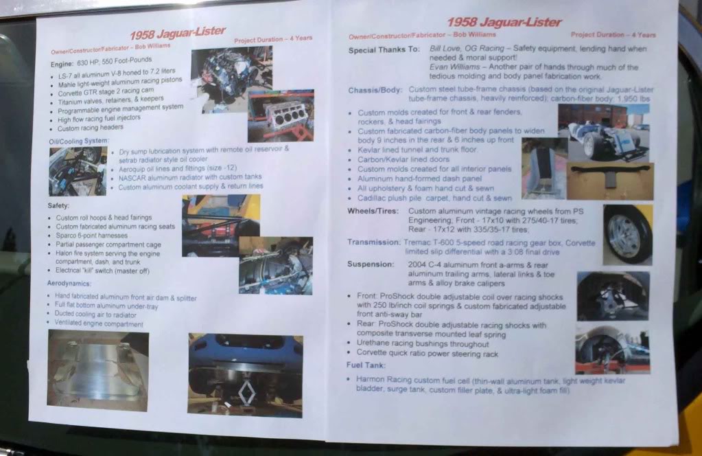

From the builder's write-up, those are custom wheels from PS Engineering. The one period-correct item I spotted on the car are the tail-lights (very familiar to us old farts).

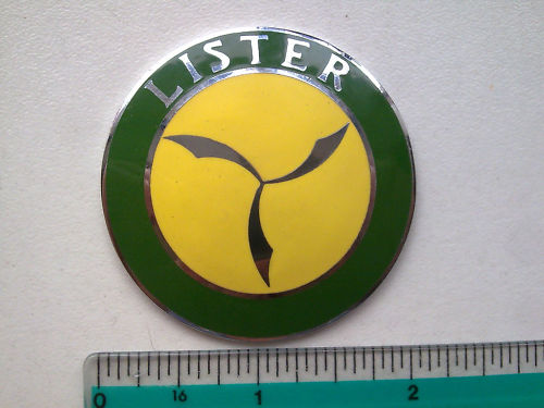

I agree with SCMike, it should sport a badge like this...

SCMike is correct. the car really is a recreation/interpretation (i try not to use "replica" because it is not a very good replica) of a Lister. Since i selected GM power over Jaguar power it is more closely representative of a Lister-chevy and should not be displaying the Jaguar badges (so probably does not really belong on this site).
Because of Listers close relationship with Jaguar and mostly because i just really like the growling cat so much more than the Lister badge, I put the Jaguar badge on the car. It is not intended to offend and I do not represent it other that what it is...my home-built attempt to re-create a very cool and unusual ride from the late 50's (the sheets on the windshield call out Jaguar because the schools mascot is the Jaguar and i thought the students would get a kick out of that - they did!).
There are a few ounces (very few) of Jaguar in the car...the rear view mirror, side mirrors, Lucas tail lights, and Lucas head lights were sourced from the Jaguar catalog of two large British car parts supply retailers (I am pretty sure the parts are all reproductions but..that was the best i could get). Sadly, that is about it.
It is not a beck or a dragon or a kit. I sourced the chassis and a body from Lucra Cars (their version is based on a modified Beck version) and have extensively revised, modified and reconfigured the frame and body (including creating new quarter panels, fenders, rockers, and head fairings) such that it bears little resemblance to the Lucra version.
The entire interior, aerodynamics, ductwork, sheet metal, sway bar, and the brackets, bezels, trim rings, frames, etc are my own design which i fabricated in my garage (I do have lathes and a mill and a few other items that help out quite a bit!!). The interior panels are either composite construction from molds or hand formed aluminum panels. I also learned how to use the wife's sewing machine and designed and sewed all of the upholstery on the interior panels including the seats (so, please don't look too closely at the interior as i am much better with a lathe and mill than i am with a sewing machine!).
