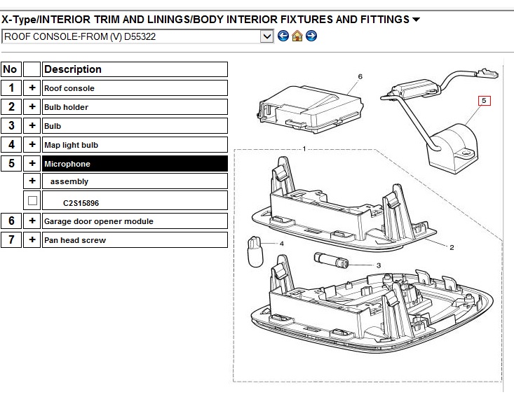

I've just installed a jaguar Satnav system and my bluetooth is now working except I do not have a roof mic and on looking inside my roof light console I can not see where to connect one to, do I need a different roof light console too?
If so has anyone got one for sale?
Old Oct 15, 2013 | 01:43 PM
Good to hear you've made progress.
According to the Parts Catalogue, the same Roof Console is used in all but the Microphone (item 5) is a separate component:
WANTED : Jaguar x type phone bluetooth interface-x-type-microphone.jpg
The harness connector is most likely tucked away in the headlining.

Thanks for that graham, I've now found the mic connection in my headliner, just need a mic now
