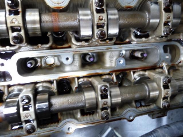

There are 2 spots that need a 1/2" dab of silicone, where the head meets the timing chain cover and after looking at the pic again 4 spots at the rear of the cover, LOOK very closly at the pic.
No you do not silicone the entire gasket.
Oh I guess I did not remove the spark plugs at that time.

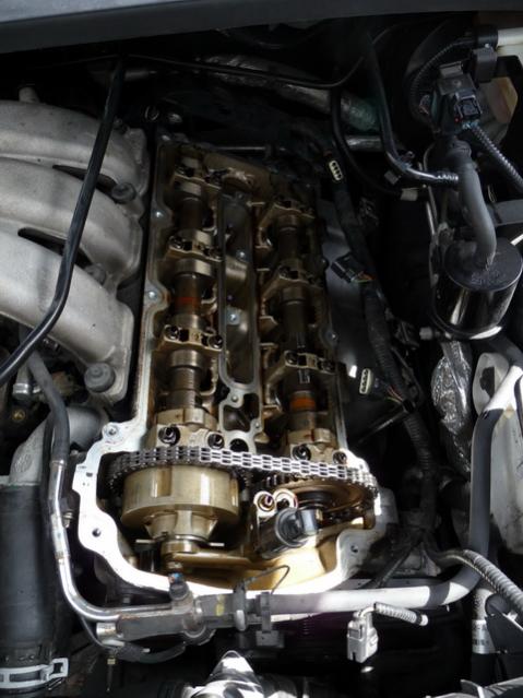

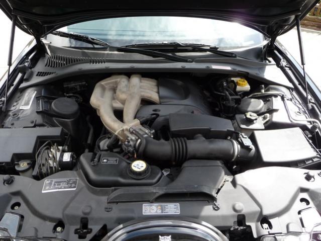

Completed!!!
Changed both Valve Cover Gasket and Spark Plug Gasket.
I tried to save plastic clips but I broke two off. I replaced with cable-tie for now. Other than that, the work wasn't too hard. I managed to drop the screws and I had to remove the bottom cover (unnessary work) to retreive them.
Thank you, everyone who helped me!!! Especially Rick!!!!!
