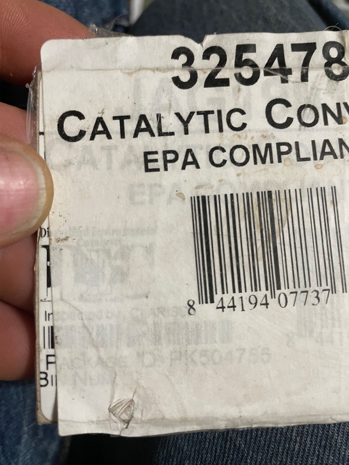

I replace my head pipes off my exhaust manifold and Taylor converters because of a crappy weld job than before I got the car. I replace them with a set of pacesetter EPA compliant Cadillac converters for rock auto part numbers 325477 and 325478. Ever since I install them I’ve been getting a intermittent recurring cat efficiency code P0420 and PO 430 great fix a bunch of vacuum leaks using my smoke tester and I’ve got most if not all of what I can see taken care of, but I’m still getting the intermittent codes for cat efficiency . I took some videos of some live monitoring data using SDD and when I compare thee censor to output to the Jag technical manual, it shows I have 40 cats. What do you think?

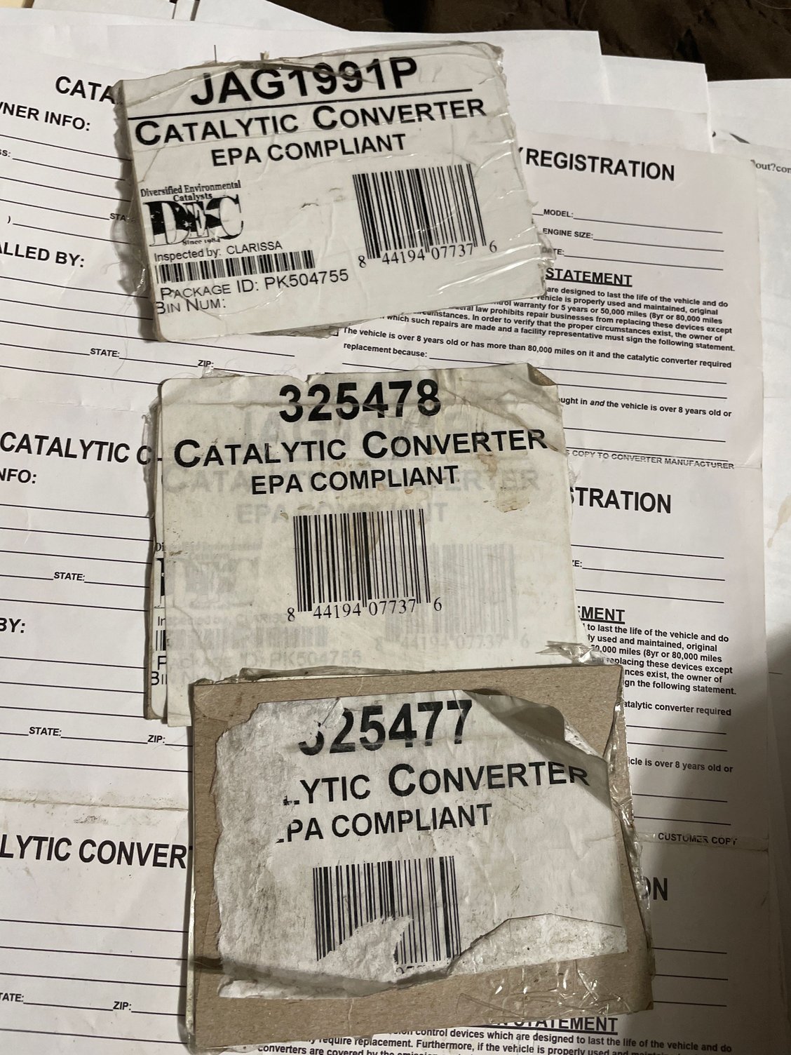

interesting to note is that the label that was on the pipes and cat converters when I receive them from Rock Auto had pacesetter part numbers and UPC codes stuck on the label. That label was stuck on top of another label with the part number from a company called DEC or diversified environmental catalyst. . Both UPC codes were identical, so I’m going to guess that these pacesetters are made by DEC

you put 48 state converters in the car and now it still has a 420 430
answered your own question

I believe what Xalty is referring to is that unlike larger manufacturers who make a 48 state compliant model and a special model for the loftier emissions requirements of the PDRK (People's Democratic Republic of Kalifornia), Jaguar produced all their S-types being built to that standard. Look under the hood (or bonnet) and you will see an information sticker proclaiming this compliance. My S-type, originally sold in Savannah, GA, bears this...
A merely EPA compliant catalyst may not be effective enough to make your Jaguar's engine management system happy.

ahhhhh, that makes sense. Well the part was guaranteed to work so if I was mislead maybe theyll warranty it for me. Their website says it should work as long as my california car isn’t registered in CA and I live in AR

Aaracuda: You are going to find that CARB compliant catalysts are substantially more expensive than basic EPA certified catalysts... Good luck!!
